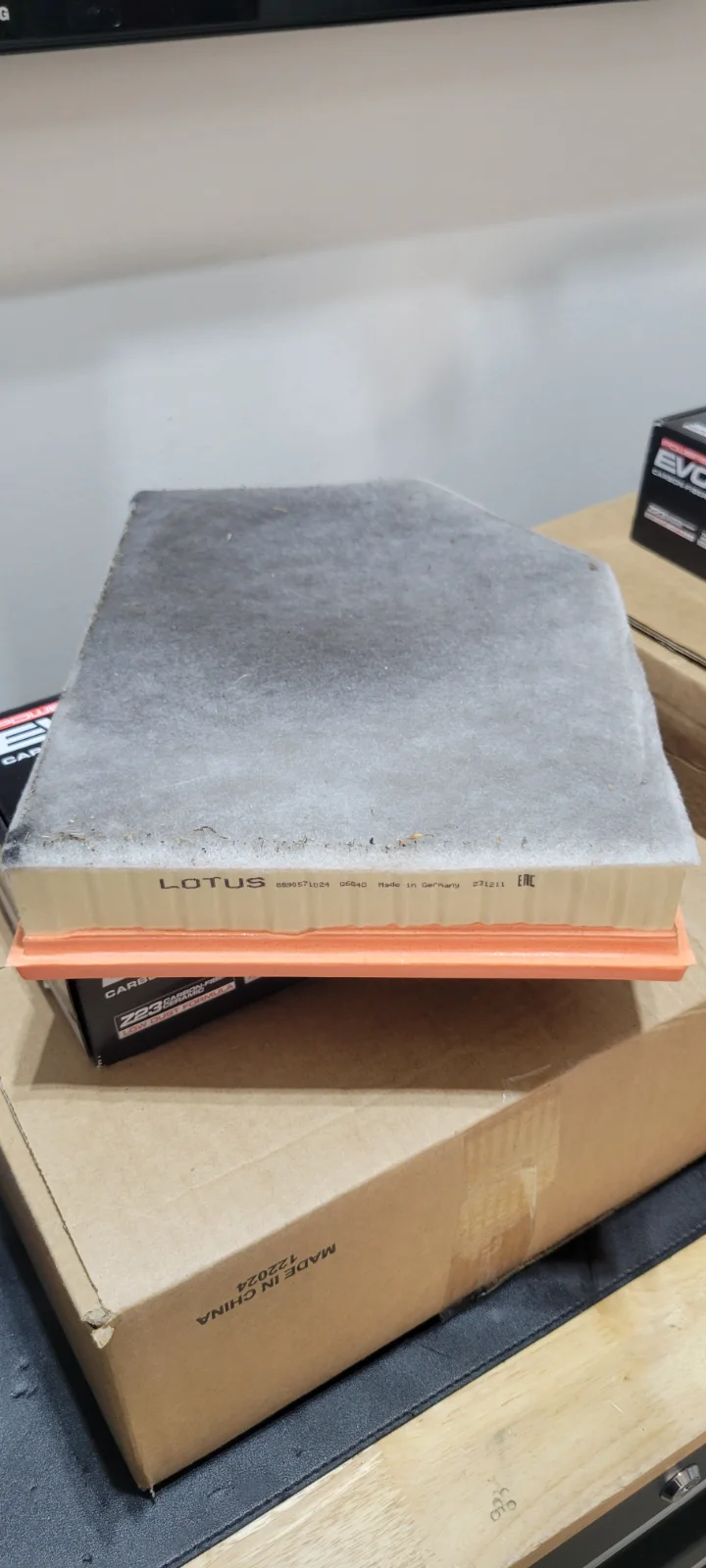

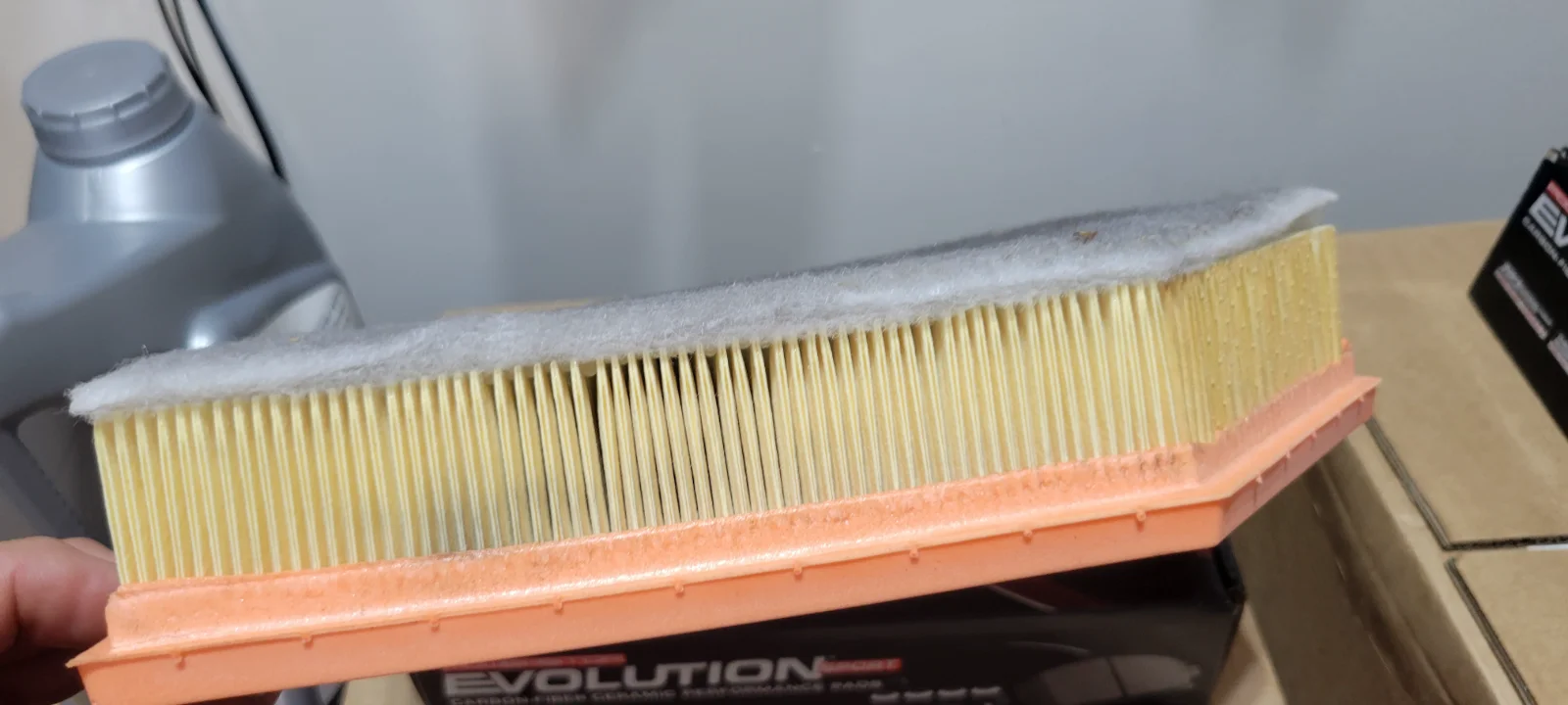

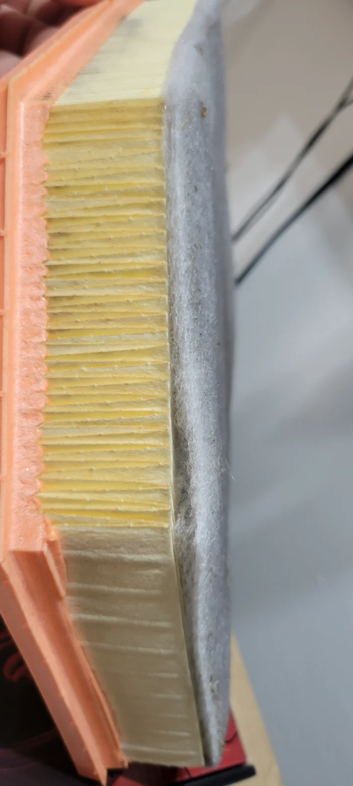

I received my GRP blue high flow air filter today and went right to installing it -- very straigh forward install, remove the engine covers, coolant sensor, MAF sensor, loosen two intake clamps and set the big hose aside -- then remove 3 small torx screws across the top of the airbox which allows access to the filter. The part I wasn't aware of was the pre-filter installed on the OEM filter - mine has 4,000 miles on it. I wonder if it's to prevent water intrusion to the paper?
The GRP does not have a pre-filter (which I'm good with with). Started but haven't driven the car yet, no CEL, etc. -- I also have the 3rd cat delete, GRP short shift, and MVC......soon a tuner once we figure out which is right!

I also installed a nylon mesh pre-filter... cut to fit and glued on... Not sure it does much TBH

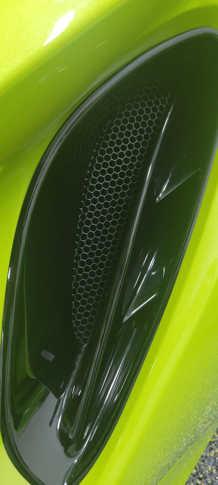

I'm wondering -- I see the newer Emira's have an intake screen whereas the 2024 models do not (it's an open hole to the intake tube). Is just the screen an option? Was this a design flaw Lotus corrected? Is mine simply missing??!

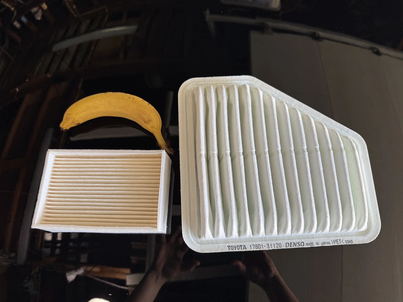

I just bought an air filter at local Lotus dealer, and they sold me a Toyota part number (for 4x the Toyota price) without any kind of pre-filter.
Edit:
This is an Evora engine and cabin filter! The dealer made a mistake, don't buy these.
Yes, it's for a V6
Toyota Part # 17801-31120
Very expensive piece of paper :) The cabin filter is also $50 (with banana for scale). It's tiny.
whao!! thanks for sharing. that's such an interesting toyota looking filter! Found online
As an eBay Associate we earn from qualifying purchases.
Thank you!
Do you have a part number for the cabin filter - i presume that is not Toyota?
The cabin air filter is Lotus specific, part A132P0156F.
They charged me $49.80 for the cabin air filter, and $92.55 for the Toyota air filter.
