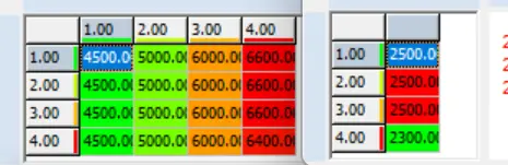

Regarding Rev limits -
Pretty standard stuff, just like the Evora.
With the exception being that on the Emira the rev limits are *lower* than the Evora for certain temperatures.
There is also an additional - Limp mode restricted power rev limit which isn't on the Evora.

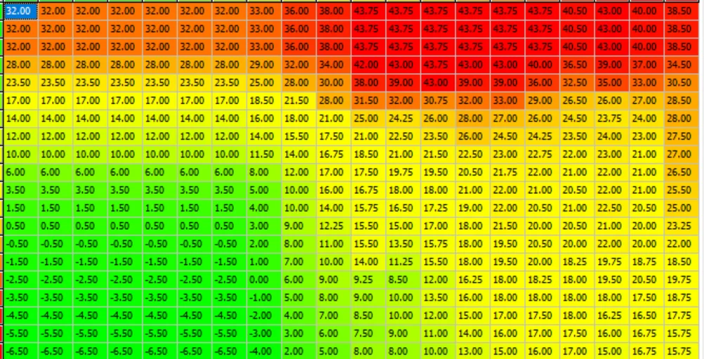

Regarding Ignition. The Emira looks to run slightly *less* ignition than that of the Evora GT. Similar to the Evora, the Emira has both MT and AT version tables with code switches within the same calibration.

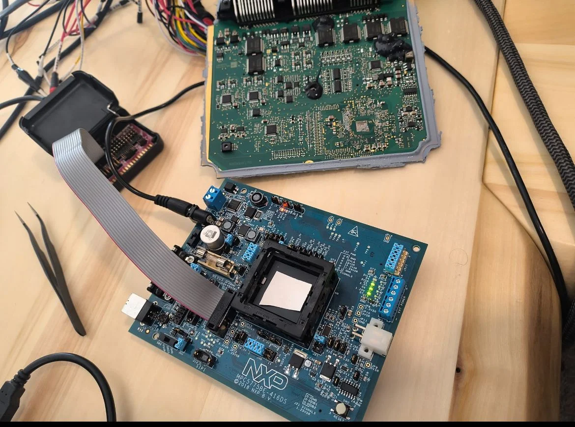

There are many ways to do it.
on the Emira ECU, there are NBD/JTAG pins, however the PCB must be reversed to find them.
so we killed 2 birds with 1 stone by deballing the chip, putting it on our Dev board, and now we can reverse all pins on the PCB
Whoa that’s pretty cool. Is it assumed all processors have jtag traces and you just have to find the trace?
Also how do you get past encryption of the jtag interface. I assume this is the trade secret part lol
