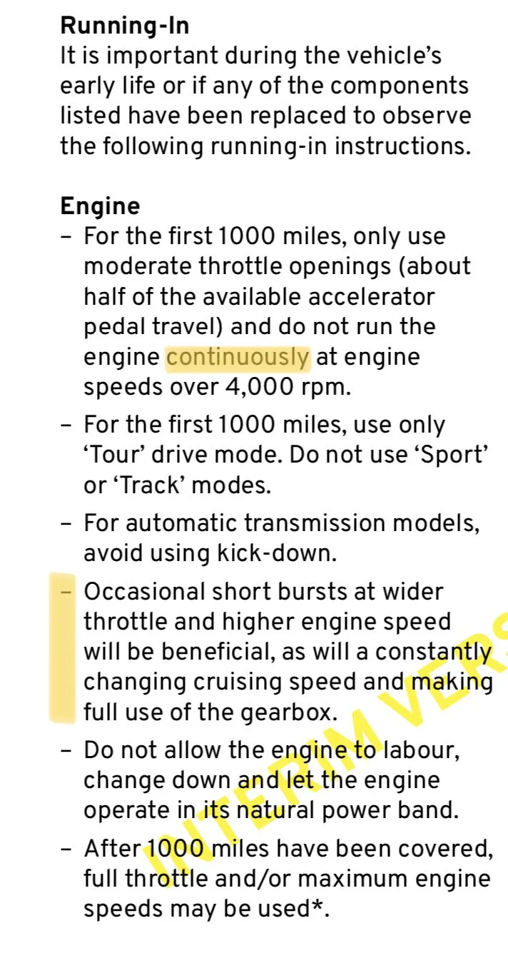

I‘m not advocating thrashing the car in the first 1000 miles, and I intend to abide by what the owner’s manual indicates; however, it seems to me that the word “continuously” is being ignored, and people are concluding that engine speeds over 4000 RPM are verboten. This is not the case:
On the other hand, maybe it’s not possible to exceed 4000 RPM with only half throttle. Nevertheless I’ll argue that the “half throttle” stipulation is the more important one here.

Yep, this is exactly what I'm doing. It's a spirited break-in, but without thrashing it and without running at high rpm continuously.

Are you hitting redline at all before 1000? I've hit 5500 so far, currently 450 miles in

not hit redline nor more than maybe 4300 very occasionally

I don’t have my car yet, but there will be occasions (per the manual, “occasionally”) later in the break in period where I will consider paragraph 4 to be permission to hit redline from time to time. It seems to me that hitting 5500 occasionally at your current mileage is right on track.
Disclaimer: I’m not a mechanic. I’ve broken in a few airplane piston engines back in the day, and the procedure there is very, very different: the engine is to be run continuously at steady, high power settings for long periods of this time. The thing is, though: an aircraft piston engine gets broken in at settings most consistent with how it will be used operationally. So in that way, the idea is the same for an automobile engine: during break-in, the engine should be used as it will be after the break in period, but work your way up there gradually, and consider the 1000 miles to be a mini version of the engine’s operational life. Realistically, over 100,000 miles the amount of time the engine gets thrashed will be quite small. So scale that down for the first 1000 miles, work into things gradually, vary speeds and work the gearbox, and don’t venture over 4000 RPM too soon, too often, with too much depth on the accelerator pedal, or too early in the first 1000 🤷🏼‍♂️. Also: always have a bit of mechanical sympathy. Some people are just hard on equipment 😬.

Just follow the manual - 1k miles isn't that much, why second guess?
Any idea what the restriction to Tour mode is all about given that it is easy to control the rpm’s with a 6sp? Besides increasing idle by 200 rpm’s, how would Sport mode affect the break-in period?

Think about what a "tolerance" is. It's the difference, plus or minus, between blueprint spec and actual production parts. Because modern engines are built to higher tolerances, the parts are going to come into contact with each other much more than they used to. The enemy here is heat. Heat causes metal to expand, and that increases the amount of friction contact between moving parts.
A new engine/assembly is going to go through a 'wear-in' period which does exactly what that says. Moving parts that are in contact with another surface, which can be stationary (piston cylinder walls, etc) or moving (rods, bearings, gears, etc.), are literally going to be removing a small amount of surface contact material as they rub against one another. This applies to all moving parts in the car, not just the engine, but the critical areas are engine, trans and diff because those heat up considerably during operation. Heat causes metals to expand, which forces them into contact with each other even tighter.
The oil in those assemblies protects the components to a point, but there IS wear, hence the term 'wear-in'. The metal particulate that gets removing during that process gets in the oil, and this acts like an abrasive. This is fine during the wear-in period, because that's what's supposed to happen, but there's a point at which this particulate-infused oil can begin to cause wear that's not beneficial. This is why I ALWAYS replace the engine, trans and diff oil (usually at about the 500 mile mark on a new car), but in this case, I'll wait until the 1,000 mile mark. This removes all that abrasive particulate, and gives me clean oil in all those 3 assemblies that are now worn-in. Now you can go the recommended oil change intervals, although if you drive hard (especially track) you should change the oils more often, especially engine and diff. This is because extended hard driving greatly increases the heat, which increases the stress on the oils to try and protect the components. It's all about heat expansion and cool down.
A good wear-in procedure is to gradually accelerate to upper rev ranges, say 5,000-5,500 once in awhile, but not all the time and not at full throttle. Use the ranges of the components, including gear changes. Do all this in moderation while the assemblies are new and wearing in. Continuous operation above 4,000 rpm is going to create too much heat, which is probably the same reason they don't want you using sport or track mode during wear-in. Those modes are mapped for more aggressive performance (more fuel) which increases the heat. It's all about managing heat expansion and wear during the wear-in period.
