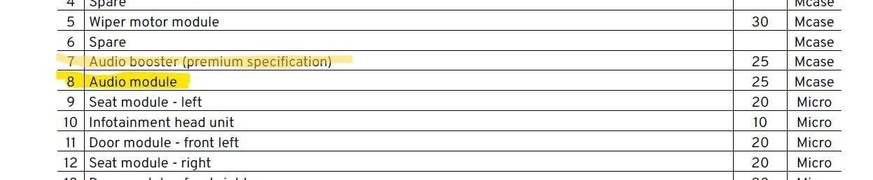

After digging through the Service Manual and Owners manual, there are a couple suspicious fuses that might be the culprit. If anyone has insight, please chime in. IN the passenger footwell fuse box, fuse 7&8 could be potentials (I'm speculating that #7 is the KEF amp since its designated "Premium" and "booster"). These fuses are 25A and are separate from the Infotainment fuse at #10.
Reactions: Kaz
I don't think there would be a separate fuse for the gateway module. It's very small and may just be a sensor of some sort that feeds the engine speed signal to the audio system.
The Audio Module is the main DSP processor and audio amplifier. The booster the secondary amp for the subwoofer.
It would be great to have the pin out of the main entertainment system, which I am guessing is what's generating the fake noise.

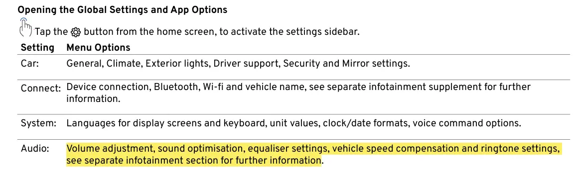

Maybe try these settings: sound optimization or speed compensation?
(I'm not aware of any fake engine noise however I have only driven in Tour mode)
The only adjustment we have on I4 is "Speed Compensation" to make the overall volume louder as speed increases.
