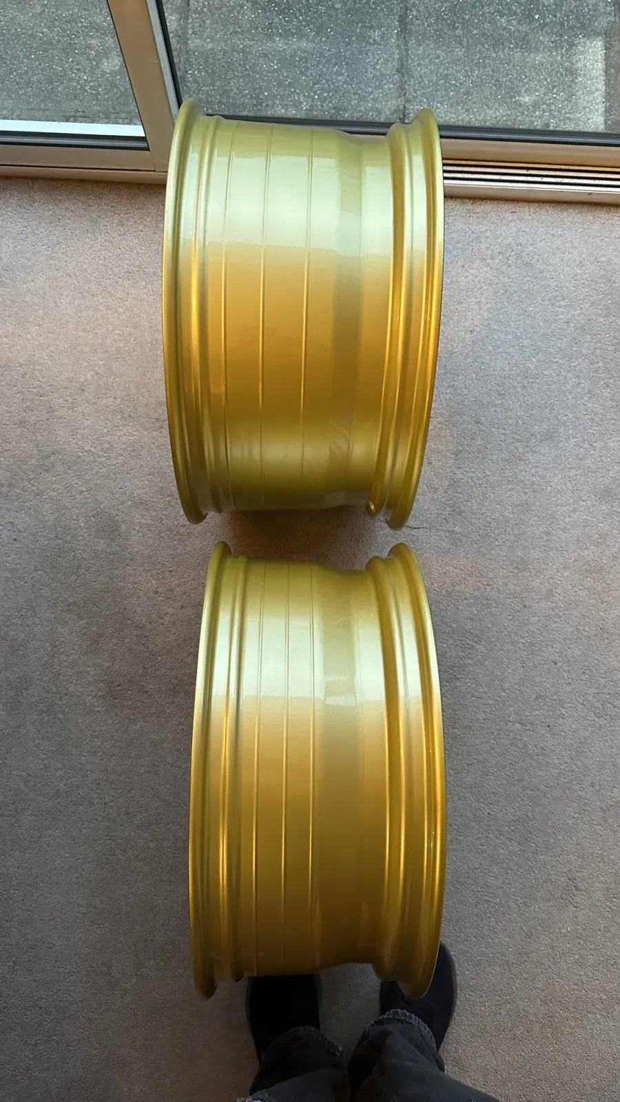

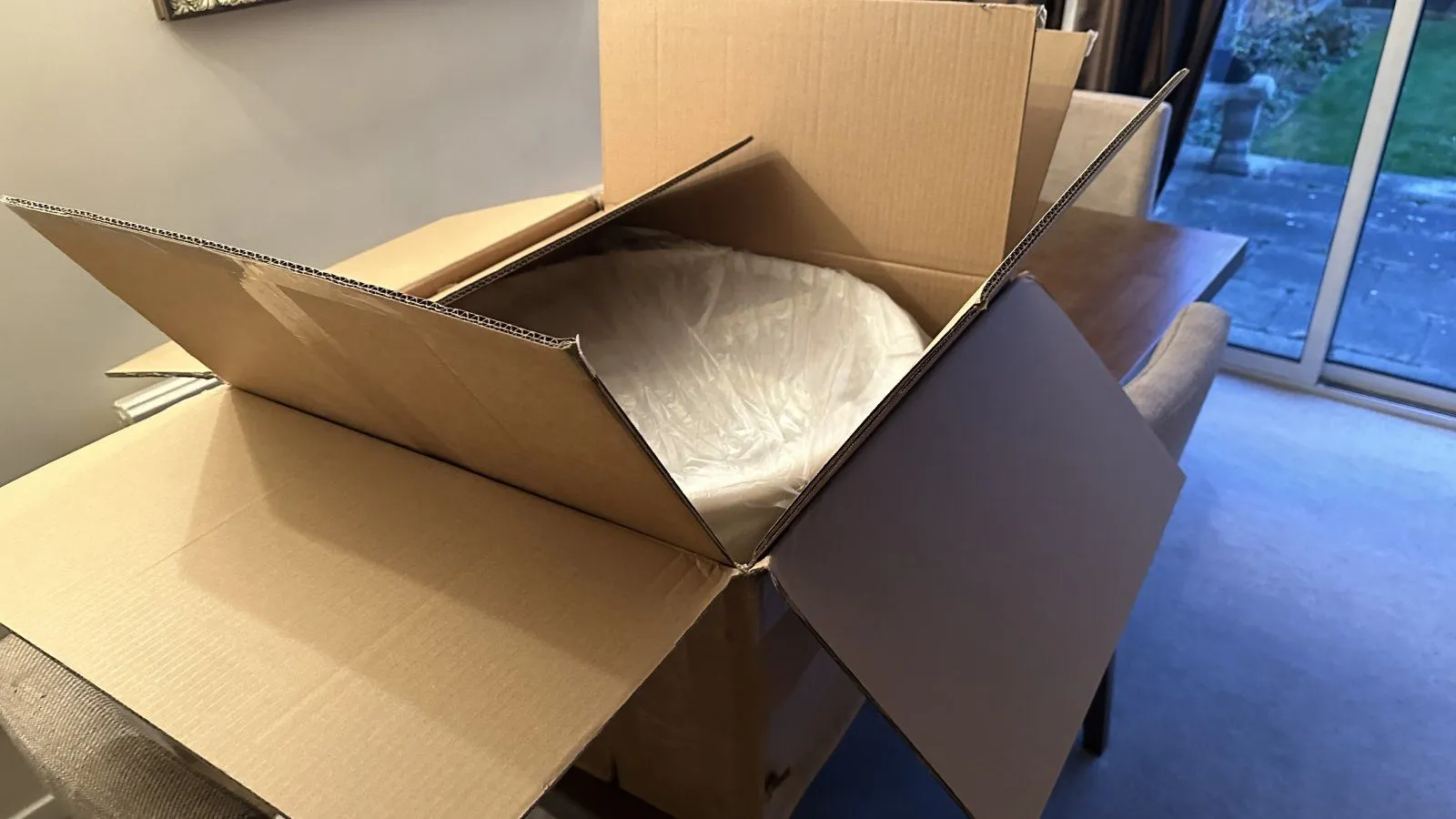

Well, 6 wheels arrived this morning :)
As already stated by Cayman09, they're very well packaged indeed.
Finish is great, and unlike a lot of wheels, the colour, in full gloss, runs right across to the inner rim. Many I've seen, including my Audi A4, F type etc, only really have a show finish on the outward facing side if things, with the inner rim being virtually grey primer.
My plan has been to paint the grooves in the spokes in DV, but I quite like them as they are, so this is to be decided.
Also surprised to see they are stamped JWL, which is I believe a Japanese safety/quality standards thing.
As also reported by Cayman09, the wider rears have a little more dish on the spokes (concave face) than the fronts. (factory wheels have same dish front & rear, with the hub on the rears being deeper to get the offset needed. You can see the heads of the wheel bolts recessed a lot more). I rather like the extra bit of concave on the rears.
Ignore the apparent colour differences between the pics, that's just my iphone getting it wrong.
On face value at least, these are outstanding value!
And my gut feeling is, they're not going to disintegrate when I push the start button.
So far, no one has asked for any VAT or Duty! though I'm sure it's coming :(

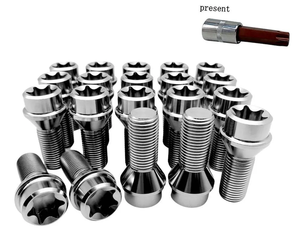

I'm going to get a set of torx head titanium lug bolts mostly because I can afford it, and I like the way they look. Whatever difference the few ounces of weight saved makes, that's just a bonus.

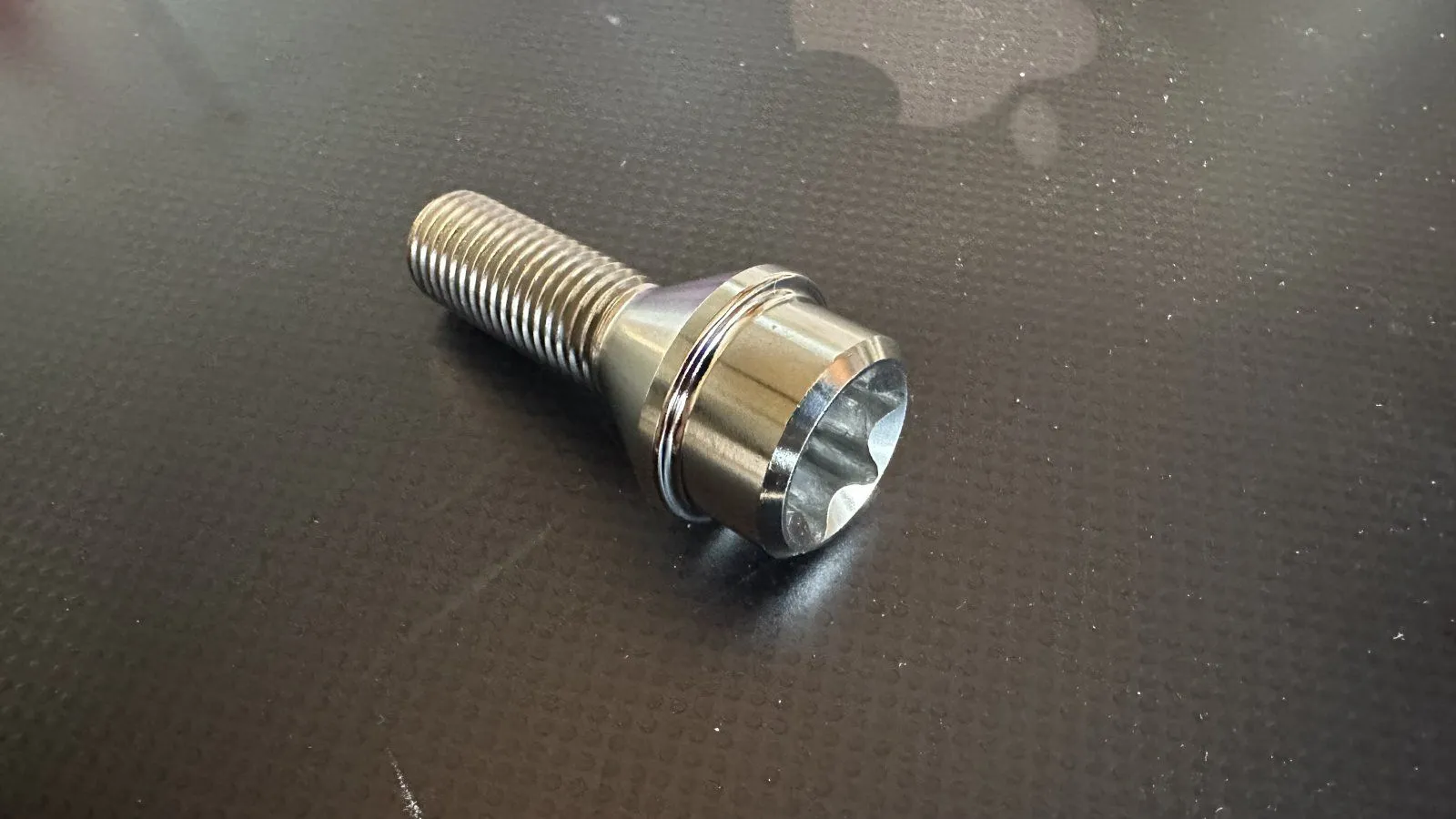

Here's the style I'm looking at:

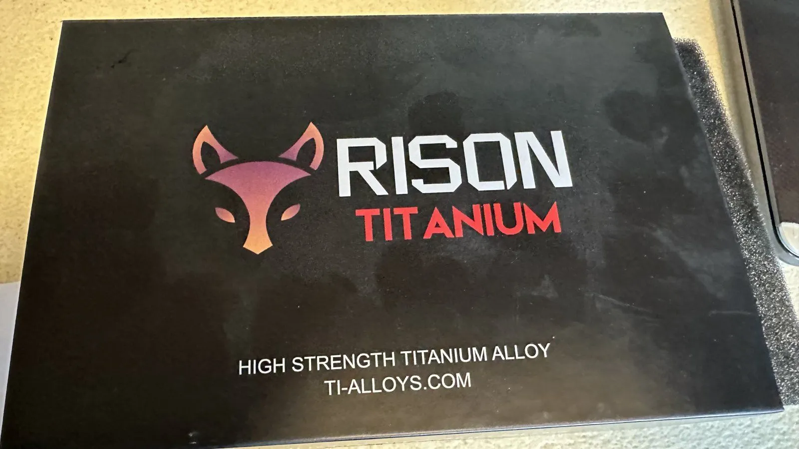

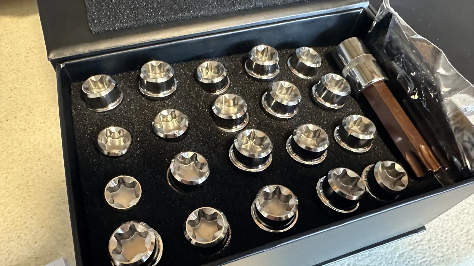

Nicely finished and packaged.

Titanium replacement lugs / bolts have been around for years for Ferraris (and no doubt other cars, but that’s where my knowledge lies) from extremely reputable companies, and I’m not aware of any issues at all.
Beyond the cost, anyway! :)
I‘ll definitely get a set along with the light-weight wheels from Aerie.
Will I notice the difference in performance?
Maybe. Probably not. Who cares?
You wouldn't notice a difference in performance for just the lugs alone, however you will notice a difference combined with the lighter wheels if you change them all out the same time as when you replace the wheels.
If you have any amount of time driving the car with the factory setup, that's when you'll notice the difference. If you change the wheels and lugs right away when you first get the car, you don't have any experience to compare them to. This is why I'm going to go through the first 1,000 mile break-in period with the car completely stock. I'll have stuff ready, but I want to wait until the break-in is done so I can get a dyno run stock to use as a baseline for measuring improvements.
What you will notice with removing unsprung rotating weight from the wheels, is the car seems a bit lighter on it's feet. It moves forward easier. Turn-in and steering effort seems a bit lighter. For a car with hydraulic steering like the Emira, you should really feel it in the front wheels especially.
Did you buy a set? Can you weigh them?
I did.
Not in a position to weigh them until Wednesday, as I'm away at the moment with work.
I didn't buy them with weight saving in mind to be honest, I just thought they looked rather smart, and different.
