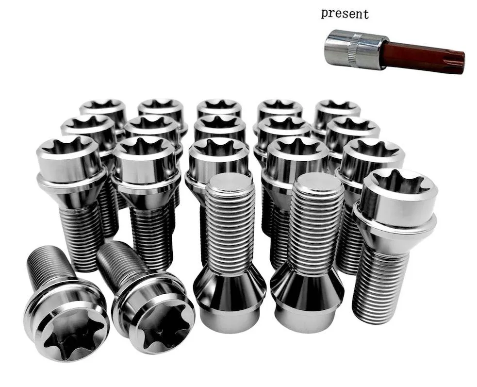

I'm going to get a set of torx head titanium lug bolts mostly because I can afford it, and I like the way they look. Whatever difference the few ounces of weight saved makes, that's just a bonus.
Here's the style I'm looking at:
They're nice! Who is the supplier?

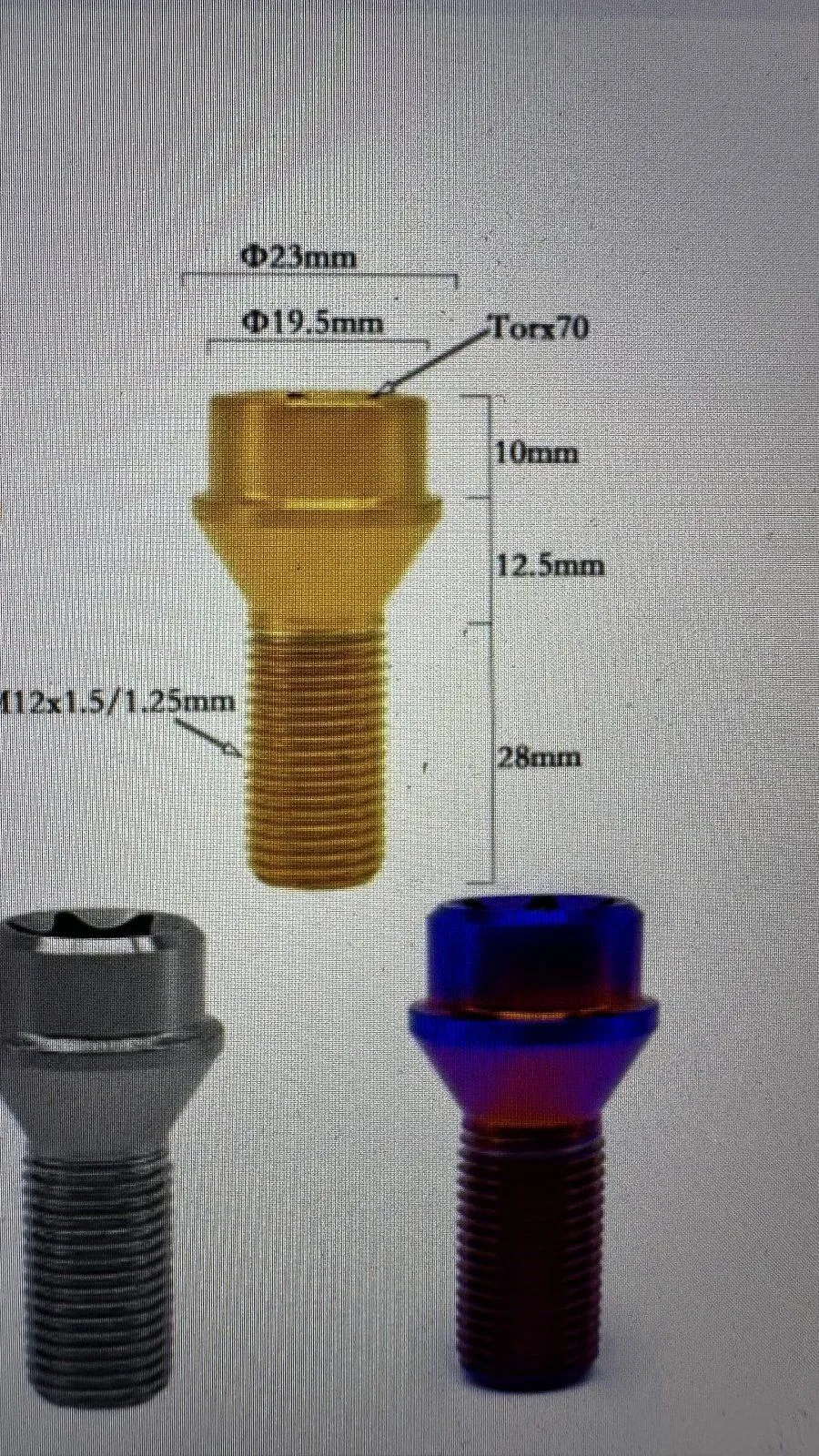

I'm not sure about the length yet, but these are the ones:
I'm planning on getting a set of wheels from Aerie, so these should look really good with them.

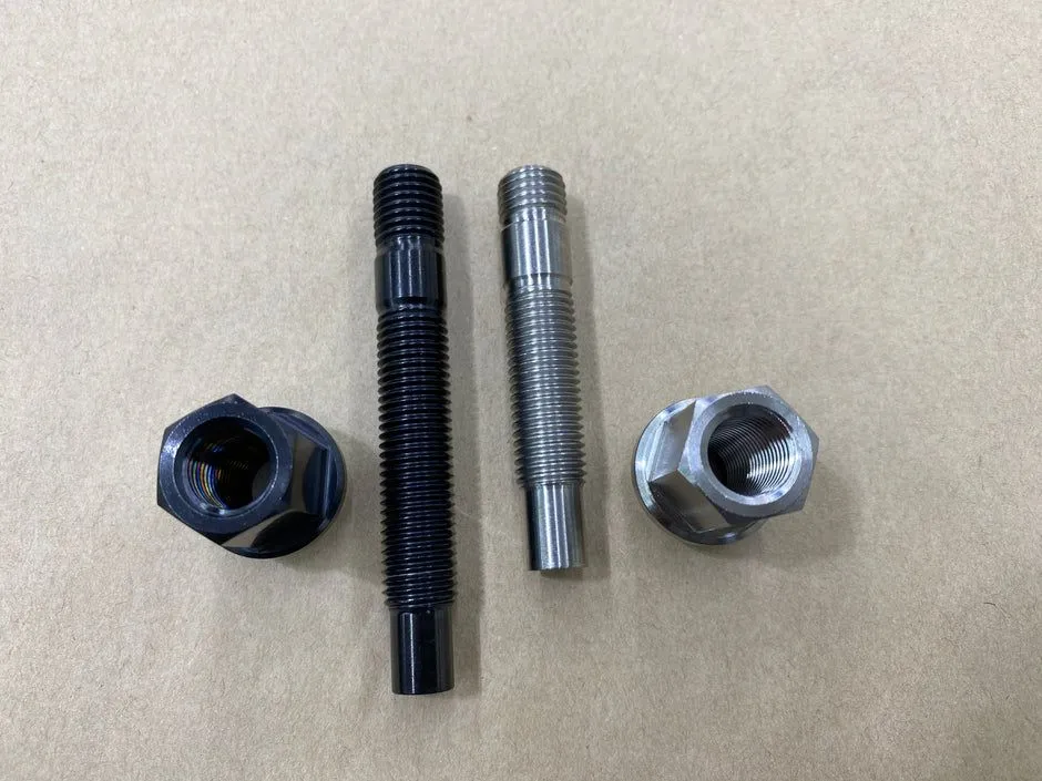

Thanks @GRP. I’m looking at the titanium stud kit on your website. Can you machine custom lengths?
What length are you looking for?
We just have the two lengths available but the shorter option should be good for oem wheels with no spacers or small 6mm spacers.

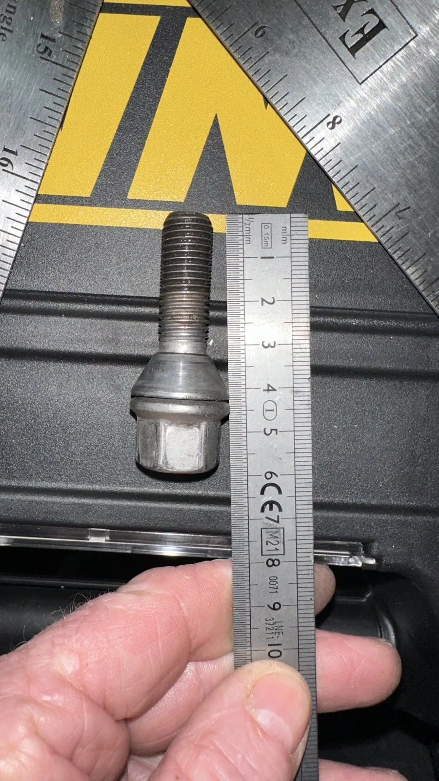

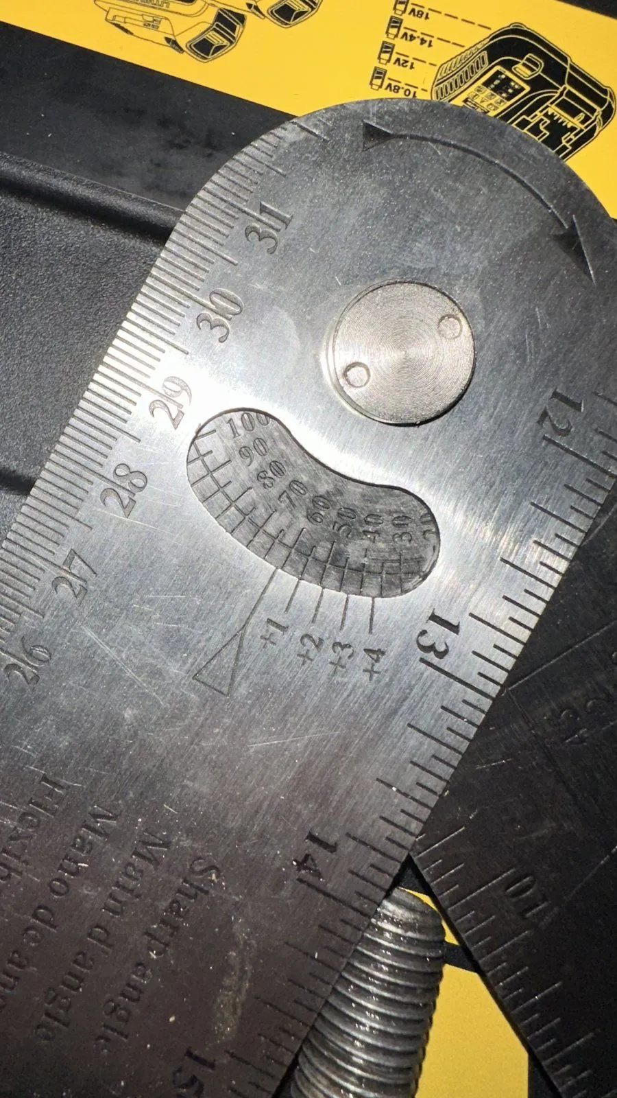

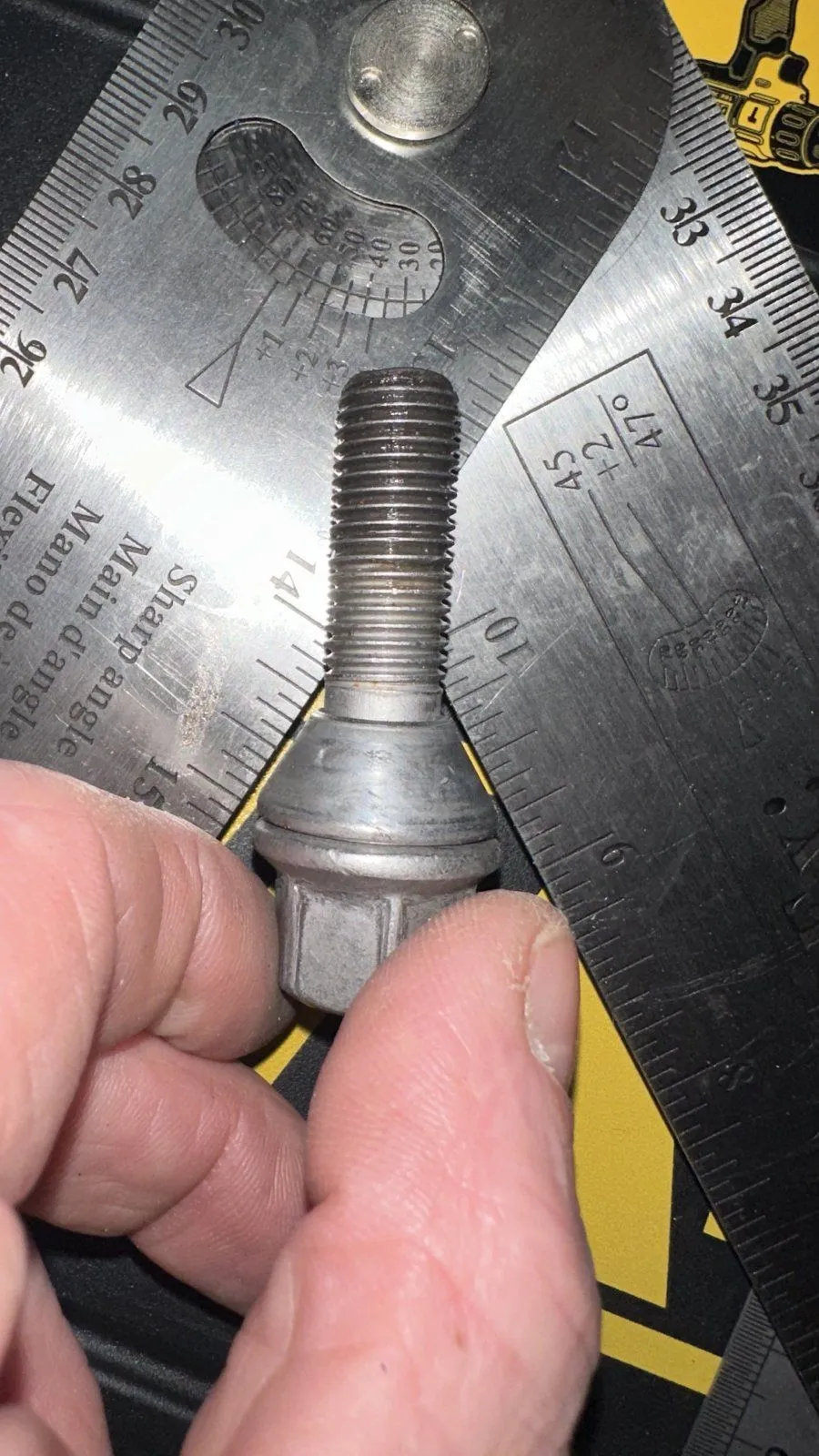

I'm on a flight to Portugal 1st thing tomorrow morning, if it can wait till thursday when I am back, I can do it then.
Sorry, forgot that I said I would do this.
Here you go.....
Hard to be precise, but taper seat appears to be 61 degrees.
I am assuming they measure the thread length from the bottom of the taper, making the stock bolts about 32mm, but I don't know this for sure. A CSK bolt/screw length is measured from face of head, to tip (ie, overall length), so I really don't know. Those Titanium bolts are quoted as 28mm, would be nice to see a rule next to one.
EDIT: picture shows, thread is 28mm to bottom of taper, so they're probably ok, certainly for stock wheels without spacers.

It's almost certainly a 60 degree conical design, that's the most common for passenger cars.

We have been selling our stud kits for a few years now and have had zero issues although If the car will be tracked a good amount its advisable to use steel studs and swap them out annually or bi-annually depending on how many times they have been torqued as Im sure you know/do anyways.

@GRP I was thinking shorter, but thanks to a visual confirmation on lug bolt length from @JonFuller, I think your 66 mm set will do nicely. I was basing my calculations on a 25.4 mm thread length. Difficulties of modding a car without actually having one.
Thanks @JonFuller for those pictures! Greatly appreciated.
