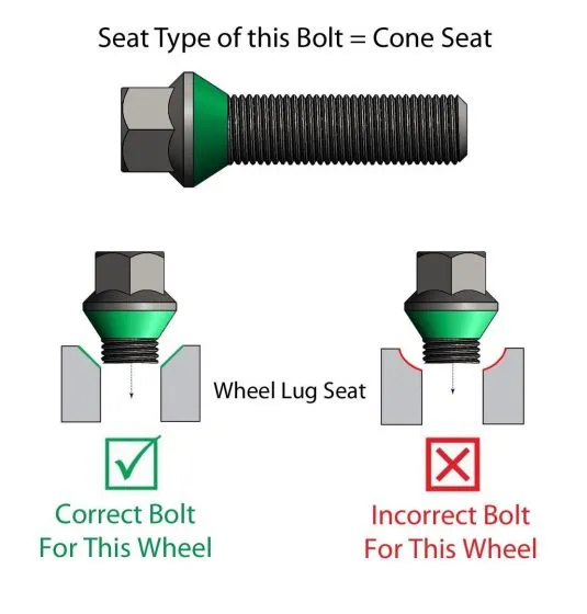

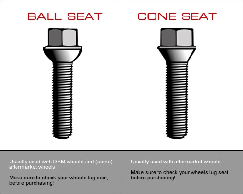

For aftermarket wheels, does anyone know which are the correct BOLTS to use as OEM and Aftermarket are typically different.
The OEM bolts are cone seat. The appropriate type for an aftermarket wheel depends on the socket profile of the wheel. Most will be cone seat to match the factory type for this vehicle.
Emira deff has Cone bolt heads / seats. The only question I have is, what is the taper angle? I read that 60 degree is 'a standard', which I don't doubt, but my best effort at measuring the angle on my STD Emira bolts, suggests they are 61 degree.
Anyways, as I said, I shall try both my new Titanium bolts, and the stock bolts in the wheel sockets of my new wheels, and the stock wheels and see how it all feels / compares.
The sockets in the new wheels certainly look conical, not ball (I'm quite sure it's a cone), just that angle I need to confirm.

I’ve only heard of 60 degrees while doing 3D modeling in CNC software. This is a common angle for metric fasteners and countersunk holes. The next angles up are 82 and 90. I’d have to presume the Emira lug bolts and aftermarket wheel manufacturers are also following this 60 degree standard.
With a set of callipers and a scientific calculator, you could break out the high school trigonometry and calculate the taper angle of the cone washer. 😂

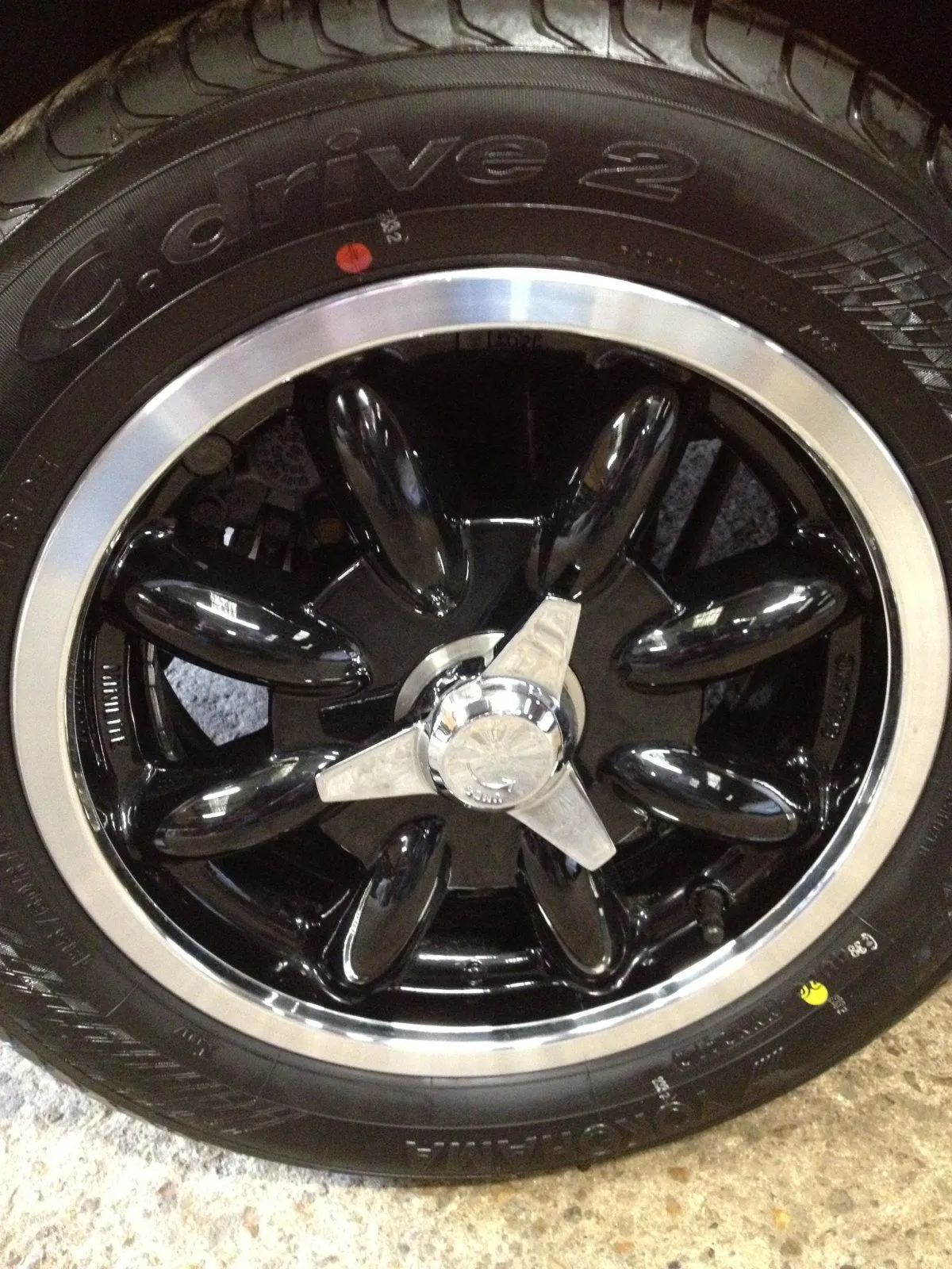

Three eared like this. In the US at some point the ears were not allowed for safety reasons and Elans were shipped without the ears, just big ol’ nuts requiring a big spanner. I think they were referred to as Nader nuts.

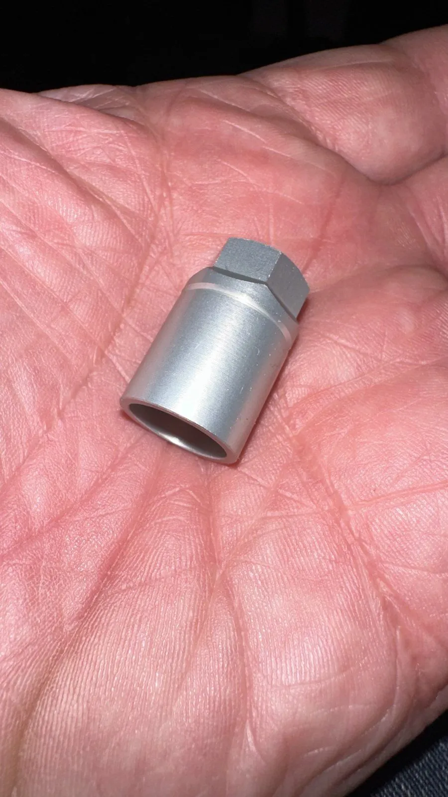

Today I collected 4 new TPMS units and retaining nuts from B&C to go in my new wheels. Also have 4 GoodYear F1 tyres sitting in my basket at Camskill ready to push the button, so I'll be keeping the originals complete as spares for now.
For anyone interested, these are the details of the units....
Any way to make the exposed parts black? These are going to stand out on black wheels.
The 'nuts' are alloy, so you could anodise them black for sure.
The caps I'm using are already anodised black alloy.
