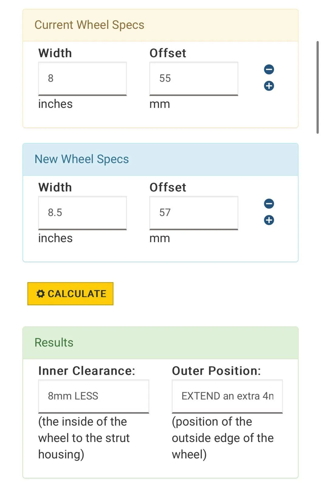

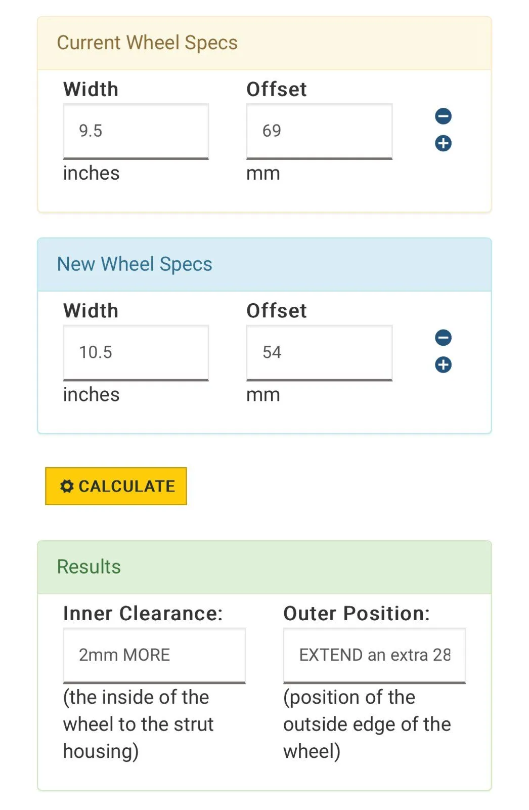

I found a calculator online, can you please help me interpret the results, this is all a bit foreign to me, but keen to learn.
The offset for the front and rear are as follows:
The ET is 55 front and 69 rear.
Swap “Current Wheel Specs” and “New Wheel Specs” in the calculator and it will make more sense.
Basically if you put those wheels in an Emira the outside of rear wheels will be sunken into the wheel well by 28mm and the inside of the wheel will be 2mm closer to suspension components.
The outside of fronts will be sunken by 4mm and the insides will be 8mm farther from suspension components.
They will fit, but I don’t think they’ll look good.
I also suspect the rears won't clear the brakes without a significant spacer. Which will help the appearance as well, but introduces mechanical failure risk since it's too thick to "sandwich" and would be a bolt-on type.

i appreciate the replies here from you and @Porter.
Sounds like this isn’t going to fly.

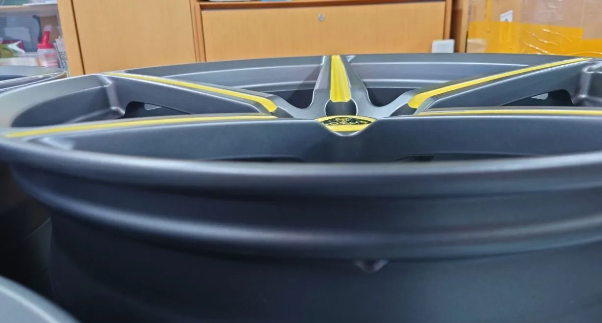

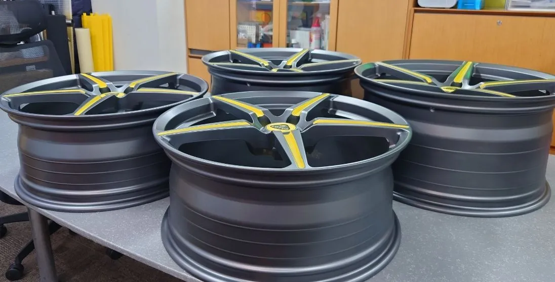

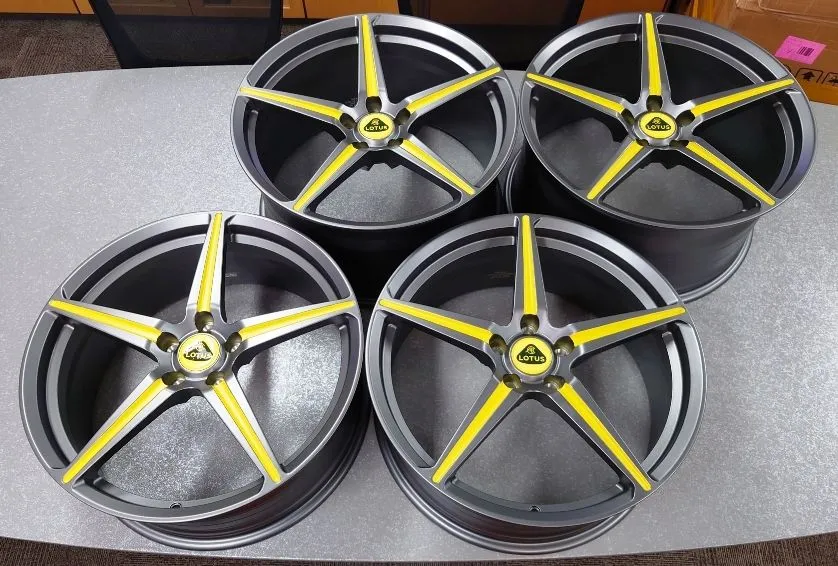

The forged wheels that I had custom ordered were delivered today via Fedex.
The packaging, which I was worried about, was wrapped in two sturdy cardboard boxes and carefully protected to prevent damage to the rims.

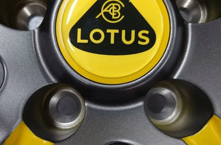

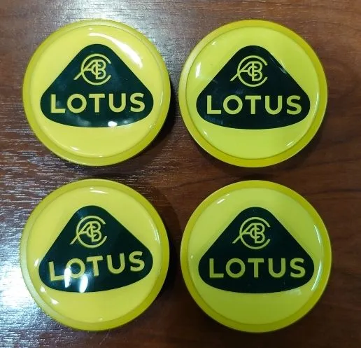

The logo design on the center cap was "LOTUS NYO", so I had a regular LOTUS badge available, so I modified it.
The front 8.5J has flat spokes, but the rear 10.5J has spokes that are concave toward the center.
Since I have some time until the car is delivered, I would like to decide on tires that I can install slowly until the car is delivered.
The weight was F: 10.4kg, R: 10.7kg.

Those are going to look sharp!
You should keep the NYO caps for show ! Hope the car comes soon !

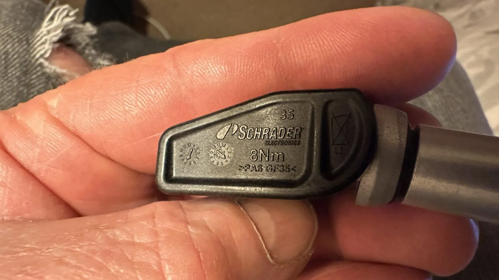

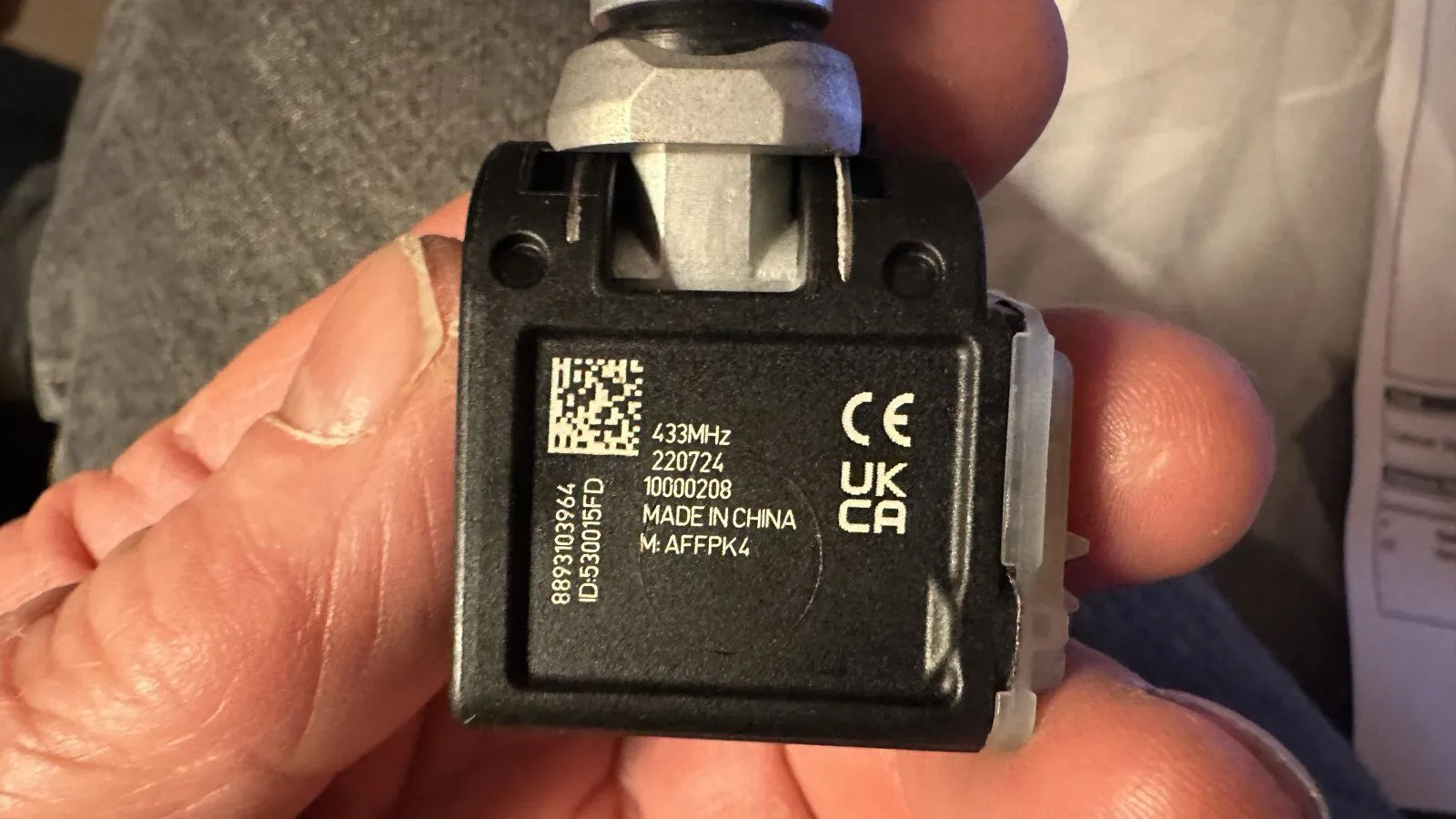

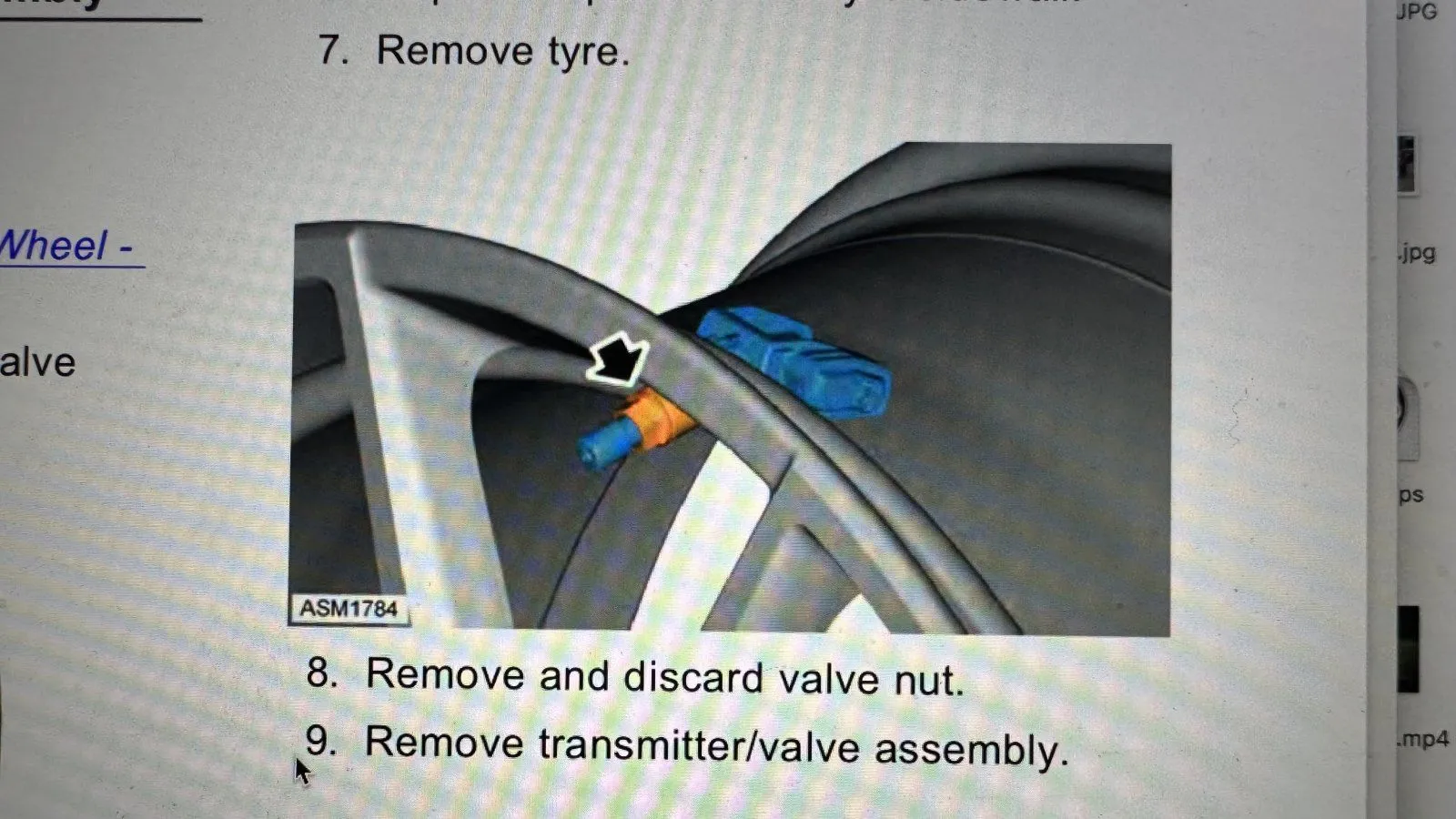

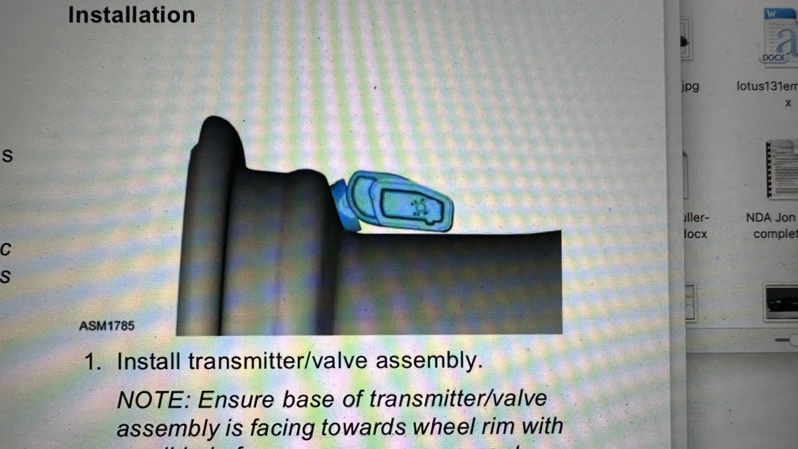

Today I collected 4 new TPMS units and retaining nuts from B&C to go in my new wheels. Also have 4 GoodYear F1 tyres sitting in my basket at Camskill ready to push the button, so I'll be keeping the originals complete as spares for now.
For anyone interested, these are the details of the units....

Thanks for the part numbers. Ordered myself. And if shipping is less than $100 it'll be ahead of the local parts supplier.

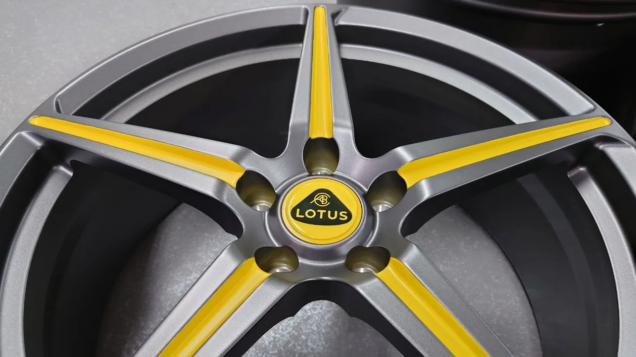

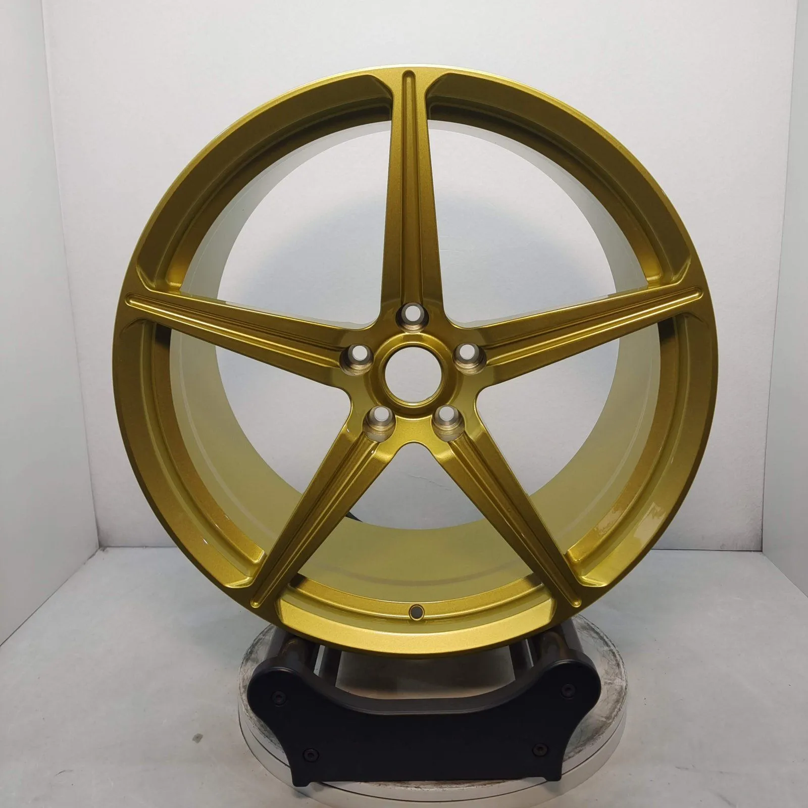

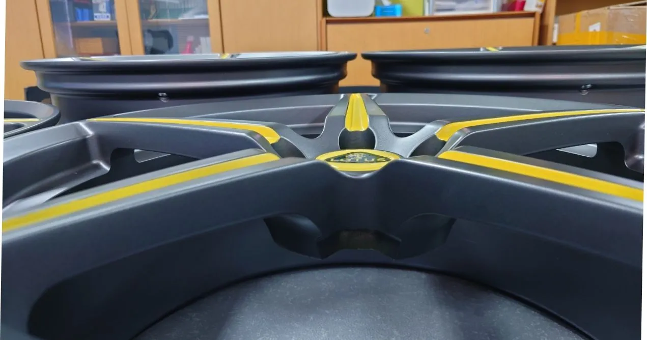

Wheels are finished, they just sent these photos (not virtual render)
I will be painting the inset groove Dark Verdant when they arrive).
Given that whilst the manufacturing plant looks huge (and probably makes wheels for more well known 'brands' than you'd like to think), and will likely be around for a while, but the agency/marketing mob whom you deal through, may not, I bought 6 wheels, so a full set, plus a spare front, and spare rear. @ $217 each, it seemed a sensible insurance policy, just in case I were to damage one. Would be annoying to have to scrap 3 perfectly good wheels because one got damaged and couldn't be replaced!

Looks great! That's shockingly cheap. I am so tempted.
You'll upset, and get the wrath of, FreddieDB!
I think the Dark Verdant spoke insets will finish em off nicely.

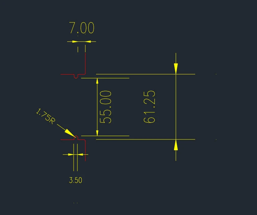

A note: Cayman09 ordered a set, and his arrived with a centre cap bore of 65.5mm. stock lotus wheel is 61.25mm bore. (Lotus centre cap is 60mm OD)
I sent them a wee drawing (see below), so mine were made to the std size of 61.25mm, in addition to the small change I asked for on the spoke design (just a personal preference), so anyone wanting to re-use the Lotius centre caps, or a copy there of, the std 65.5mm may be a bit sloppy.
Cayman09's came with 'Lotus NYO' centre caps (obviously copies) and are presumably the right size for the 65.5mm wheel bore, so slightly larger diameter than the OE part.

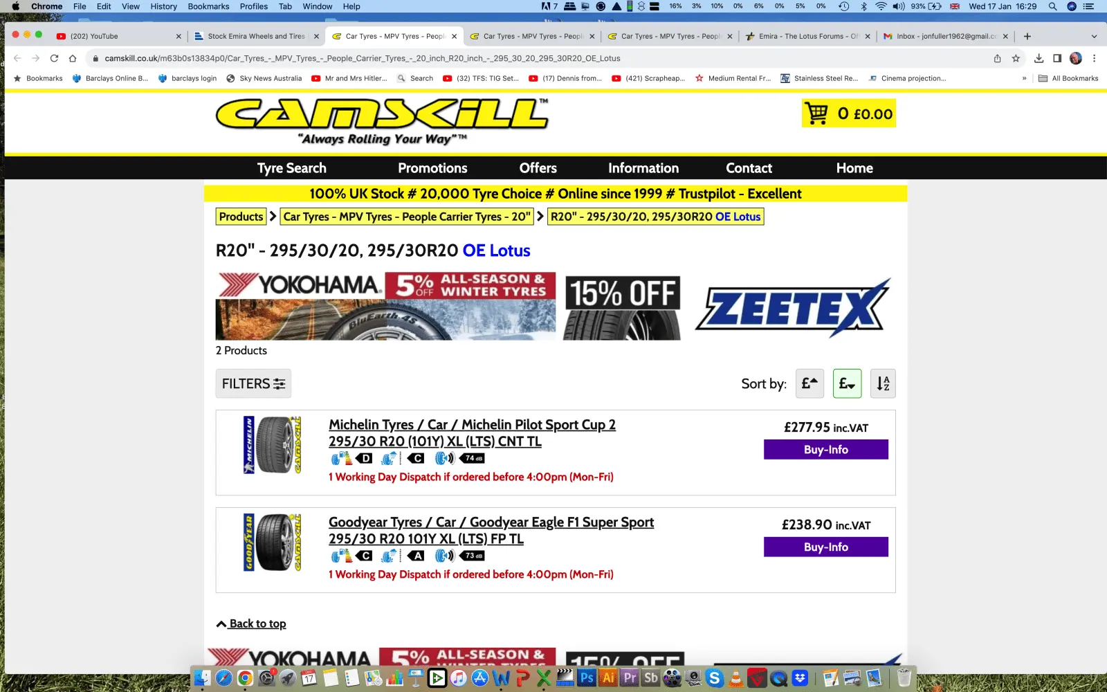

Tyres (sorry, Tires) ordered, £903 GBP delivered, for the set, or about $1140 USD, Original fitment (LTS) GY F1's
@JonFuller I wish tires were that cheap. I think my Alpin PA4 set was $1700 usd. Wherever you're getting those F1s = winning.
