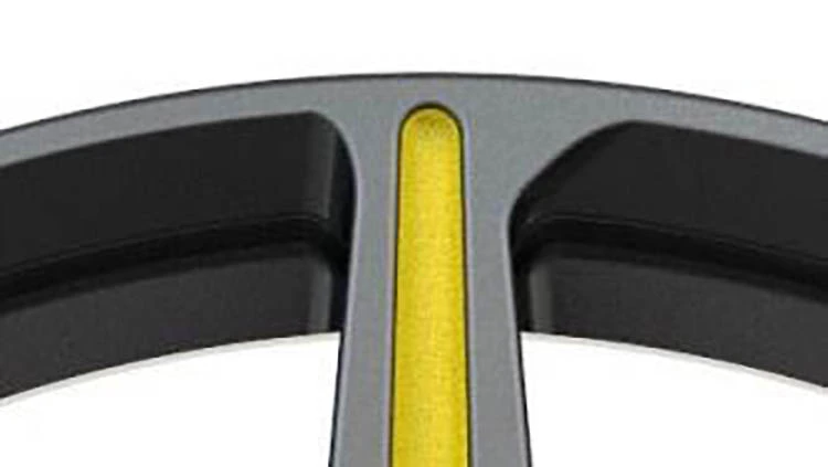

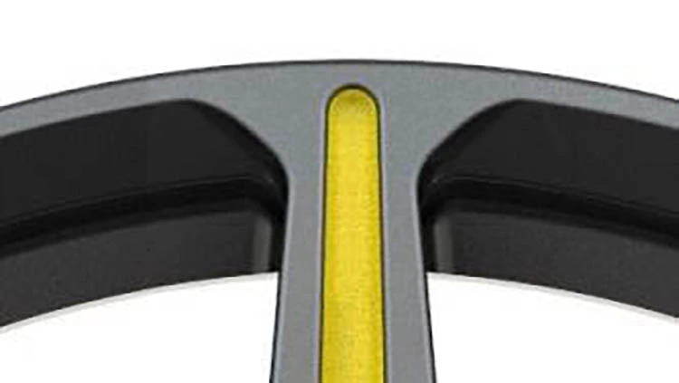

The Chinese company seem very helpful. I was even able to slightly alter the design. As they are machined from forged blanks (CNC) it's possible for them to make bespoke changes. I didn't want the wheels to be handed, as on the Ferrari 458 they're copied from. on that car, where the spoke meets the rim, they're asymmetrical, ie, the leading and trailing edges have differing radii (see pic)
So I photoshopped an image showing that I wanted it symetrical, and they're changing the CNC program to acheive that for me, as per second image.
I gave them all the info, centre cap attachment dims etc, hub/spigot dims, ET, PCD etc etc.
They didn't charge any extra for the changes. wheels were all priced at $217 USD each, despite the rears being bigger. $475 shipping. So the whole lot was £1100 GBP shipped, obviously plus any duty and tax at my end.
So time will tell how they turn out, fingers crossed. At that price, I'm prepared to take the risk.
They didn't charge any extra for the changes. wheels were all priced at $217 each, despite the rears being bigger. $475 shipping. So the whole lot was £1100 shipped, obviously plus any duty and tax at my end.
