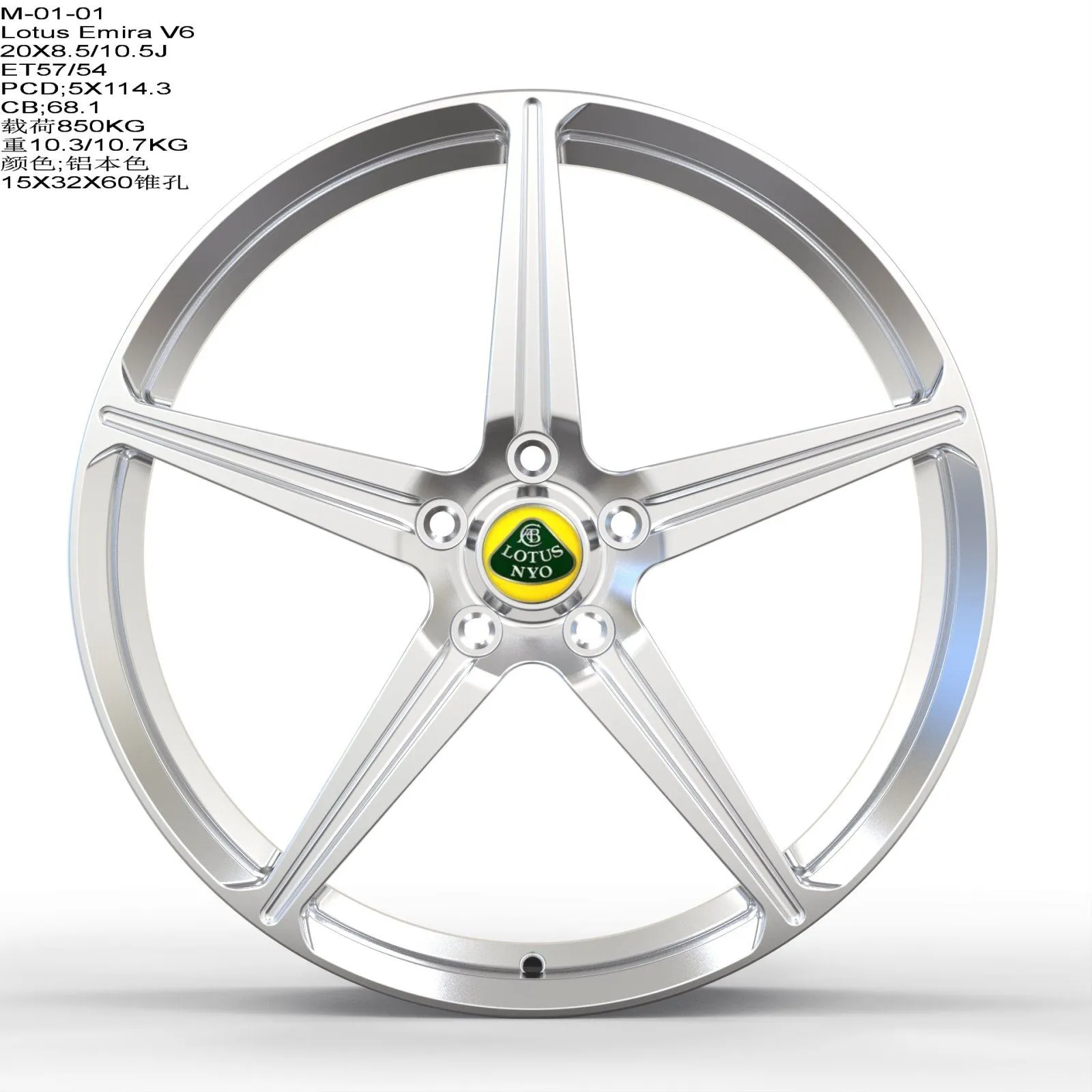

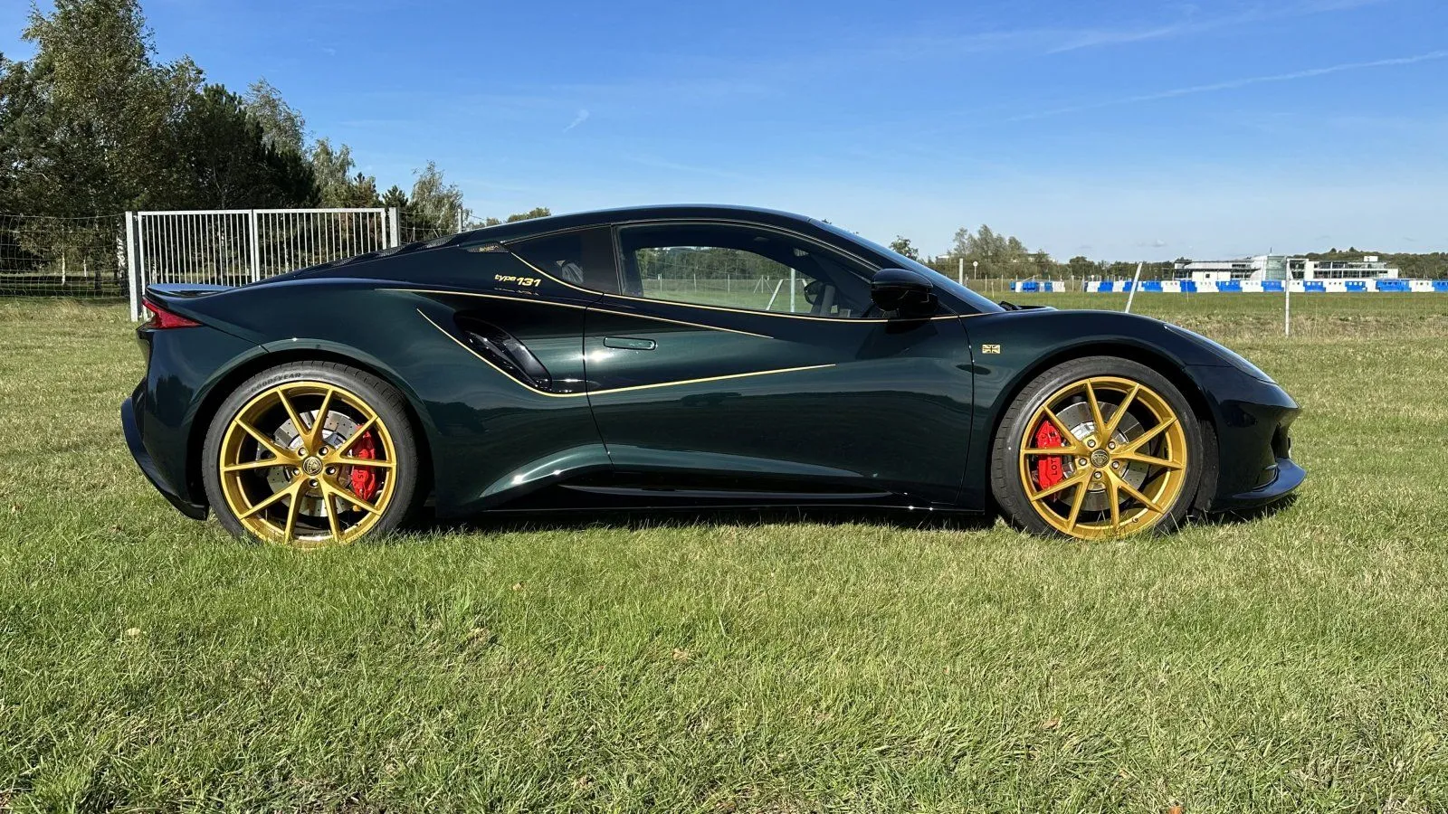

Well, they've redone the CAD with my small alteration to the spokes and sent a visual render (obviously virtual).
Time will tell.
Well, they've redone the CAD with my small spoke alteration and sent a visual (obviously virtual).
Time will tell.
Thanks for taking one for the team. Looking forward to reading your experience with this wheel.

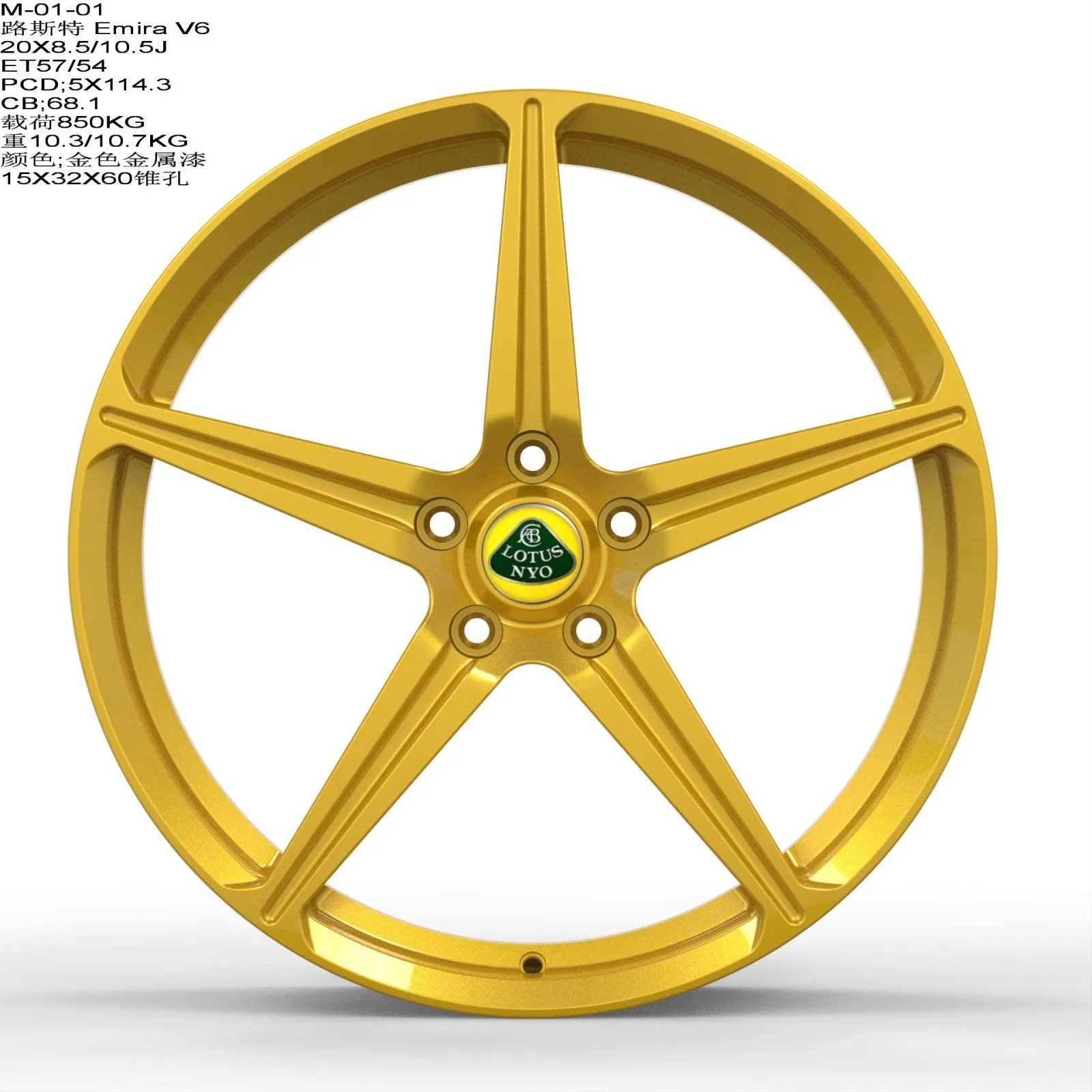

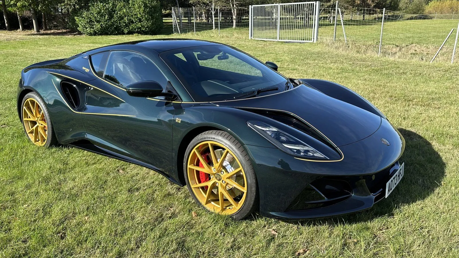

Gold visual, as obviously these will be replacing my stock gold wheels.

The yellow highlights are going to look great on your yellow Emira! ... Looking fwd to seeing that.

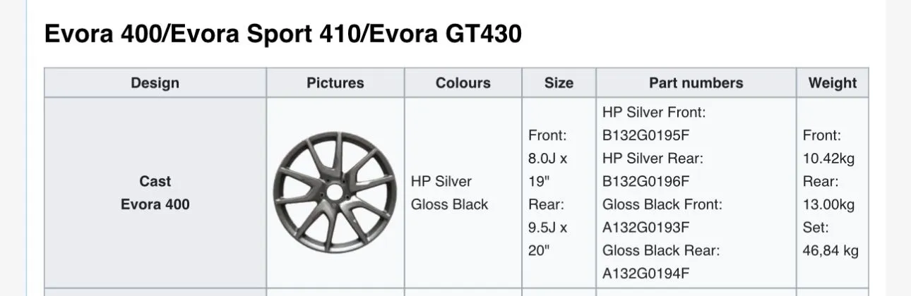

Leading with a potentially stupid question.
If I’ve a spare set of these off a 2017 evora 400 would they potentially fit on an Emira ? Thanks
possibly, but you'd need to check the ET (offset) to be sure, Emira is 57 front, 54 rear, but as the wheels are roughly 1" narrower than Emira, it would need some thought.
I think the PCD is the same, and a couple of campanies offer 18" for Emira, so assume they'd clear the calipers on the front (Emira is 20" front and rear)

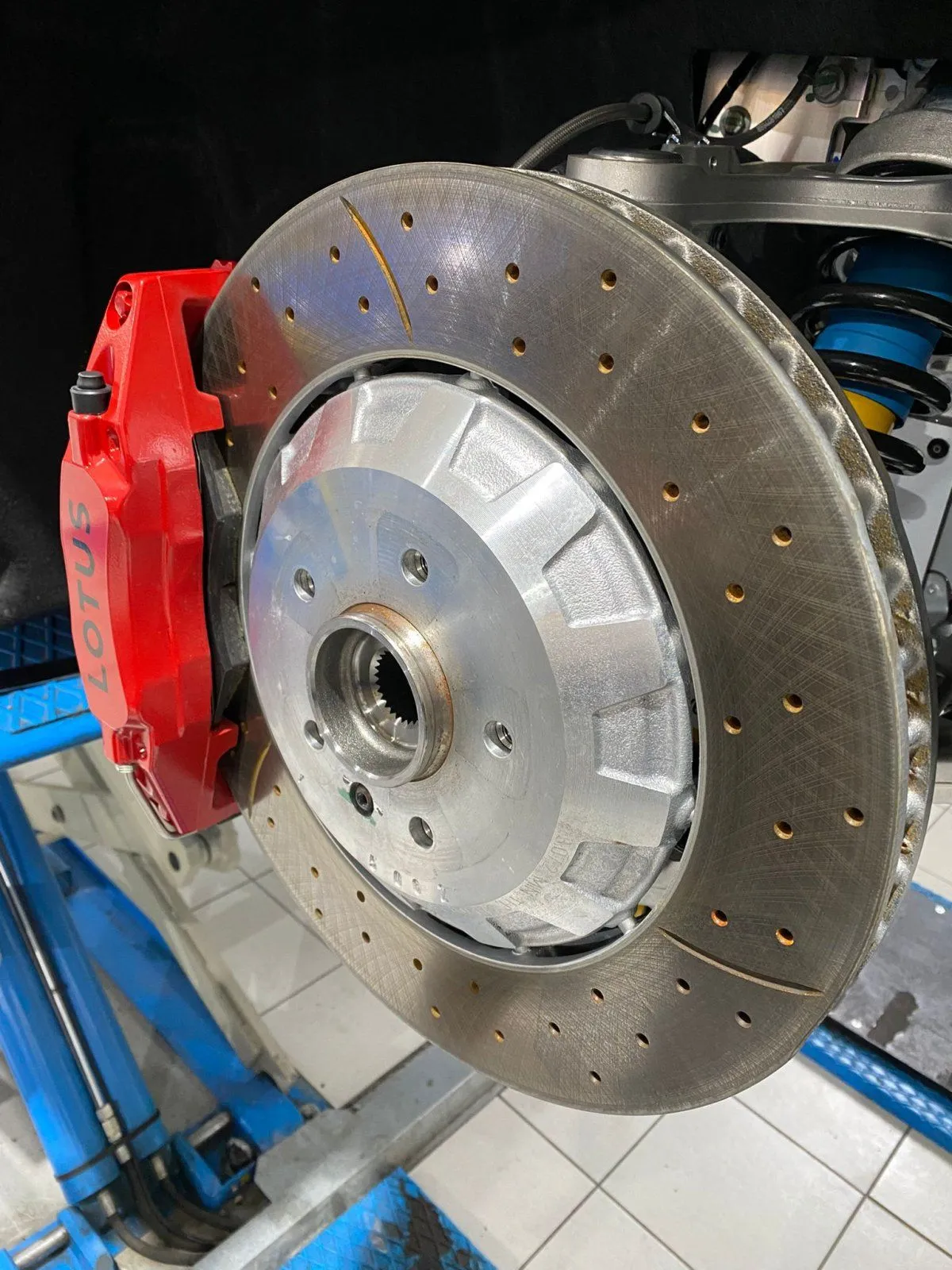

Can someone confirm the brake specs as installed on the Emira? Brand, diameter, clearance from wheels.
They’re AP racing, we don’t know exactly which caliper model but we think same as the Evora GT. 370mmx32mm and 350mmx32mm.
Unknown clearances

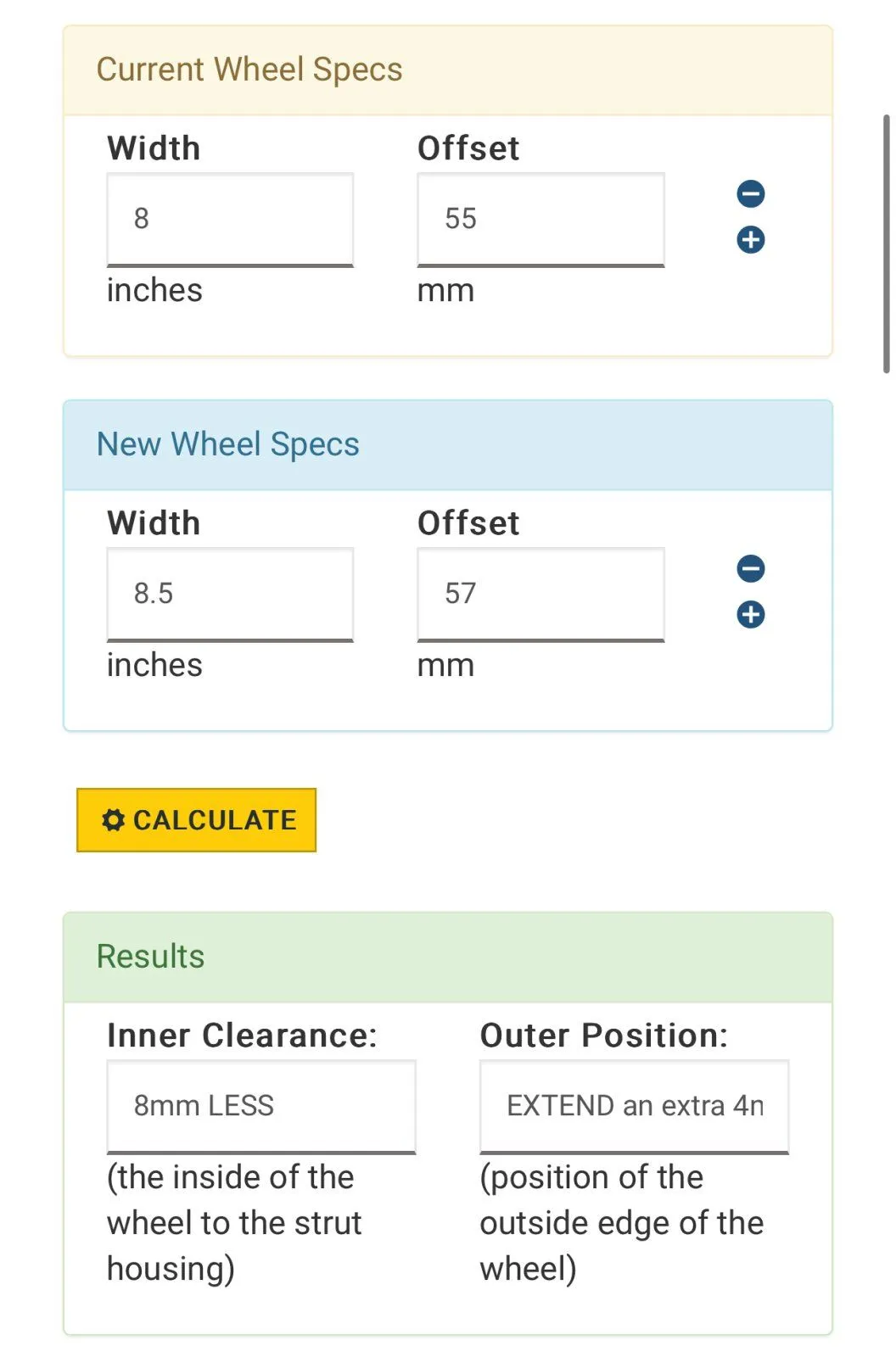

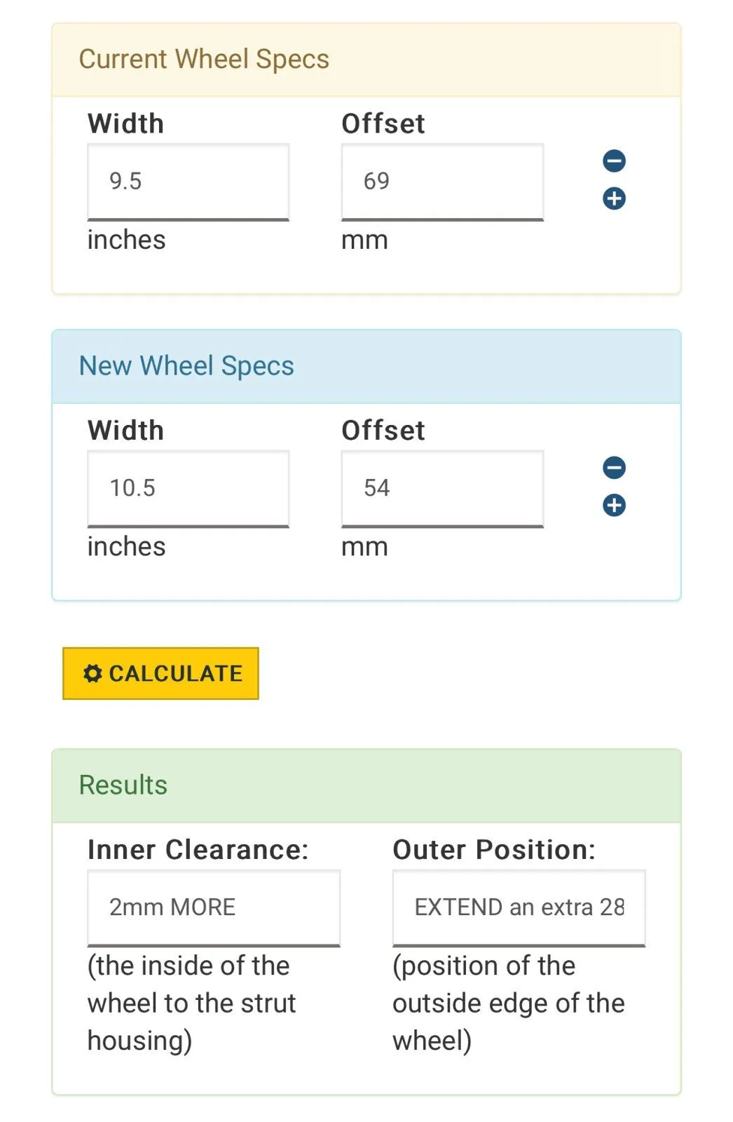

The ET is 55 front and 69 rear, of these wheels I’m considering for the Emira
I found a calculator online, can you please help me interpret the results, this is all a bit foreign to me, but keen to learn.
