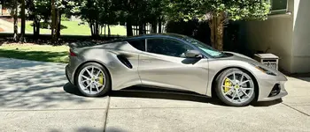

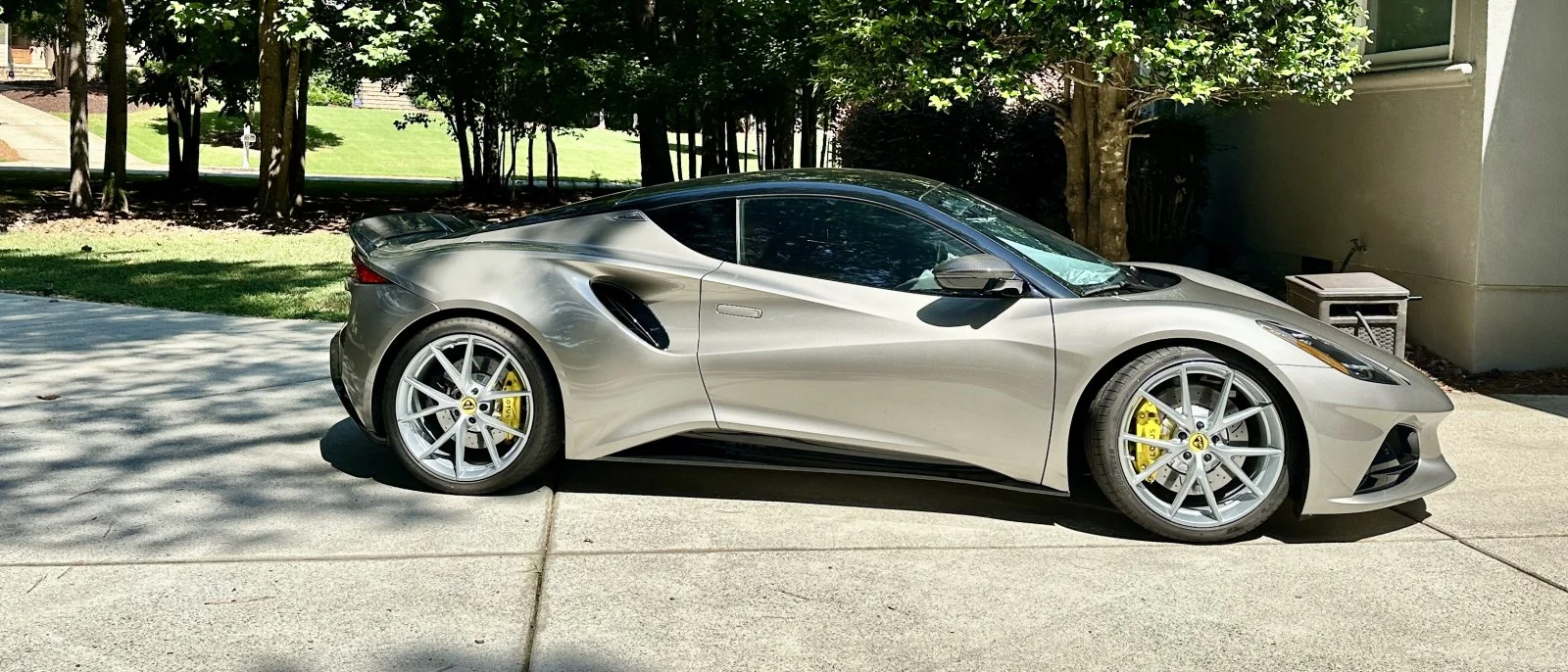

Lowered by 25mm and spacers from GRP.

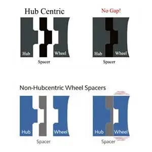

Perhaps someone could explain the meaning of hubcentric? From the posts here, I totally understand the need for them to be this way. However, would be helpful to also have an understanding of the term. Also… surely all spacers are gonna be made hub centric?
Hubcentric here means that the interface between the wheel and the hub interface is restricted to a single axis of movement: sliding the wheel on and off. This restriction helps with any imbalances that induce wheel shake.
Wheel spacers themselves can fit on the hub lip and be the same ID as the hub lip OD, but that doesn’t mean the spacer preserves the hubcentric lip to the wheel interface. In fact that’s what non hubcentric wheel spacers ruin: the hubcentric wheel interface.
So along come wheel spacers that have their own hubcentric lip extension that extends the original hub’s lip and preserves the hubcentric interface to the wheel.
Hopefully this makes sense? These spacers should really be called “spacers with a hub centric lip extension” but that’s a mouthful.
This also explains why some thinner spacers like 4mm don’t need a hub centric lip extension, because there’s still enough of the original lip poking through to support the wheel interface. The width of spacers we typically desire leaves almost no lip left.
Thank you for that. As an engineer, I totally get your explanation. I would have thought any manufacturer making plain spacers with no concentric location would have gone out of business. Stands to reason that a concentric location would be a must to make the product properly functional. And of course… safe!
there is nothing wrong or bad about a non concentric spacer (I believe the proper term is a shim for this type, but I might be totally wrong) so long as they are slim enough so that you can still use the original centre bore (I believe up to circa 6mm on the Emira).
A hubscentric spacer is easily possible for 12mm or more thickness on the Emira, but much less than that is challenging as the material would be getting thin. I run 12mm all round, but I’ve heard of 10mm hubscentric spacers being available.
So, there is a range of spacer thickness where it’s too thick for a shim, but not thick enough for a hubscentric spacer.
That looks pretty nice.. Any rubbing at all? I just worry about lowering that much (is that the max you can lower it btw?).. the roads here in Tampa / St Pete aren't the best with a TON of road issues..
