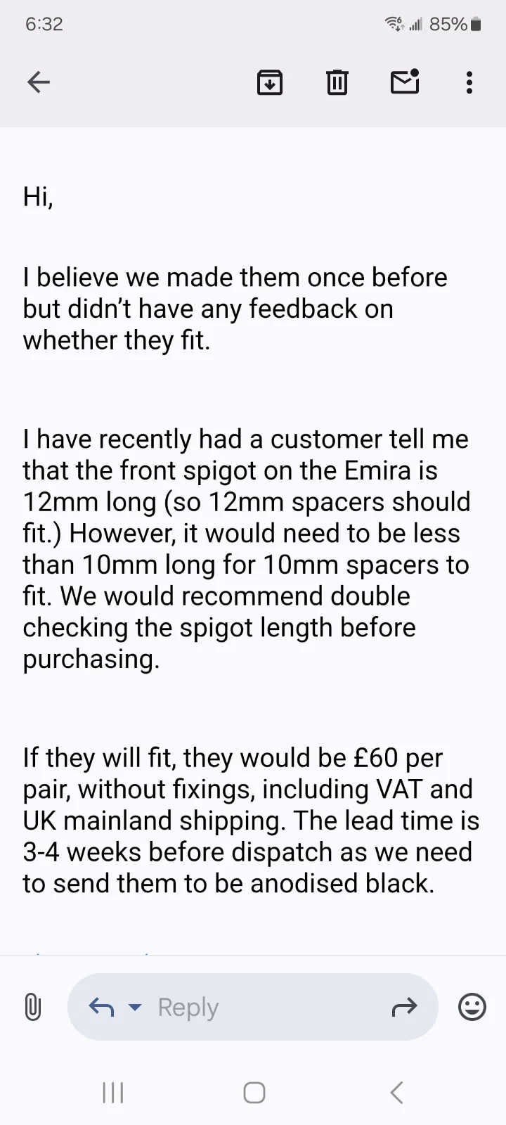

Odd, PCD stated they could only manufacture 10mm hubcentric if the hub spigot was less than 10mm in length...hmmm
Exactly! I just spoke to Charlotte and i was informed that the minimum hubcentric spacers they could make is 12 mm due to hub spigot being 12 mm.
I emailed her back and stated that they have made 10mm for others in past.....maybe those 10s became troublesome so they moved away from producing them unless the specs of the spigot comply?

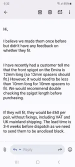

Their response:
