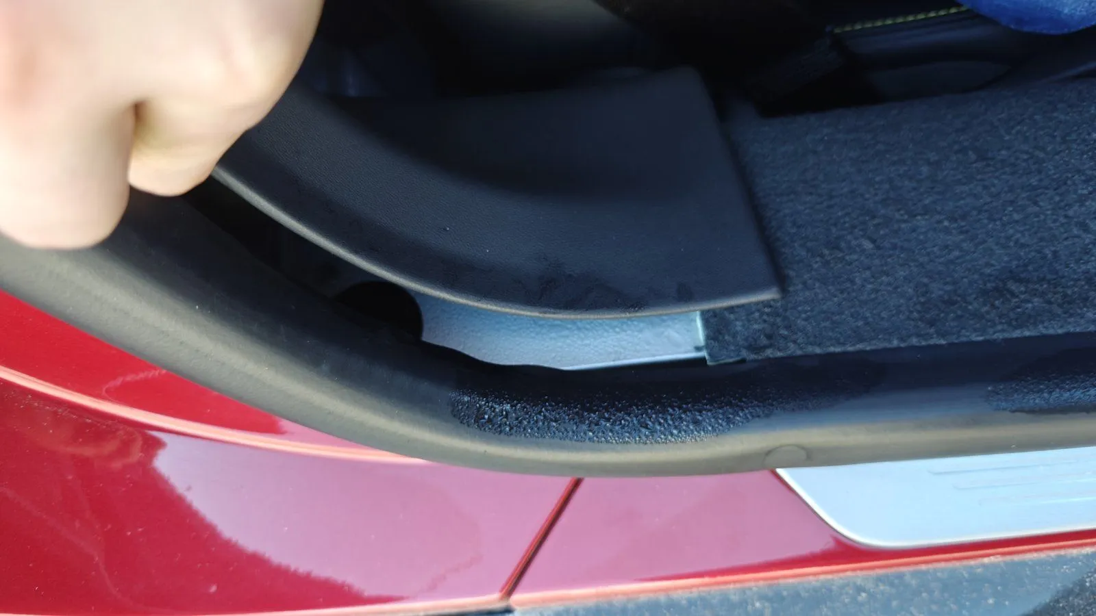

I don't understand how these are collecting water in the door at all. Don't they have drain holes?
Good question… all car doors should. The only time I’ve heard of water being collected inside a body panel was if a drain hole is clogged with debris… mainly leaves from parking outside.
@scoates can you snap a pic of the underside of your door and search for a drain hole for us?
Also, I recently read that some owners have the “whistling window” issue that is probably caused by a window that does not roll up all the way, so doesn’t seal at the top like was mentioned above. I watched a video where the guy said he only realized the window did not seal all the way when he was sitting inside and someone was pressure washing the car. He was unexpectedly splashed with water when they passed by.
Do you park it outside the majority of the time? Looks like it from your pics? The whistling window would cause condensation with a car that lives outside and is PROBABLY having water ingress imo. Even a small amount of moisture present in the car would cause this. Getting in a car in below freezing Utah winters without turning the car on will fog up the glass in less than a minute just from my breath… condensation (water droplets) will form on the interior windows shortly after.
The inside of your car will be warmer than the outside in almost all scenarios, so when you get in on chilly days and add body heat (or turn on the heater) it would get much, much worse. The same can be seen on an ice cold Coca Cola sitting out on a hot summer day… condensation… just from the tiny bit of moisture in the air.
You have water penetration somewhere in your cabin. Even if it’s a tiny bit. Look for a bad seal, and start with your windows not rolling up all the way.

Just thought of another thing. If the rubber seals on the bottom of your window are/were bad, the water that collected on the inside of the door could also have caused the condensation on the inside of the car through the bad seal there. The car door itself would basically act like a humidifier with a reservoir, and the bad seal at the base of the window would allow the humid air to enter the cabin 🤔
I'll try and look for a drain hole, but not today, it's pissing it down and don't want more water inside 😂
Not had any whistling from the windows so hopefully the seal from the door to the roof is good. I do keep the car outside so I think water must be getting in somehow.
