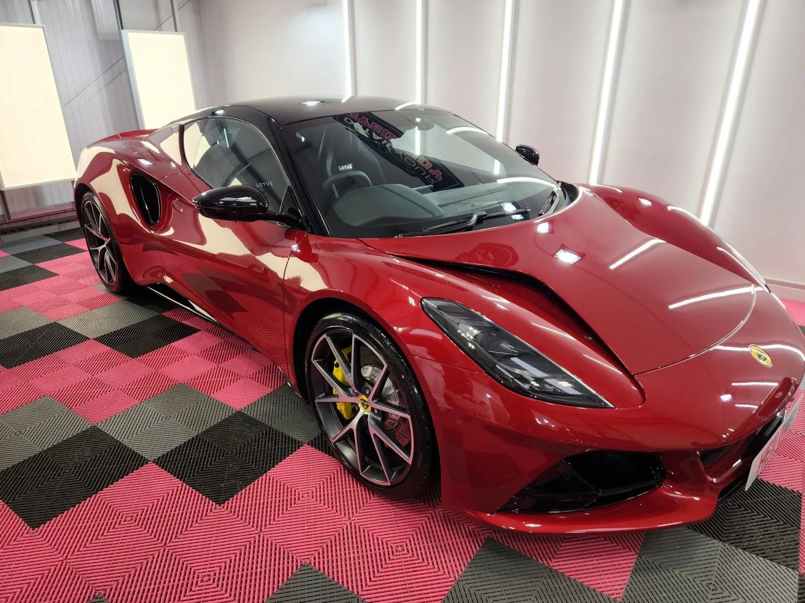

Congratulations and thank you for sharing your experience. You can see the dual personality of magma in photo set 3/3.

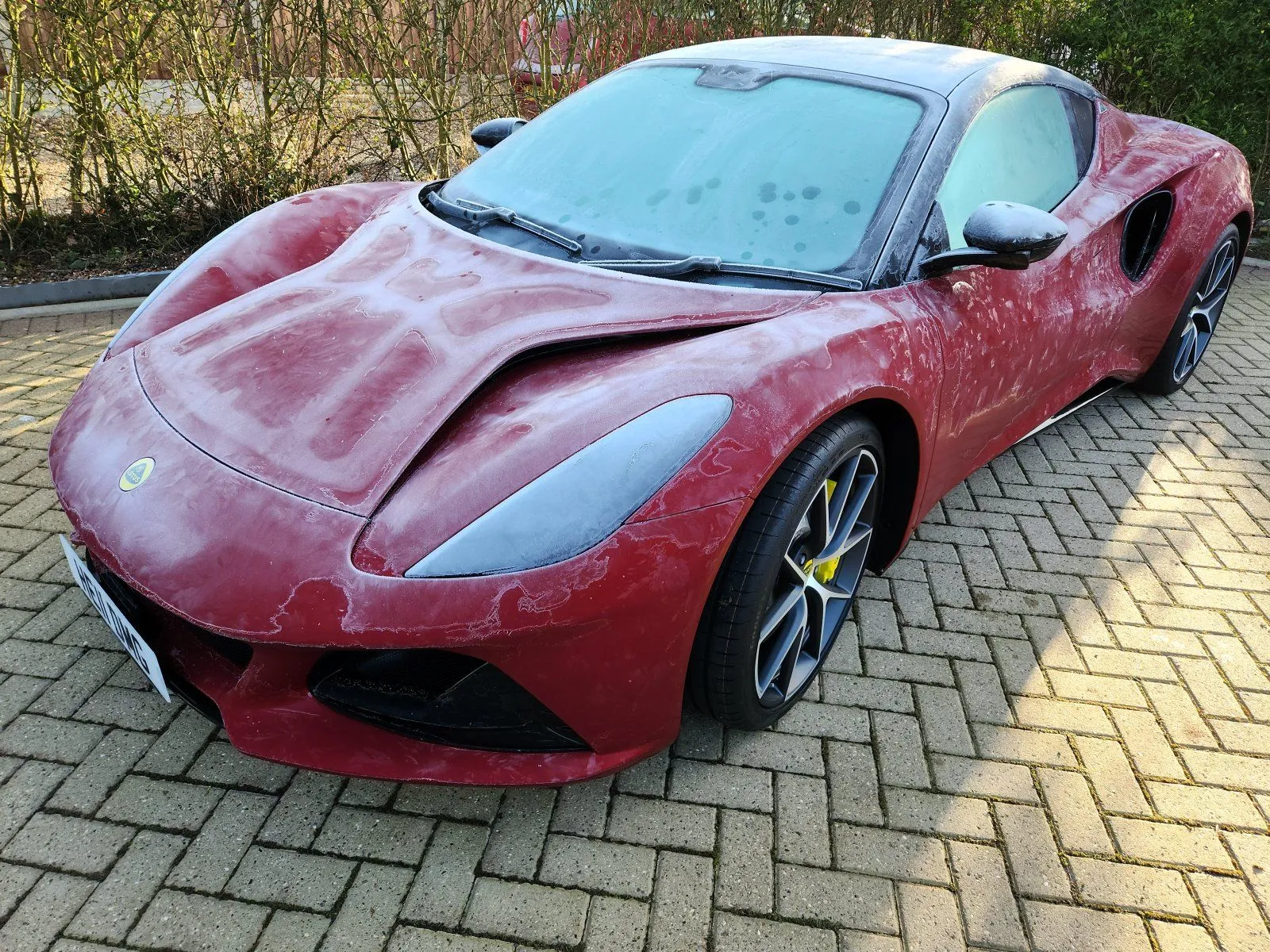

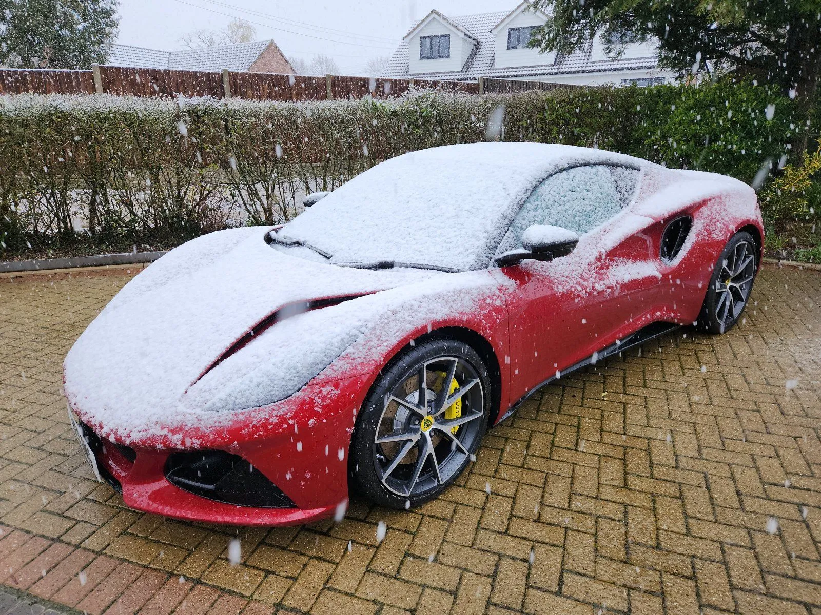

He's a bit cold this morning!!
I think you should use that photo in a new thread titled "PPF Gone Badly" just to get a reaction (and of course claim it's factory applied).

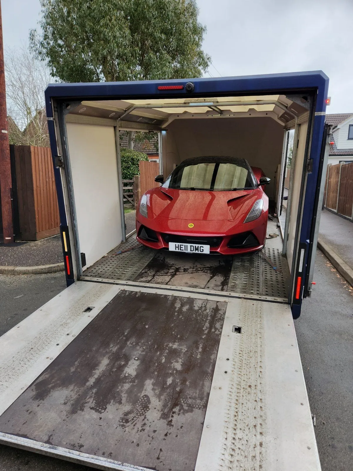

Car being collected to be taken to DETAIL YOUR EYECANDY

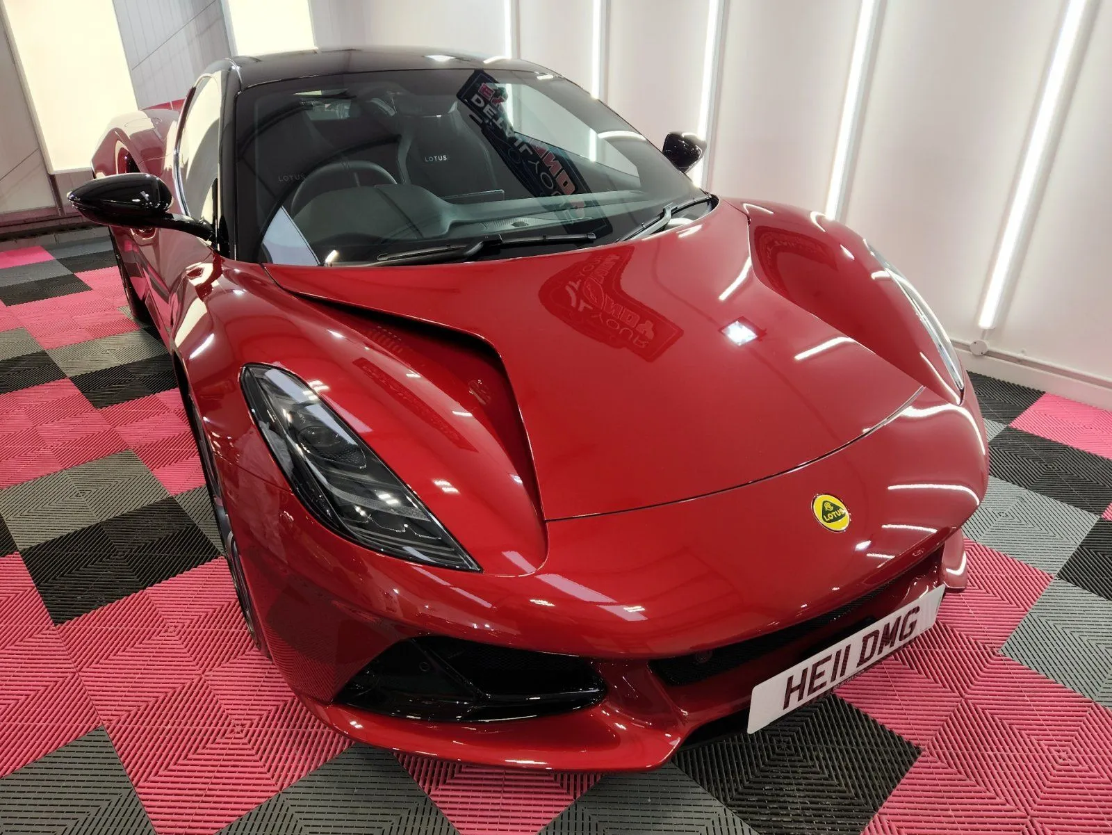

Photos of car at DETAIL YOUR EYECANDY after the work has been done!!
Unfortunately now it is home it doesn't look quite so good thanks to the horrid weather and the dirty roads!
Work done
  • Machine polishing process carried out to significantly enhance gloss and remove any defects (amazing how many light scratches Elliot found on a car which had only been collected from Factory and driven 5 miles home, not sure what this says for quality control at Hethel!)
  • XPEL PPF - Gold Package
  • Gtechniq Crystal Serum Ultra ceramic coating applied to all paintwork
  • Gtechniq Halo applied to all PPF
  • Gtechniq C5 Wheel Armour applied to alloy wheel faces
  • Gtechniq G1 applied to all glass
Highly Recommended
