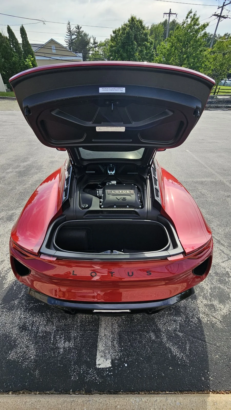

That's not quite the area I'm talking about. You can see the bit where it joins into the engine vent on the top of the boot lid, the other side of that. Where the water sits after it's been raining.

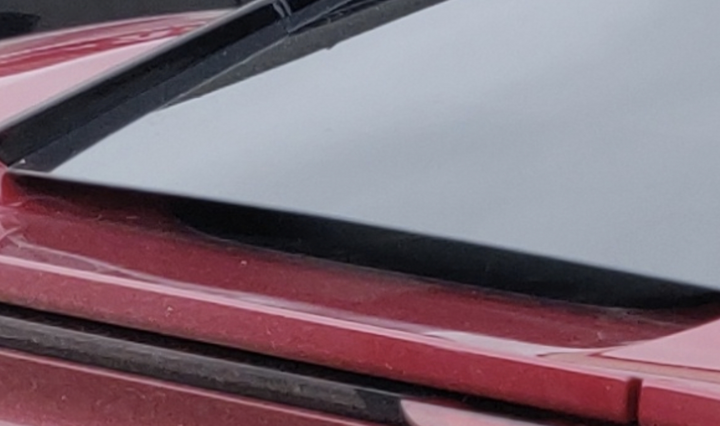

My i4 has privacy glass and is painted body colour (DV) under the glass, no black plastic finish like you're describing.
Pretty bad photo, but the best I could find from old pics in my phone! You can just about see where the body colour ends and the plastic begins under the rear window
I have the rough black plastic once you get fully under the glass, I also have privacy glass. Wonder if that makes the difference since you can't really see they body trim under that part of the glass
Mine is something like that. But the paint goes pretty far into the glass. No real concerns that you would notice anything off.
