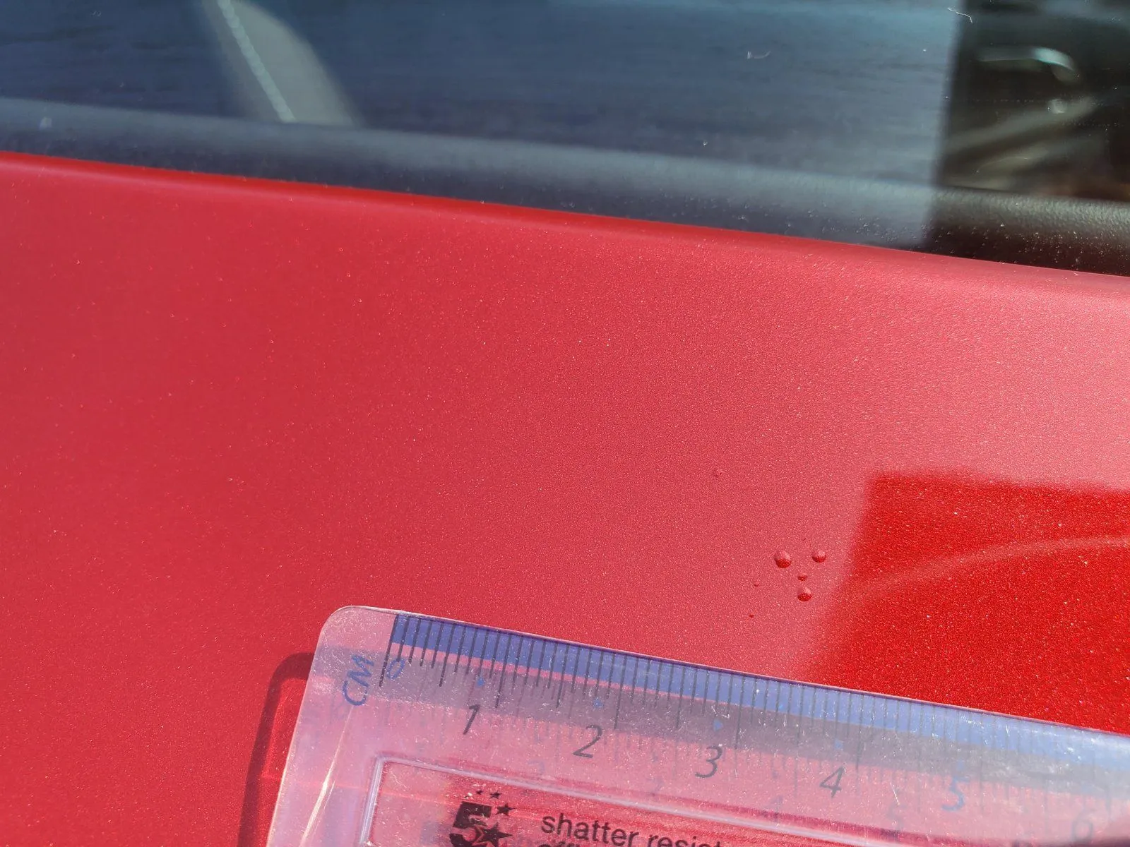

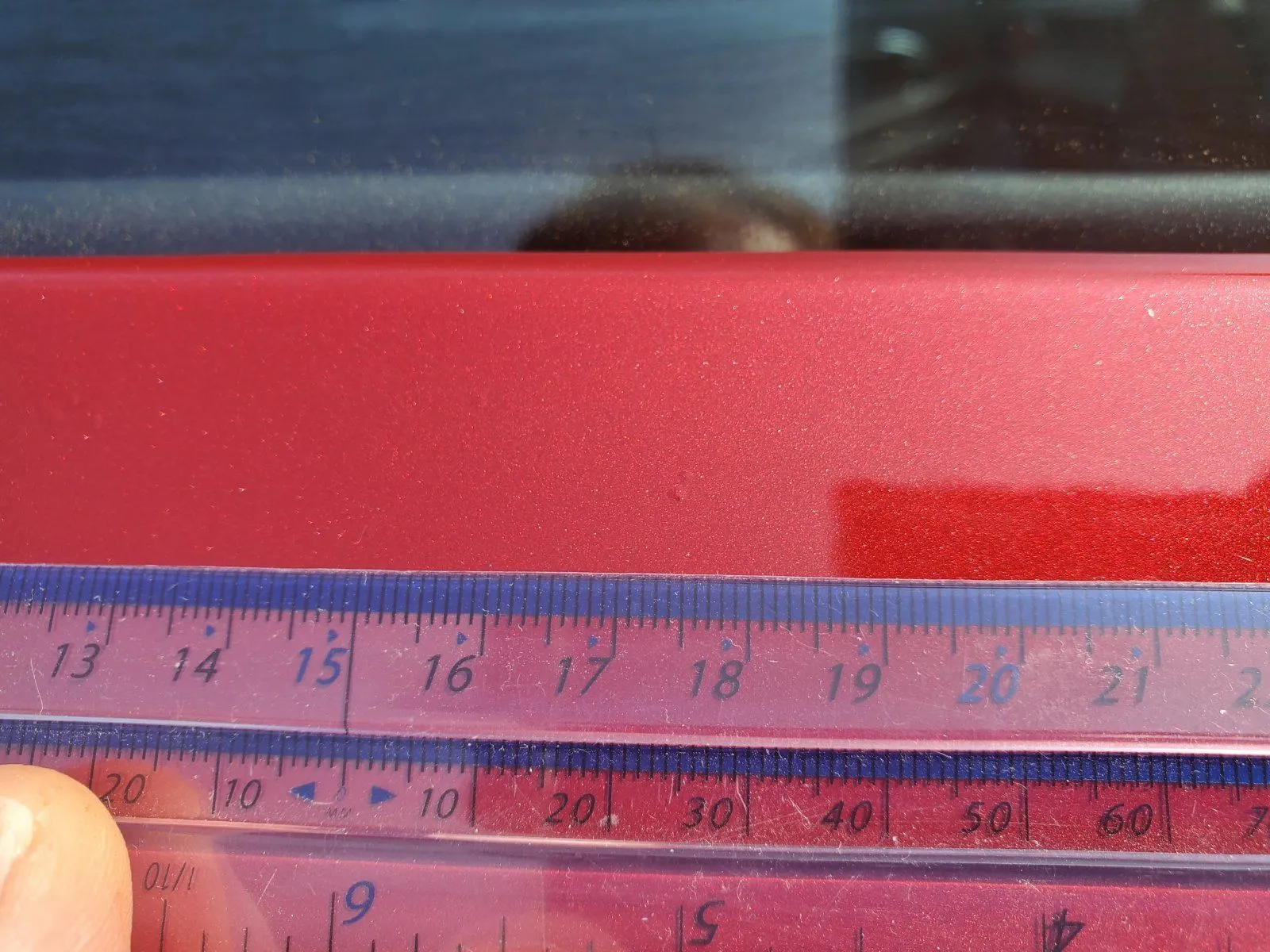

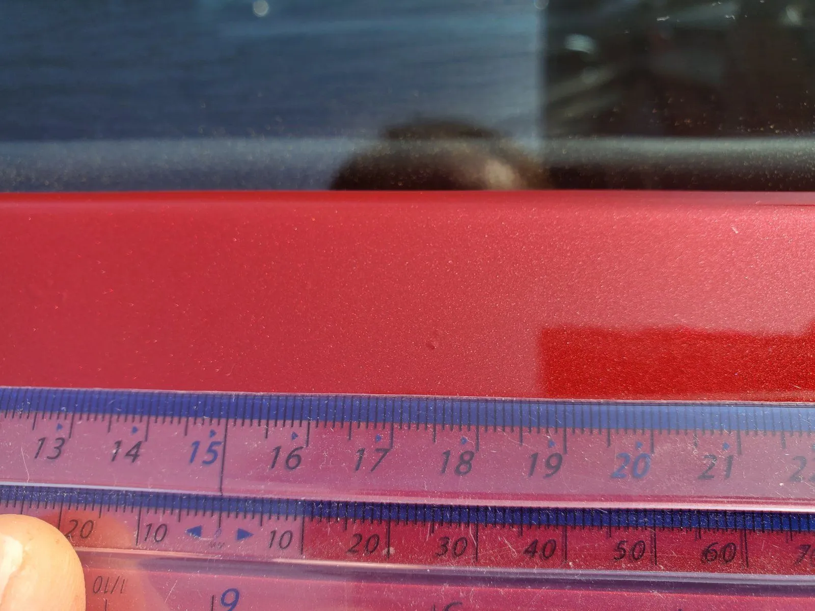

here is the original blister..... used a microfibre cloth to apply.. it was very small in the first place...
And here is photo now... you can see a small mark if you zoom in.. but that's it
here is the original blister..... used a microfibre cloth to apply.. it was very small in the first place...View attachment 42150
Definitely looks like othet people's photos of bubbles...interesting. Hard to explain why it disappeared. I can see the "after" mark you're talking about.

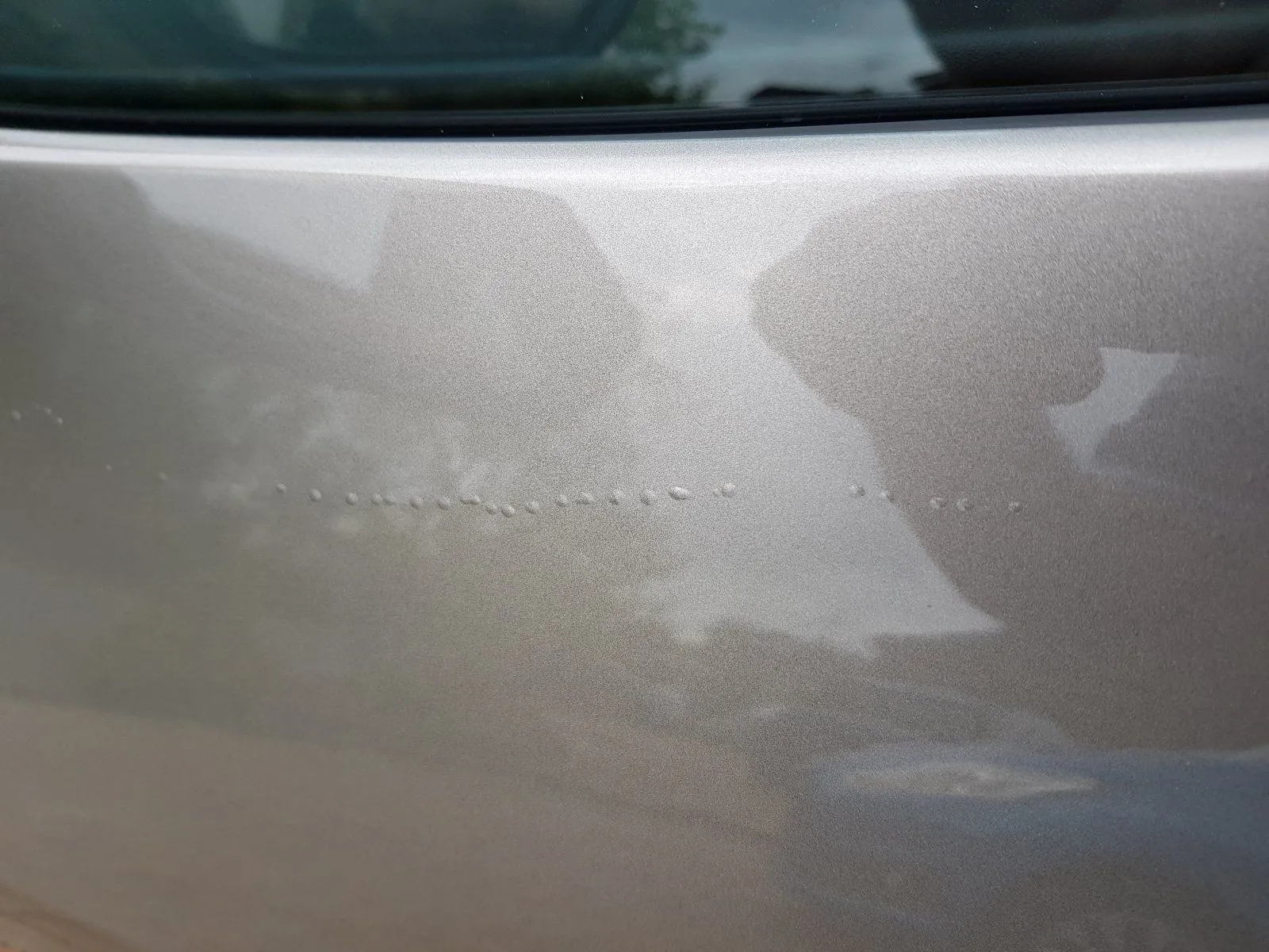

However today noticed I had a large umber of blisters across the top of the drivers door, some pictures below of my issue. Picked car up in March '23 so probably a 01/23 or 02/23 build.
There are about 16 - 20 small bubbles, some in groups others on their own - only across the top of the door

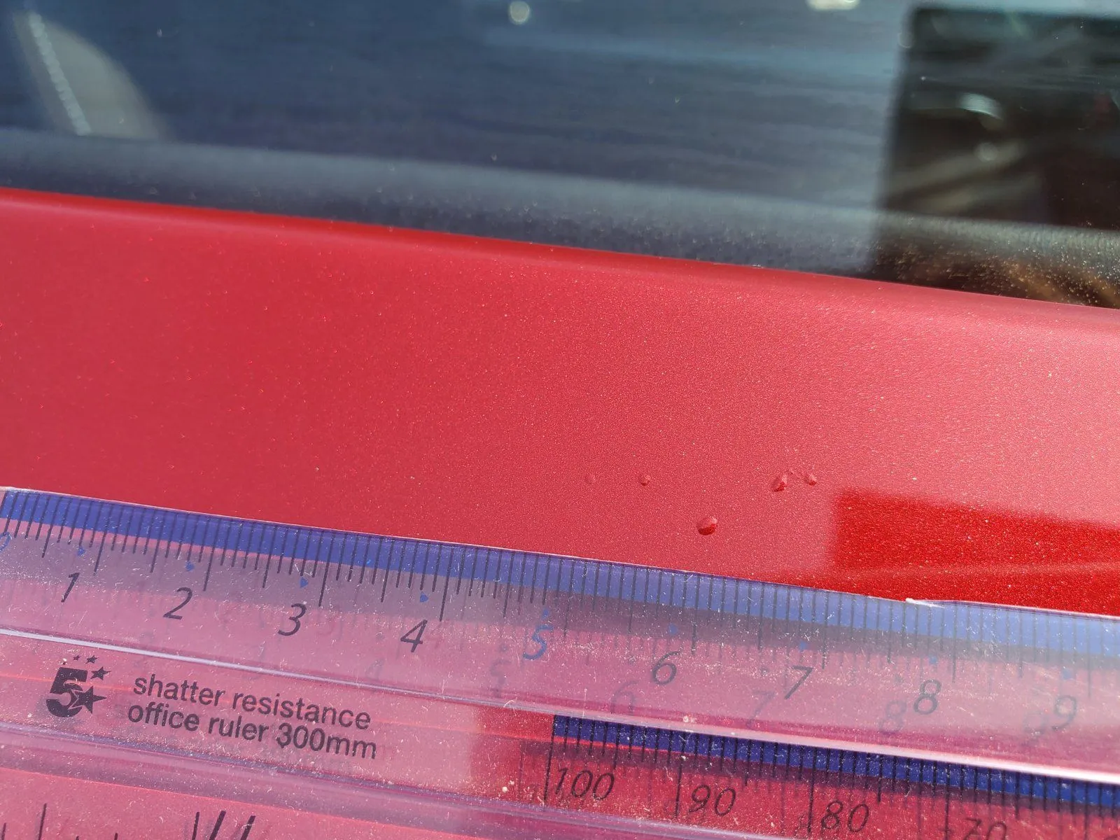

Another one with the paint bubbling. My car was delivered in April 2023, so I assume built in 03/23, poll above filled in accordingly.
Both doors and one of the rear quarter panels affected, all will need replacing. I noticed this last week after washing, it was strange how they all appeared at the same time. Nothing unusual weather wise, car is parked on the drive as it always has been. Local service centre advised long waiting times for parts currently, they are very familiar with the issue.
Photo is the passenger door which is the worst affected currently.
Also advised Lotus Customer Care by email, just to keep a written record.
Will update this post as appropriate for the benefit of others searching for info, but I don't expect this to be anytime soon!
