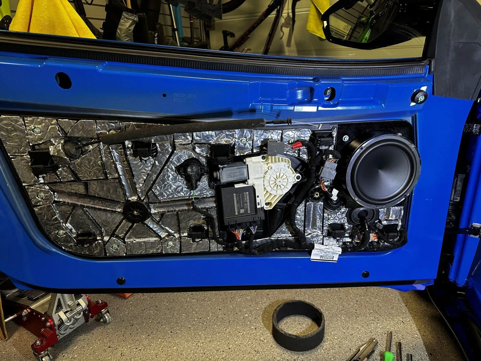

I suspect this is caused by water inside the door, even if only a tiny bit, then the door absorbs it into it’s unpainted surfaces… after warm/cold day fluctuations the water evaporates and tries to escape wherever it can in a gas form. Causing the bubbling on the painted side if it can’t escape any other way. I wonder if leaving the windows rolled down on a hot day would help the water evaporate out 🤔

Following this train of thought, and besides keeping the drain holes clear (or drilling more!), I wonder if sploshing something around inside to seal/waterproof the inner skins of the doors would help 🤔
An aerosol spray may work better for this purpose. I think whatever waterproofer you’d have to use would need to coat ALL unpainted surfaces within the door. Otherwise, it’s possible some water will evaporate, can’t find its way out as a gas, then turns back into a liquid as condensate when temps cool. This could then absorb into the upper part of the unpainted door. After baking the door in the sun for a couple days, if you could basically set off a waterproof aerosol grenade in the door that would be ideal imo.

Any sort of waterproofing measures would need all of this taken out along with the glass. Not sure if the composite door panel is glued together or not, but doing this type of thing wouldn’t be for the faint of heart.
Could I just throw big bag of silica gel in there to suck up the moisture?! Make it part of the routine maintenance to swap out the bags every so often? 😉😅🙃

How difficult is removing the door cards on this car? I wonder if it might be prudent practice to pop them off after a drive in heavy rain, in order to suck any moisture out of the bottom of the door with a wet-dry Shop Vac.
Someone enterprising should invent quick release clips for the body panels of the Emira so that they can be taken off the car after a day of driving and hung on a rack for drying, maintenance, and inspections.
