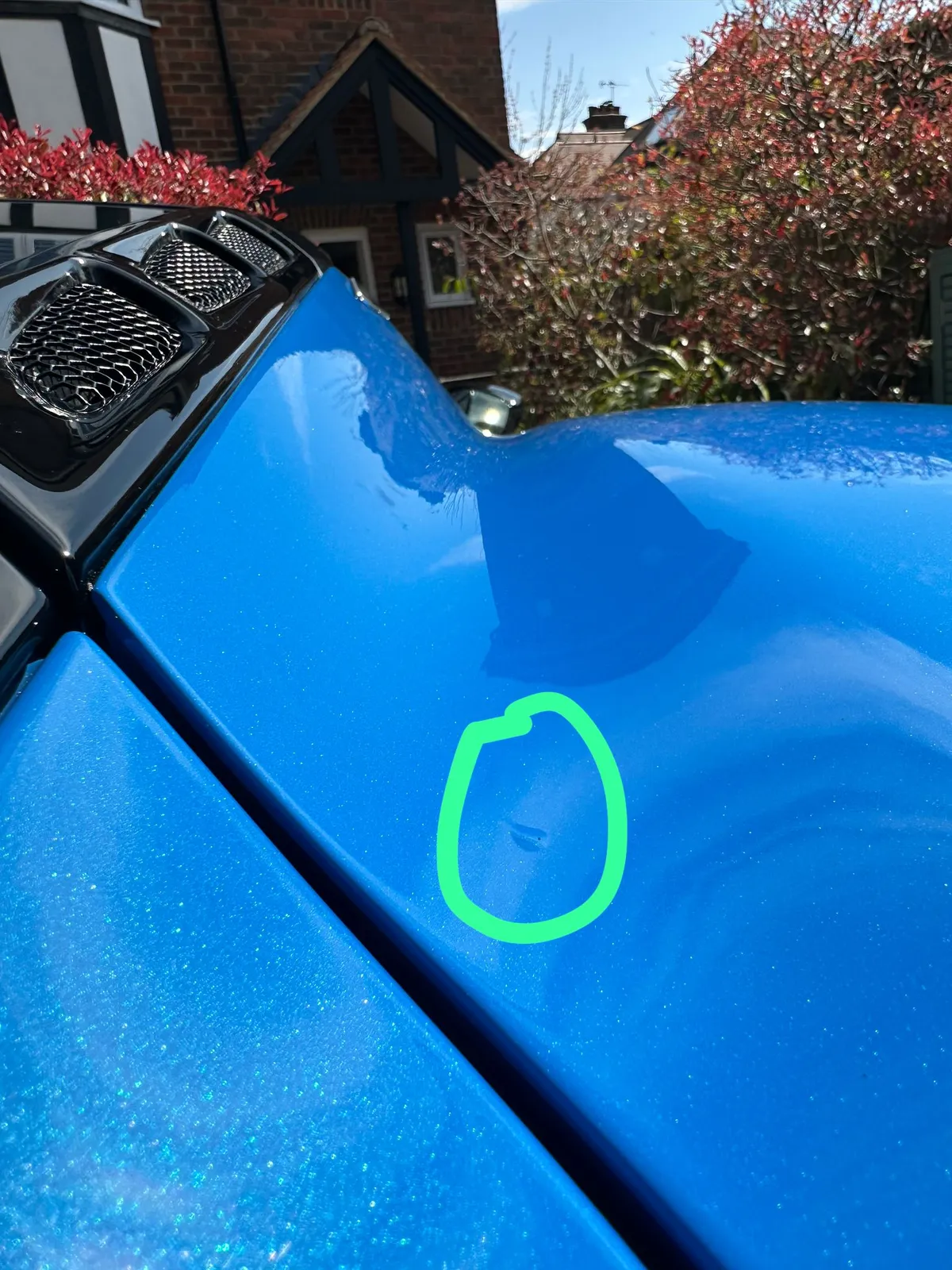

Well I spoke to soon, washing the car today and noticed there’s also bubbling on the clamshell/ rear panel.
Only on one side at the moment, but I feel like it’s incredibly likely to happen on both.

I'd keep a very close eye on your doors. Teijin Automotive made the doors, the rear quarters and the clamshell. You've already got blistering on 2 out of 3, so clearly there's an issue with the batch of composite panels used in your car.

I've got that exact bubble about 8" away on the tailgate, dealer notified Lotus so waiting for a new one.
