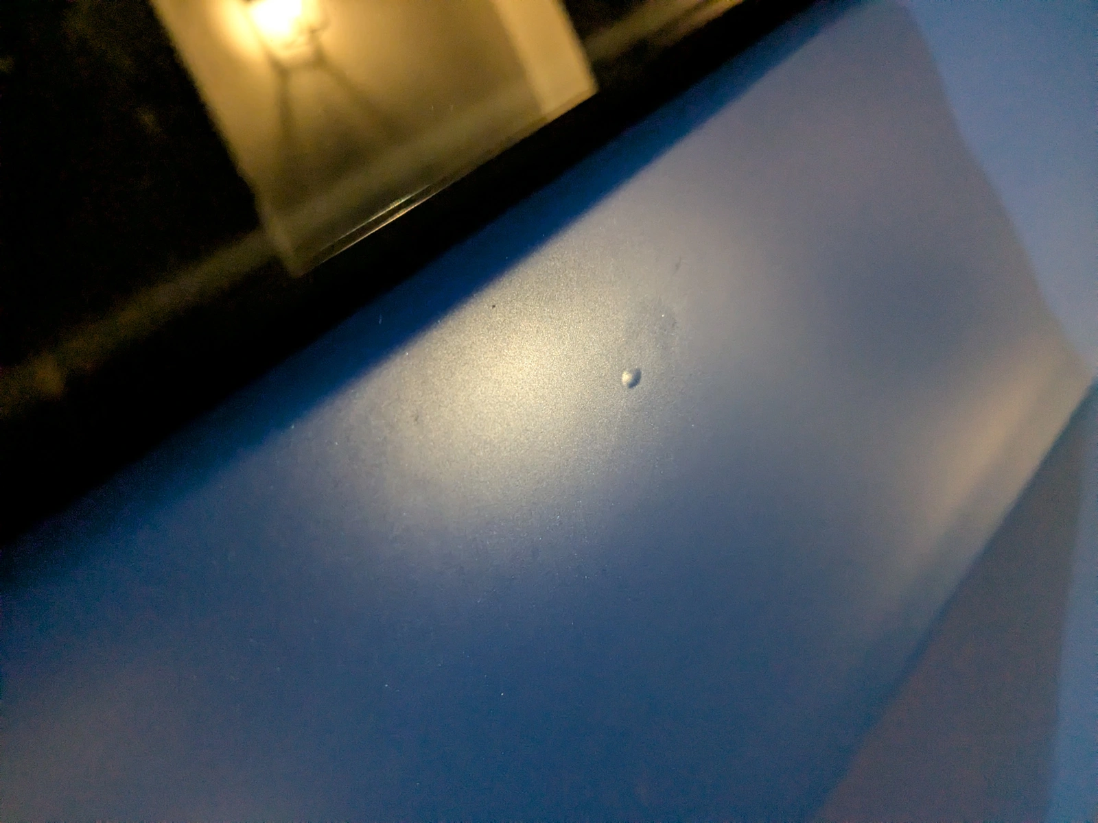

Taking the garbage out, walking past my car, and am greeted with this.... nooooooo! 🤦‍♂️
And so my warranty journey begins...
Ugh, that sucks, sorry. If you don’t mind sharing, when was the car manufactured, and do you normally keep it garaged?
Yeah, cheers. I'm taking it pretty calmly... had two years to mentally prepare for this 😅
Mine was a Feb/March 2024 build. I have left it outside in all weathers, like you would any car, and washed it on average every few weeks (more when it was warm out, less so over winter) by hand / low pressure hose.
I kinda sorta wanted this to happen within warranty if it was going to happen, and so haven't been babying things, but still a rude surprise when it did pop up... nothing, nothing, and then bam.

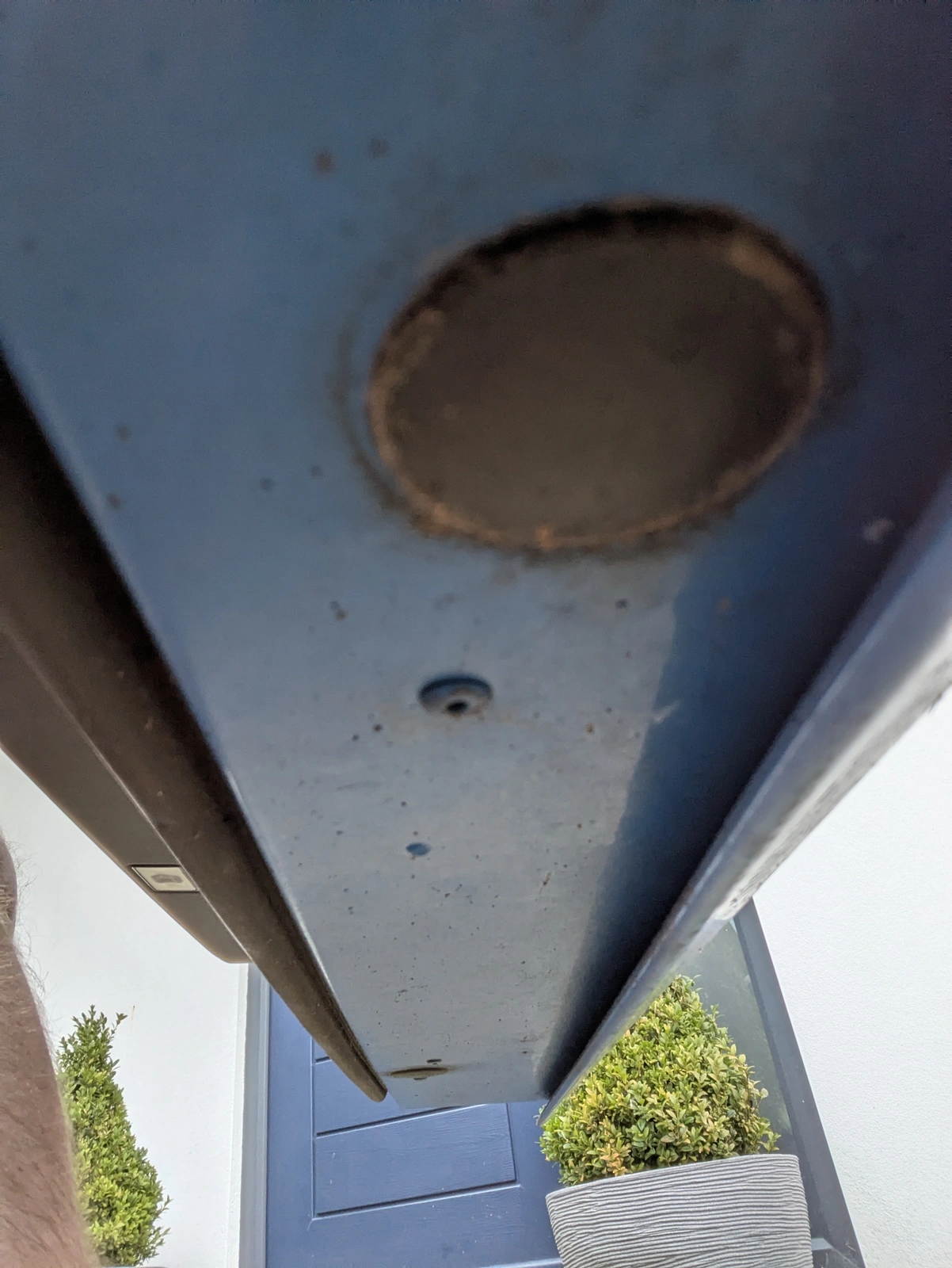

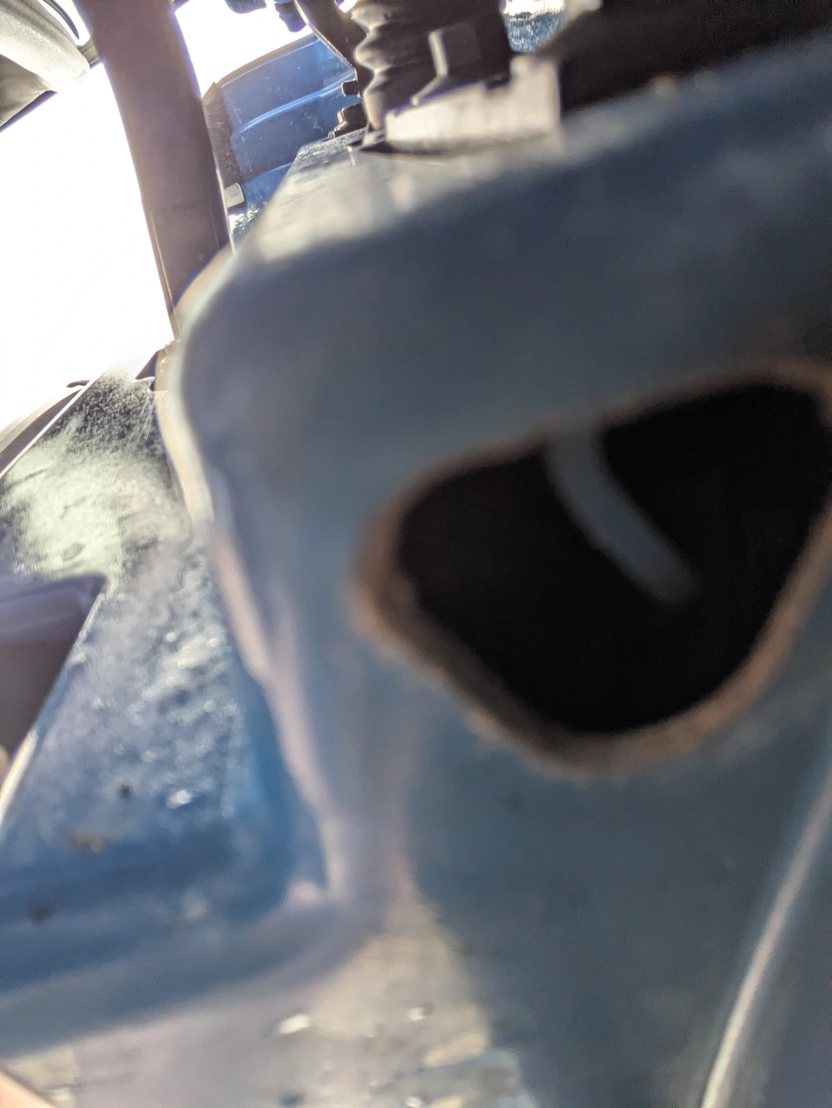

For those tracking door design differences, it seems to have the expected holes, but I can't tell what the interior is like:
Could you explain a bit more about the door holes? I haven’t read anything about that. Thanks
Depending on the door revision there are different numbers of drain holes on the bottom of the car doors.
That sucks, especially since it's PPF'd. :( You got your car with Woodcote & Copse (Silverstone), didn't you? Hopefully they are as good to you as they were to me.
