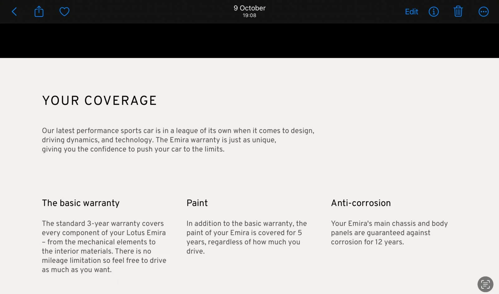

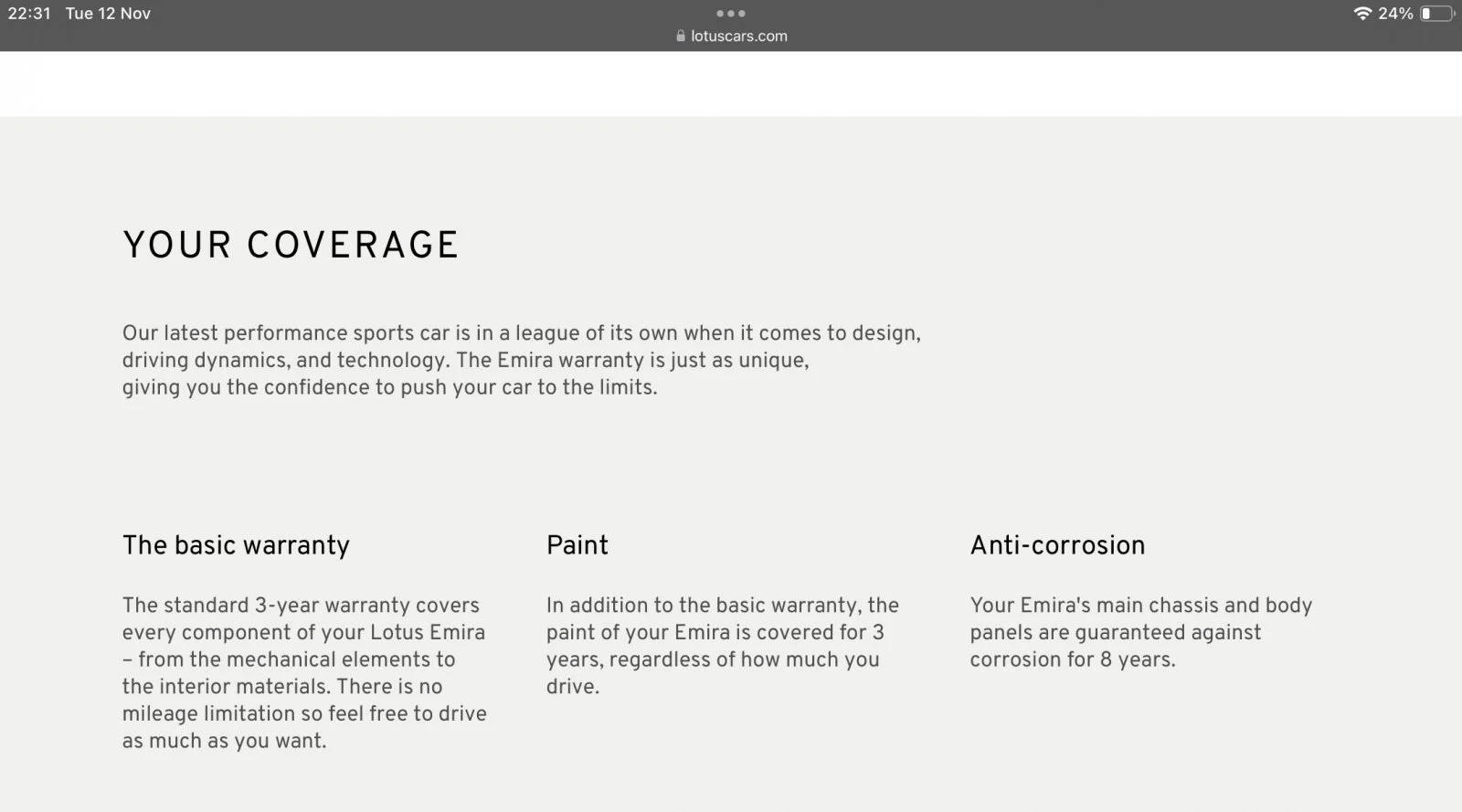

I thought the paint warranty was 5yrs for most cars up to now, with Lotus recently reducing it to 3yrs for only recent/future cars
They cannot legally reduce the warranty of cars that were sold with the 5yr warranty, before anyone asks
The official line from Lotus is that the warranty has always been 3 years and the 5 years clearly stated on the website for over two years was a 'mistake'. Yeah, right. I strongly suspect this is just cynical backtracking due to their soaring warranty costs. I've no idea about the legality of this stance but it is clearly completely unethical and I hope it is open to challenge in court.
100%. Here are my screenshots of paint warranty I’m not sure when the actual date changes were. But 9th October 2024 was still 5 years
100%. Here are my screenshots of paint warranty I’m not sure when the changes were.View attachment 58294View attachment 582952 days before CS & Escalations got back to me on the matter. I laid out that 5 years had been on the site since they began taking deposits and formed part of the contract with customers. If they had sold via their dealership network they could get away with the 'mistake', I agree the change is due to the warranty claims so far, as it would have been the duty of dealers to inform of warranty periods. The fault was in manufacturing, and under English law faults up to 10 yrs could be pursued through litigation, not saying they definitely would win, I informed Lotus of this and I was told it was being discussed at the highest level, including the legal department.
I believe that all cars registered before the change are entitled to 5years and all registered after are 3years. That’s just my personal opinion based on fairness.
Which is what I said to them, any new purchases get 3 yrs but those who have paid a deposit get 5 yrs.
