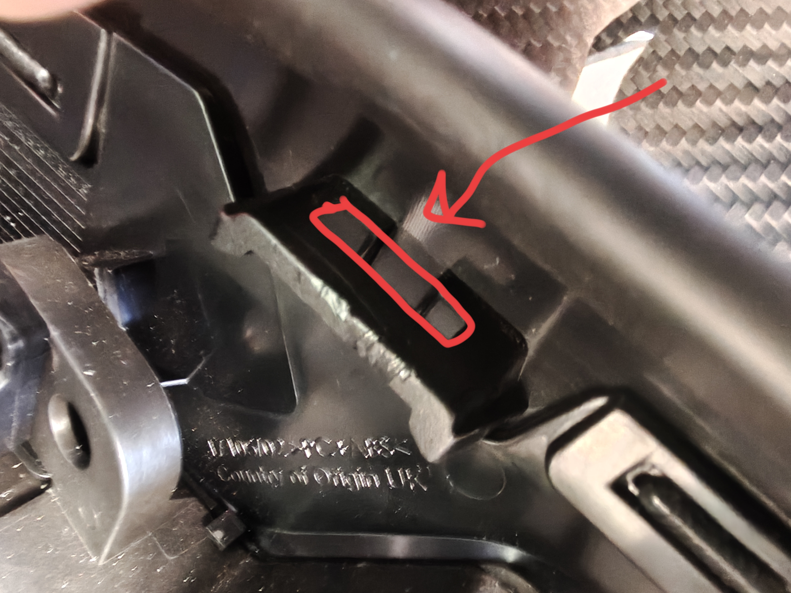

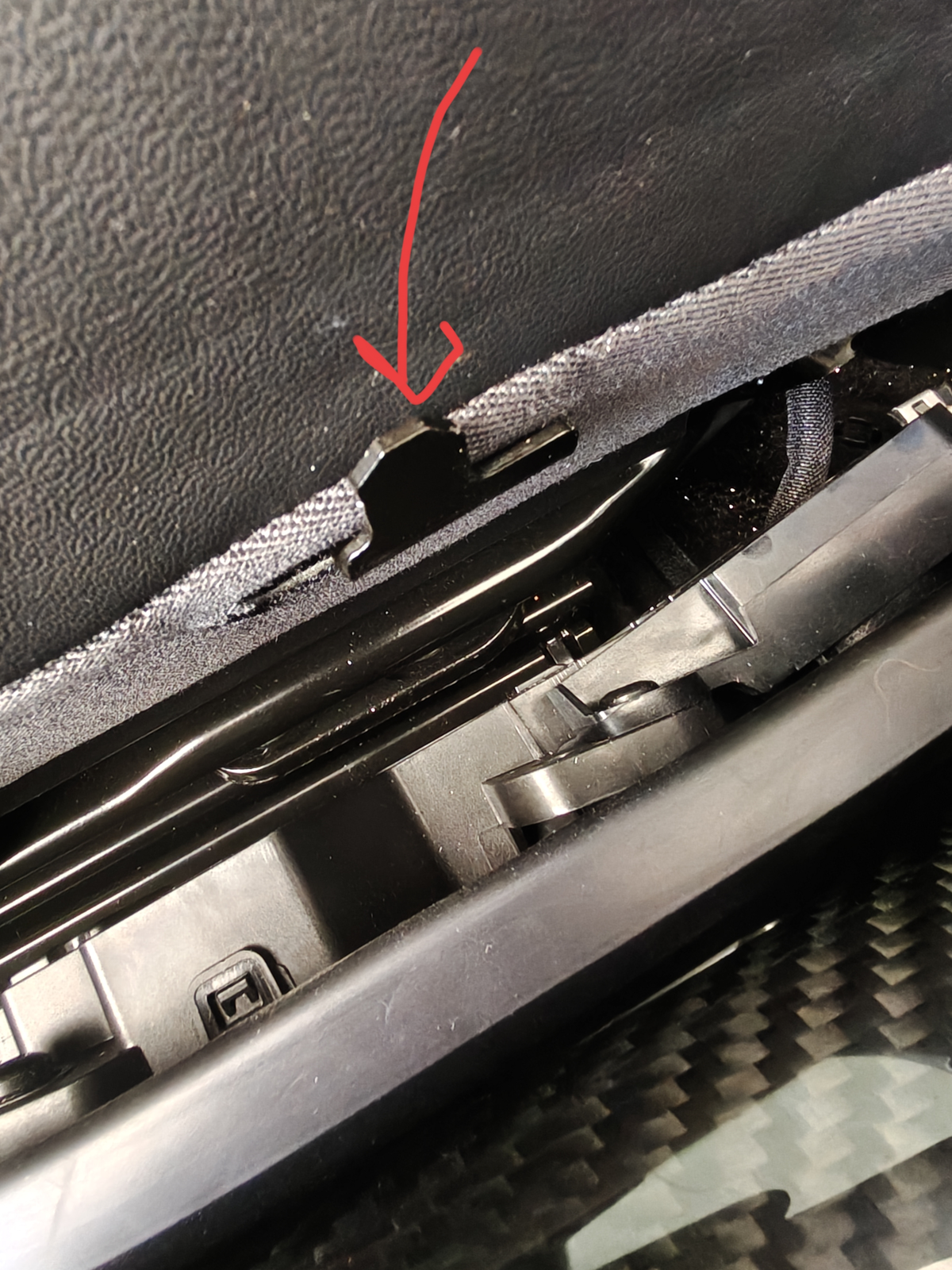

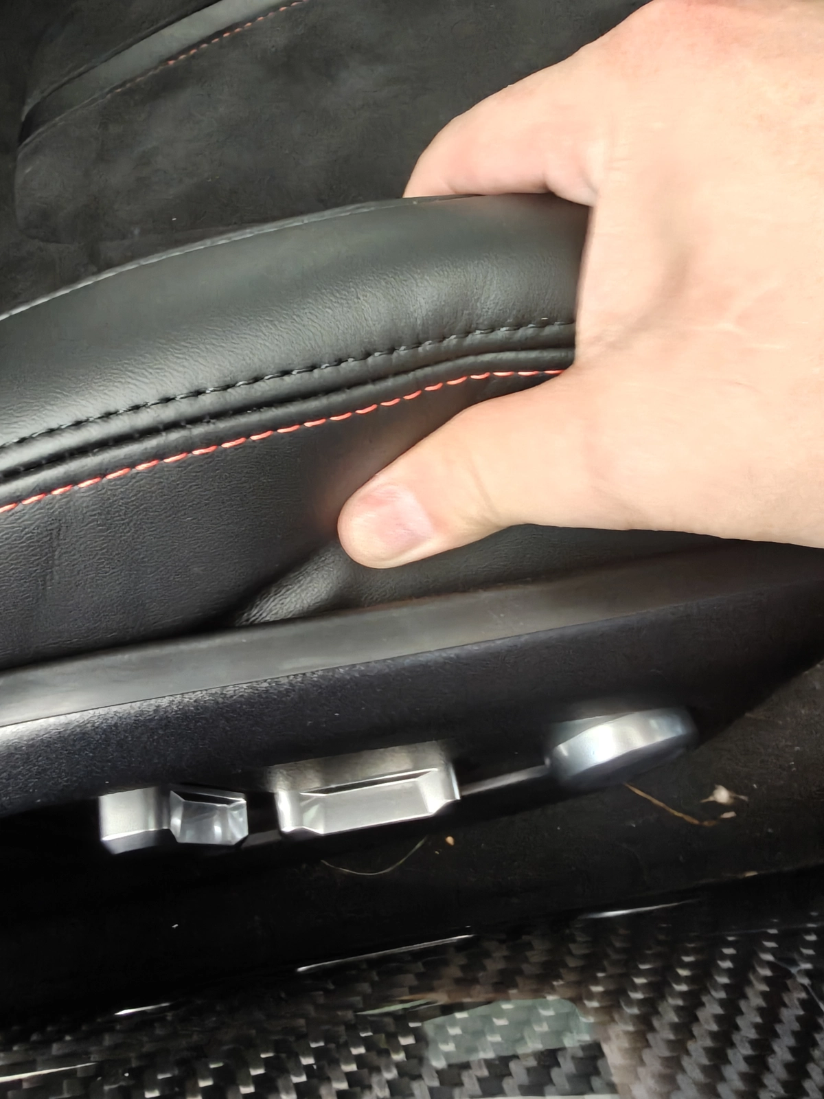

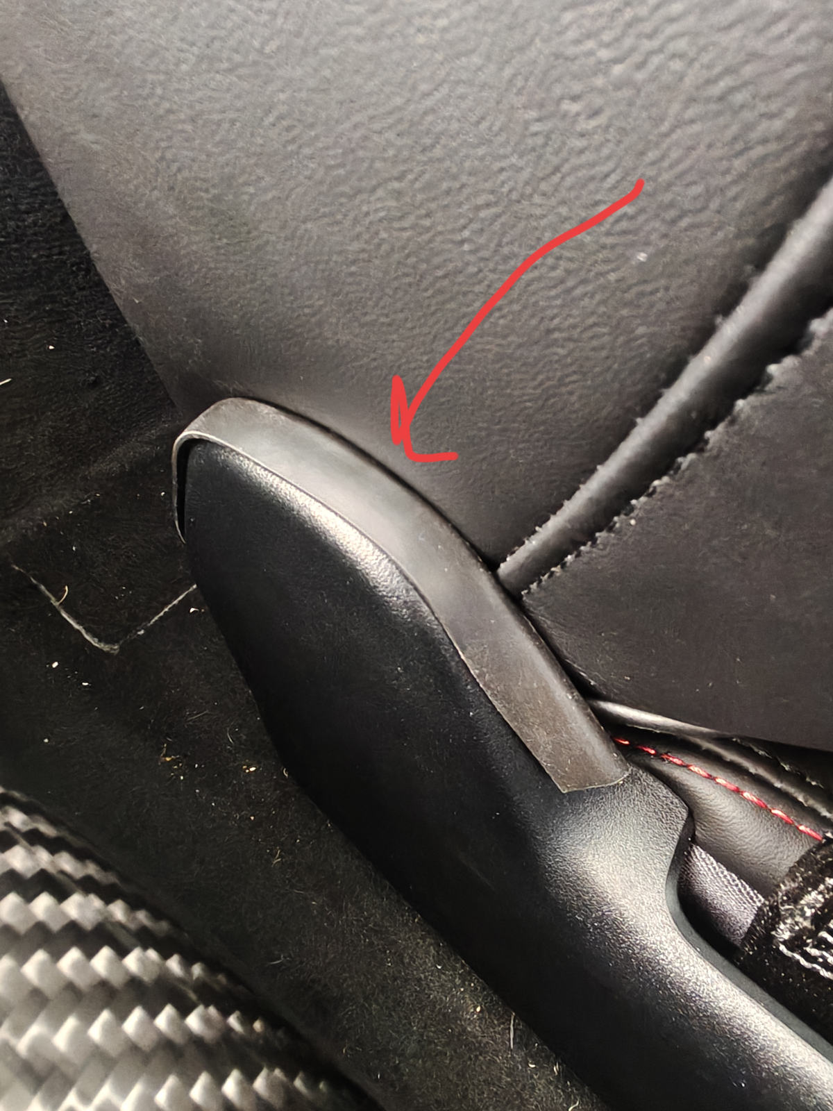

Since I was working on my interior mood lighting today, I thought I would snap some pictures of the side seat panel and why it may keep popping off. I know people have been describing it but I thought I would post some pictures to help illustrate what is happening.
Before engaging the 3 retention clips at the front, middle and back ends, you have to be sure to insert the metal tab on the seat side with the plastic slot on the panel side, both on the front end as well as the back end. It is not a direct panel placement and slam the clips in. You have to push the seat cushion in first with your finger, slide the panel from the top side inserting the tabs in next and then slam in the 3 clips. If you don't insert the metal tabs, your panel will keep "popping" off.
First, push in the seat cushion with your finger to better expose the tab.
This metal tab on the seat side...
...need to be inserted in this slot on the panel side...
...on both the front end (pictured previously) as well as on the back end of the panel and at seat reclining hinge.
This is what netzinah and others have been describing to get a right fit on this seat side panel. I hope this helps.
