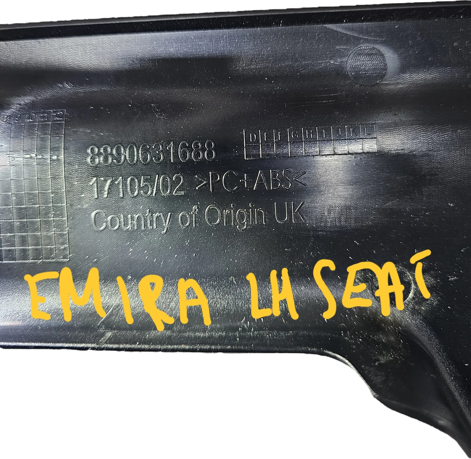

This just happened to my LH drive, passenger side. Can someone just post a link to where we can buy a replacement part online without having to deal with the dealership?
I'm not a carbon fiber fan but someone needs to carbon fiber this side seat trim piece ASAP. I also vote for a 3d printed STL for this if anyone is that good. I'll print them and ship them if someone can get me the STL.

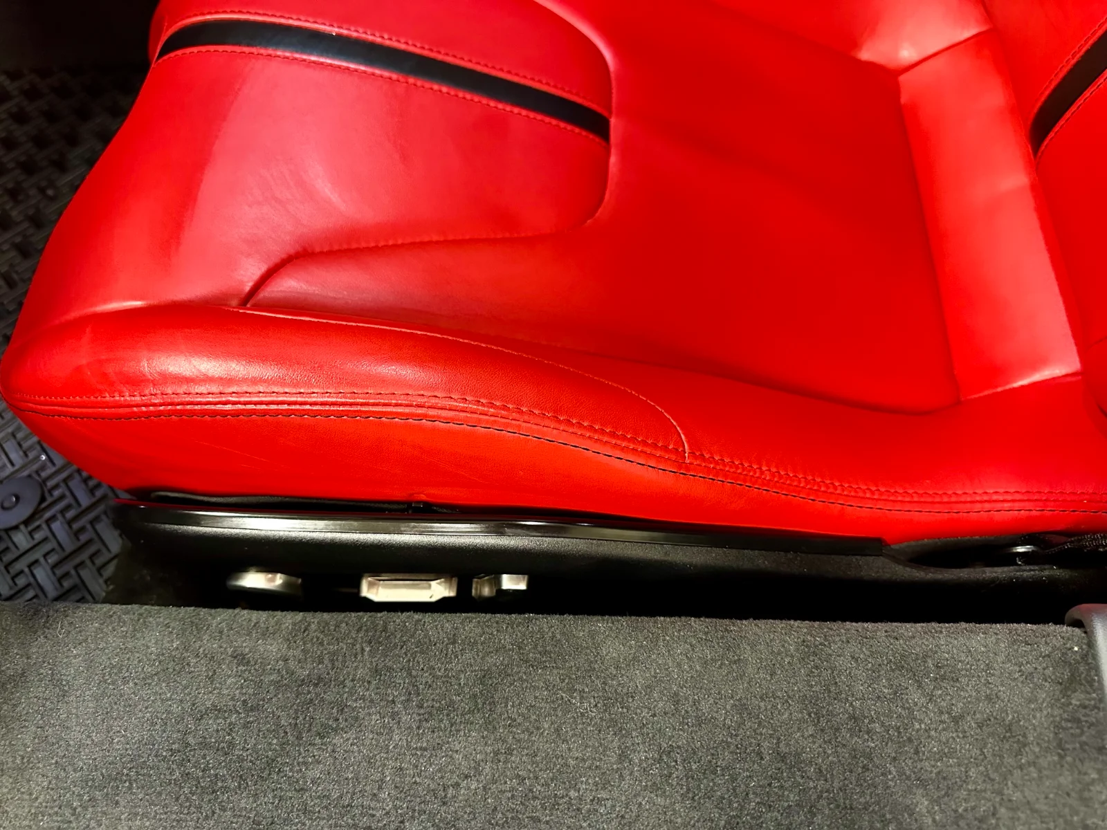

My dealer noticed this in my car when it went in for a service.
Reason is happens is if you put weight on that part, say sitting above it as you go to get out, you break a clip. I had noticed a few times a noise when I went to get out of the car, but then sat back down on top of the edge of the drivers seat. I had assumed it was the stripping I had placed there to protect the part from rubbing against the leather. Yes, the part needs a redesign to stop the plastic clip from breaking.

I think why it is happening is as you get out of the car, if you don't get right up for your driving position, your butt and weight are on top of that plastic part, and it breaks. Lotus will have to come up with a more robust cover because this will eventually happen on most cars. Unless you make sure not to put any body weight getting in or out around the side of the driver's seat.

I can confirm you are right re one's arse putting weight on the lower seat side bolster, which in turn puts pressure on the plastic panel. Where I used to work we drove a lot of BMW X5s and Volvo XC90s and it used to happen ALL THE TIME to them. Mainly the Volvo's TBH. Caused exactly how you said. Just have to be mindful of where and how one puts ones arse!! 🤣🤣
Anyone figure a way to fix this without ordering a new part (which will just break again)?
