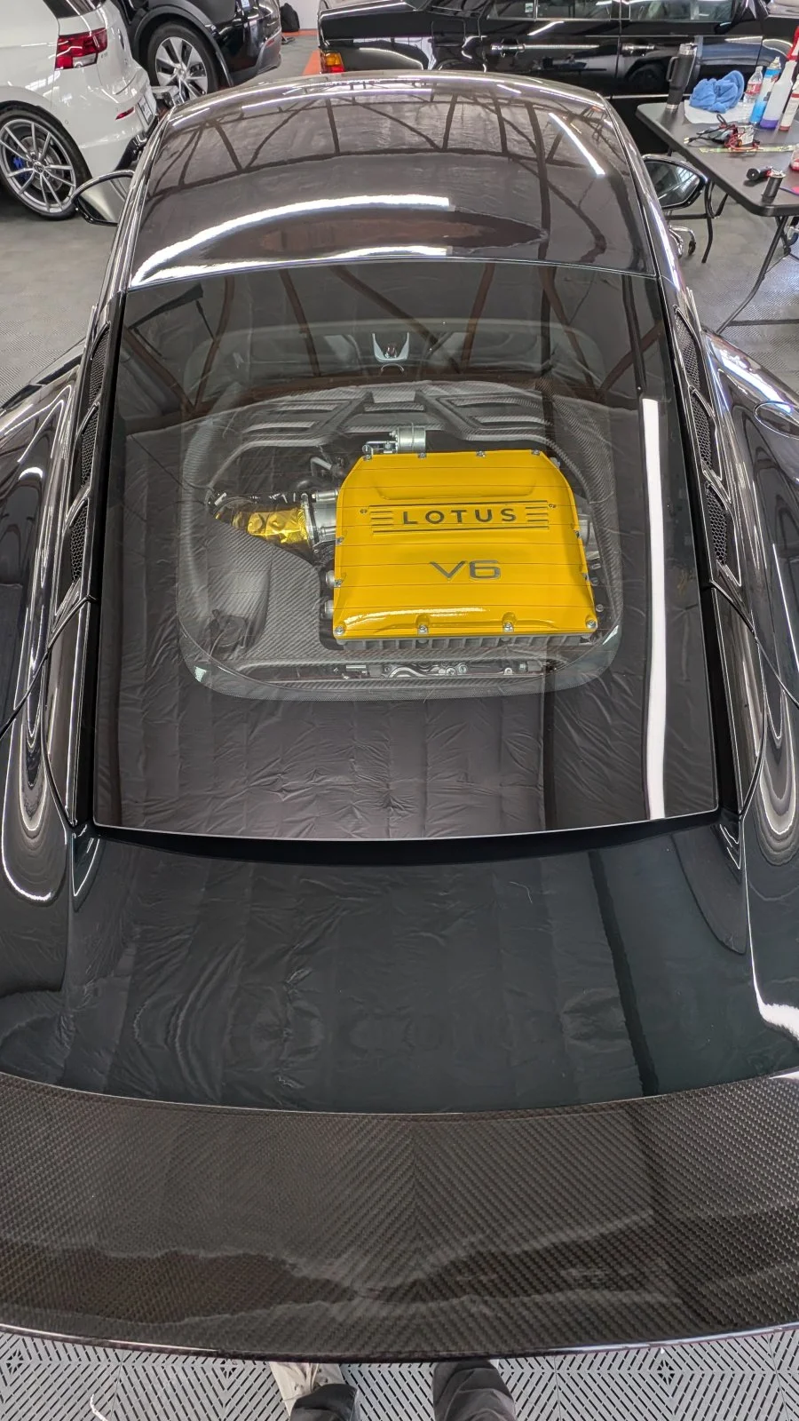

Prismatic Powders Trapper Yellow. Almost perfect match for Hethel Yellow. It is not textured. PP may be able to mix you some that is, but this is pretty glossy. Doesn't detract in the mirror though.

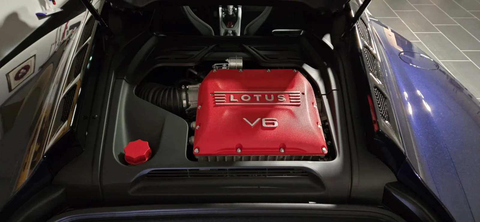

My local place said for warranty purposes I needed to have the exterior blasted (instead of dipped) to protect the coating on the interior, and to use a new gasket. Don at Auto Europe (Lotus of Michigan) got the gasket for me. $67
I had the top taped off like stock to keep the bolt locations clean, and the V6 brushed clean to make it look like the =LOTUS=

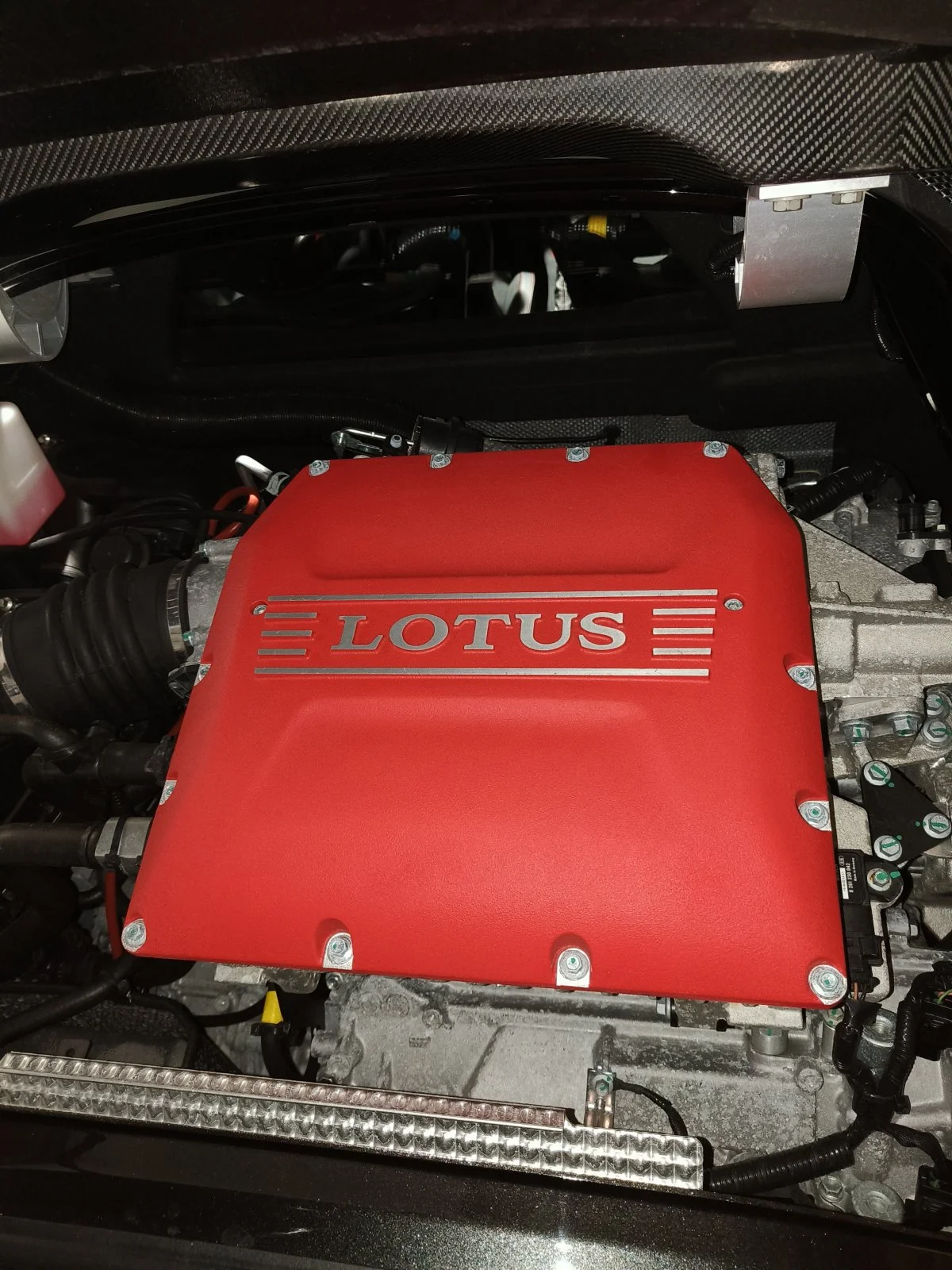

For my new 2021 Evora GT410 Sport IPS I did the same with aerosol spray paint cans..........
Previous factory Black wrinkle paint cover........
Vehicle Hood Car Automotive design Motor vehicle
Red wrinkle paint sprayed cover after 3 years car use........
1) Unbolted / took off the cover ......the steel / plastic gasket can be reused conform the Lotus importer.
2) Sanded the (black) cover slightly between the LOTUS trade mark and the rest of the cover with a kind of "scotch-brite" sanding pad
3) Cleaning with brake cleaner fluid
4) Several layers with red wrinkle paint VHT SP 204......also over the Lotus trade mark
5) Baked in kitchen oven 1 hr at 110 degr. C.
6) Carefully scraped off the still soft paint off the Lotus trade mark with a kind of wide Stanley knife blade; works asthonishingly easy and clean, without scrapes.
7) Sanded / polished the blank aluminium with min. 400 grit paper on flat block sanding hand tool
8) Several layers of 2 component (2K) matt clear coat.......the Lotus alu trade mark now is covered against corrosion and the entire cover better against moisture; wrinkle effect remains.
PAINTS:
1) VHT Wrinkle Plus™ Coatings -- High Heat Coatings
2) Eastwood 2K Aerospray Clear Coat Matte & High-Gloss (MATTE FINISH !)

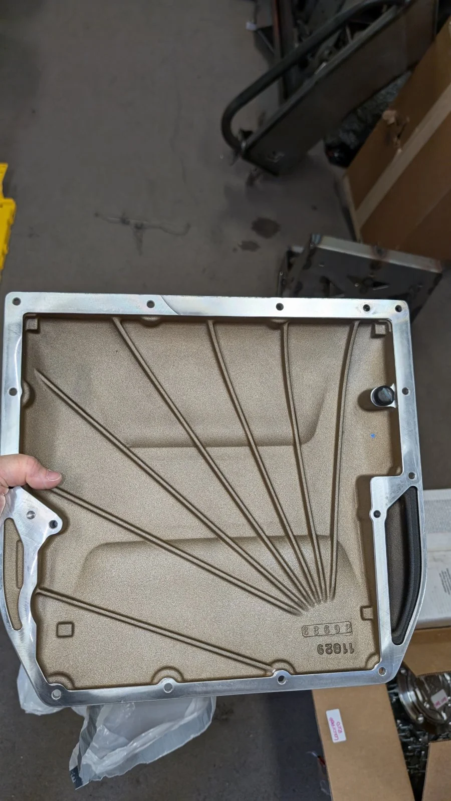

I mentioned this before but since we're resurrecting the thread, make sure you get the top media blasted to protect the coating underneath. My dealer told me removing the coating would void my warranty.
Just for clarity here. Media blasting apposed to some kind of paint stripper dunk tank.
That way the top paint can be removed without affecting the "inside" coating.
