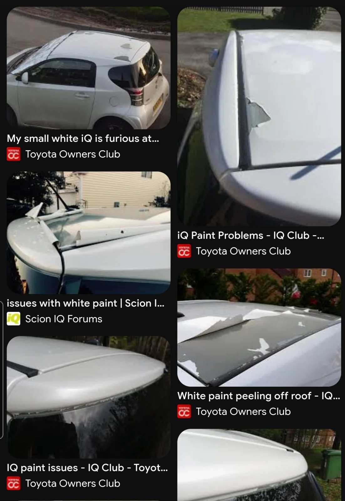

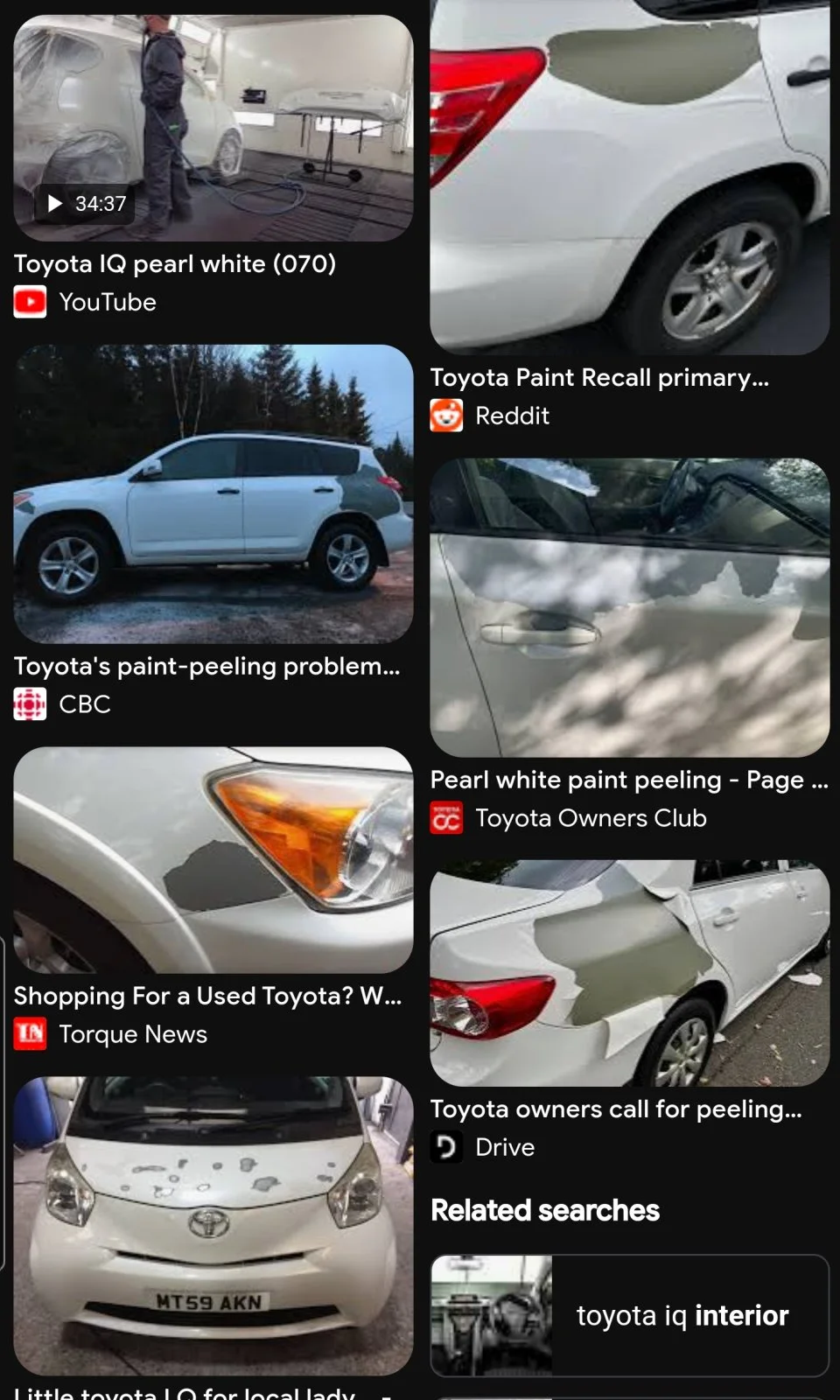

I've posted on another thread how my daily, a Toyota IQ/Scion, had a similar problem. White pearlescent painted cars of 2009 had an incorrect base primer applied that resulted in paint bubbling and lifting. The difference being it took about 7 years for it to come to light. Pics attached. Toyota US resprayed, Toyota UK said tough unless you'd always had the car serviced with them. The panels were steel not composite.

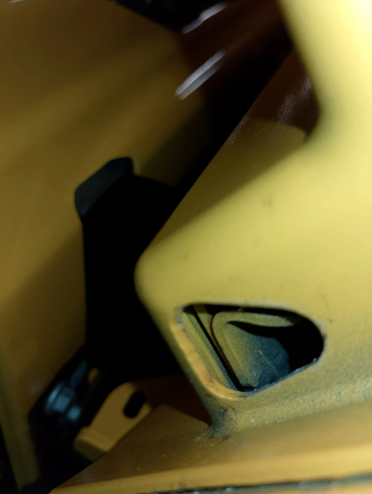

The only way I could "easily" tell was to fully open the door and look at the drain hole at the very front bottom. By shining a light into the hole you can just about see the primer. On my 1st November 2023 build car it looks like it's the darker blue/black primer. 🤞
You may be able to see something (as the poster of that other post said) if you look down through where the glass goes but I couldn't.
Has anyone with an older build date confirmed the primer inside the drain hole has a different look than the pic above?
Thanks. I just looked at mine with a torch and mirror as far as I can see it looks black/dark inside. Mine left production 14th June 23. So perhaps just on the cusp of when new doors were fitted. But there are reports on here of blistering issues after that date anyway.

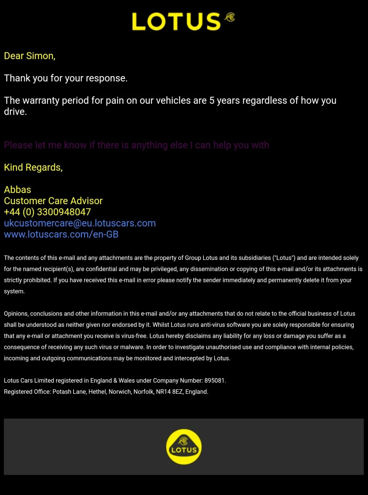

Just had this back from Lotus CS, confirmed 5 yr paint warranty. Pretty difficult for Lotus to get out of an employee working in customer service confirming the warranty.
Freudian slip: "warranty pain"
Warrantee for pain ?:LOL: I guess that covers anything that can go wrong...
Just what I was going to say!
Lotus CS need to get their story straight. I asked about this a couple of months back, they went away and consulted their warranty department who confirmed 'definitively' that the paint warranty is 3 years not 5. This type of inconsistency from Lotus CS is maddening. I am going to ask them again.
That email above from CS is quoting the Lotus website:
3 year paint warranty in the US and 5 in the UK is my understanding.
