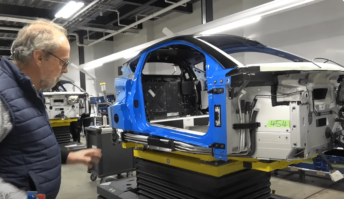

Guys, this isn't a unibody car. Every panel on the car other than the roof (and A/B/C pillars) are a removable panel.
When Lotus paints them, they do it on a metal stand, as a set. They don't paint them on the car. They bolt the finished, painted panels to the car after they're painted.
Now, that's a lot of work... there are a lot of electronics, trim, plastic bits, etc that have to be attached to the body panels once they're installed on the car, and it's labor-intensive, expensive work. So I get why they would be resistant. But still, it's not the same as a unibody car that has integral panels that can't be unbolted. On the Emira, literally the whole exterior skin below the windows is a bolt-on.
For example, here's a blue car in mid-production, with the upper black pack. Note the roof and A pillars are already painted and installed permanently (bonded) on the hoop structure. Even cars in a solid color are done this same way, which is why sometimes the A pillar and the fender aren't an *exact* match to one another. All the body panels are hung on the car after this, and they don't paint the whole thing together. Every system on the car would end up with paint on it, which obviously isn't happening. The panels are pre-painted as a set on a painting jig, cured, and then installed as a set.

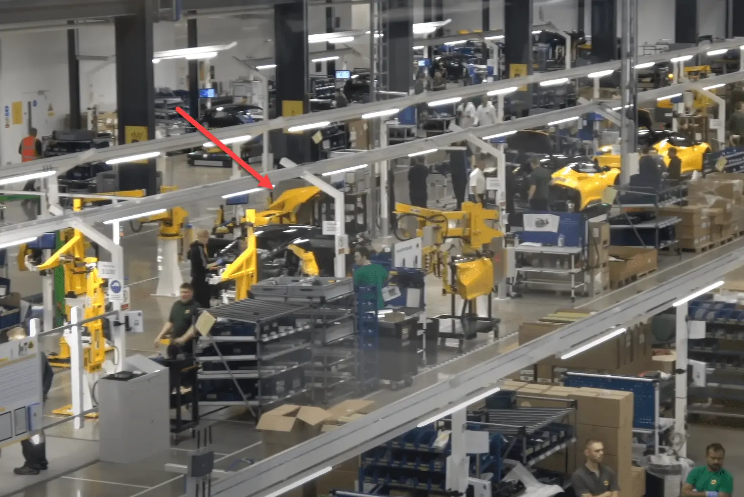

And here's a still from the video, showing the step in the production process where they're actually hanging the painted panels on the "bare" car. I've drawn an arrow to the rear left quarter panel on its stand, ready to be installed.
You can see the car that's further forward in the line already has its panels on, but the one they are working on does not.
