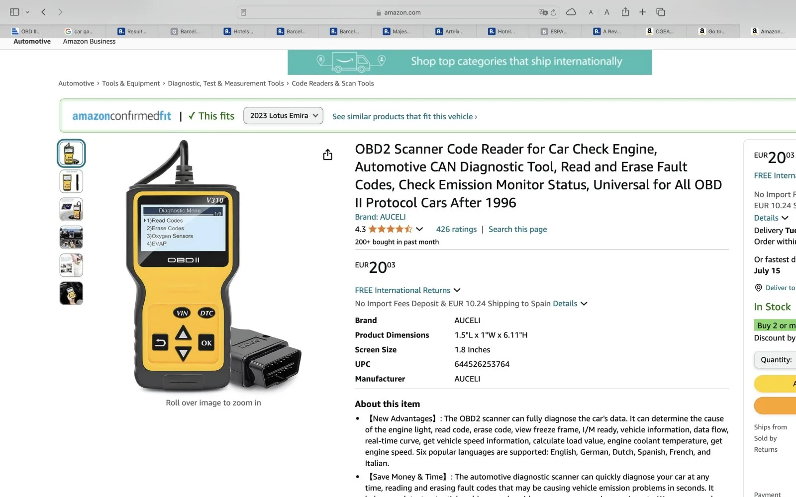

Got this one, cheap and works perfectly for reading and deleting codes:
here is the link:

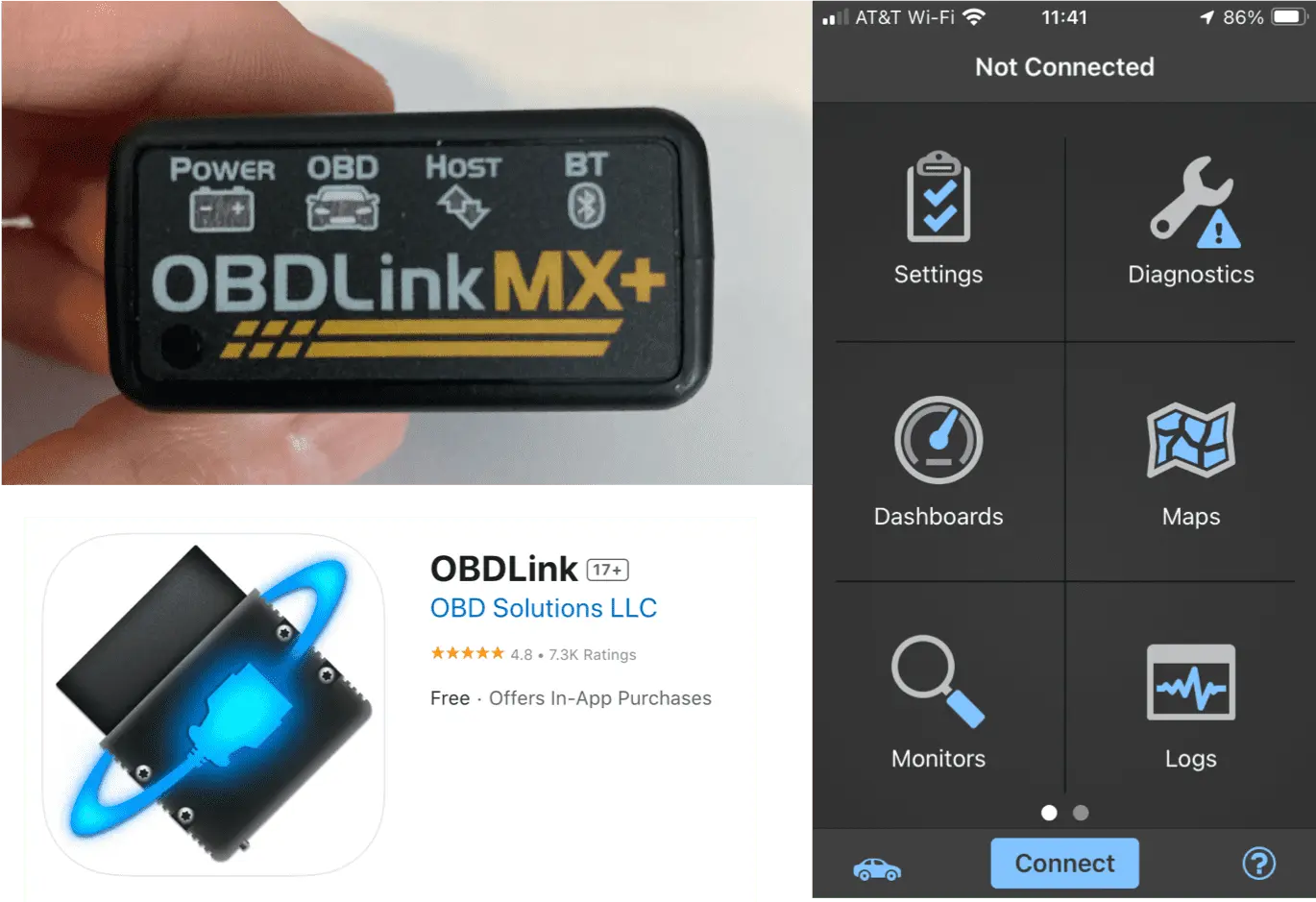

The next best thing is the OBD Link product. Since a lot of Lotus' info is based on toyota most common issues can be read and diagnosed with this system. You'll need to download the app and buy the Bluetooth OBD adapter.
I used this on my Evora GT and it worked really well. Haven't plugged it into an Emira but assume it'll work there too
Yeah, I bought one of these ages ago for my Focus RS. Even supported changing things and programming the body modules through Forscan. This dongle can connect to basically every CAN bus on the car. I've already used it for connecting to my Emira to scan for codes.
The included software is free, and functional, but not really that great. Reads pretty much every module in the car though and you can setup dash pages to show different PIDs.
And the big bonus is it will work with apps like Harry's Lap Timer and others so you can feed telemetry into your videos.
I also had the OBDLink CX that I used to code an M2 Competition in the past. I have used it and the OBDLink App to read the Emira, but it could not find the SRS fault. It could find the drivetrain systems. Recently I needed to try to reset the airbag SRS light and was looking for an App that may allow me to do that with the OBDLink scanner. I found one called "Car Scanner ELM OBD2" App that had good reviews. I was a bit shocked when I was able to reset the SRS light with it. It will also let you "code" other features, but I have not yet tried that. The software supports several other Geely brands which I'm sure one of which is used for other various Emira systems.
