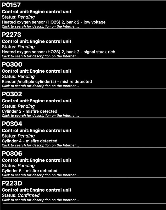

Well here we go again. Made it about 800km.
O2 Bank 2 (the third one total now) left us today.
Live data shows it’s voltage stuck. P223D is being reported again. No O2 related codes yet, but last time they only showed up at a later time too.
HOWEVER I come with good news - well maybe:
Im pretty certain it’s water related, since it happened again only after giving the car a wash.
I thought I recalled it happening the first time after a wash, but wasn’t sure.
Second time it definitely was after a wash.
I put off washing the car after the last fix up until today (And that’s a hard time for any DV owner), because the thought stayed with me and I wanted to confirm. Here we are. Washed -> code a few minutes later.
It might be a big coincidence but I hardly believe that.
Also got the parking brake service alert, but I’m not 100% certain that’s also related to the above. Both times they happened I was stationary for a few minutes, while in the car. Ignition off. After some time the display turns off and turning the power on then seems to trigger the alert - I’ll try to reproduce that tomorrow.

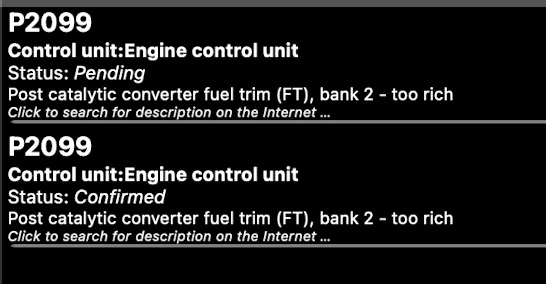

Hey, do you happen to remember what was the root cause of the P223D fault code or what it means ? In the search engine you’re the only one who got it/mentioned it , my first engine light in two years hope nothing serious (it did go away after a few hours)
Edit:

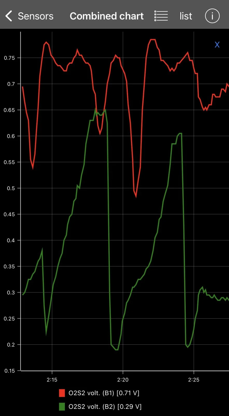

This is the O2 sensor voltage reading of bank 1 and 2
Edit:
Hi
can you check the Short Term Fuel Trims (%) when idle for 1-2min?
In my case I had water ingress in the ECU which shorted out and destroyed one lambda sensor on bank 2, same position, each time I washed my car or got into heavy rain. Solution was some aftermarket sealing and waterproofing by my dealer. Lotus didn't have a official solution at that time, this might have changed by now.

Thanks a lot for the help really appreciated, I uploaded a video to YouTube of the readings, I got no clue what they mean to be honest.
Link:
I might go to a local shop that works on all other lotus’s (2 exige 430 cup and 1 Elise 250 cup, there are no more haha) to change the sensor and seal the ECU properly if that’s the issue, but I don’t think it will be easy for them to figure it out what you already did, hopefully haha
In time for the holidays lit up like a Christmas tree lol damn, it has reduced power, the sound from the exhaust was way off, I reset the codes and it started normally but I parked it and took my folks RS6 perf luckily they’re abroad so I wasn’t stranded, will look into it here and I’ll take it in to the local shop.
Fuel trims look perfect. Regarding the codes thrown definitely get it checked, do you have access to a dealer?

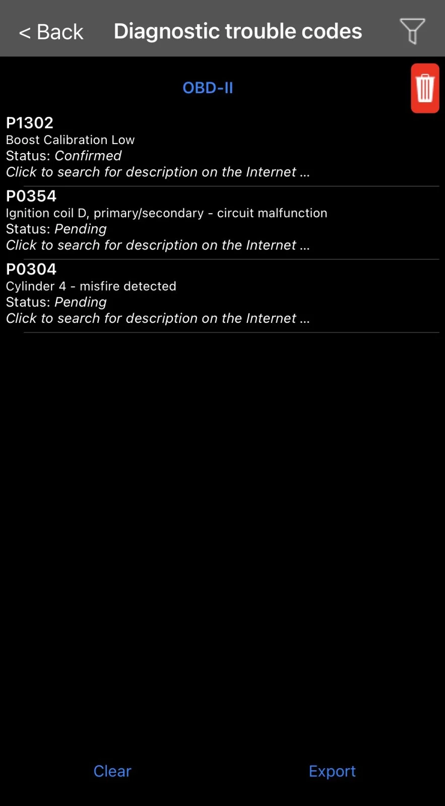

Hi,
I almost didn't want to start another thread, but I feel like this is going to take a while to get sorted and thought it might be of interest. Here’s what I’m dealing with currently:
Around 300 or 400km ago, my car went into limp mode accompanied by an ESC error. Sorted itself out after a 15-minute pause. About 150km later, limp mode occurred again, but this time there was no ESC warning. The Check Engine Light (CEL) remained persistent even after restarting the car.
Car drove fine until after the second start (?) since CEL it sounded like a tractor, almost stalled while idling, and required a good push on the gas to get it rolling (Had to get it off the street into the gerage). In gear it "worked" to some extent, but definitely not in a good way.
Followed the manual to dis- and reconnect the battery. CEL and limp mode were still present, although the car ran "normal" again. I drove it to the dealer, and at some point, the limp mode disappeared. The dealer read the codes and surprisingly found nothing except for a "Mechanical failure Start/Stop button." Cleared the codes, and I was back on the road.
The next day, when I started the car, the CEL reappeared. Frustrated I decided to purchase an OBD reader to gather more information. Here are the codes I obtained:
Brought it back to the dealer who did update the ECU (I originally was scheduled for a later date) and cleared the codes yet again.
Drove another 40-50km and after a pull in 4th gear from 60km/h to around 110km/h, the CEL came back. New codes:
Anyone wanna guess while I’m waiting for an appointment to get this properly checked out? Seems to be somewhat related to bank 2(?)..

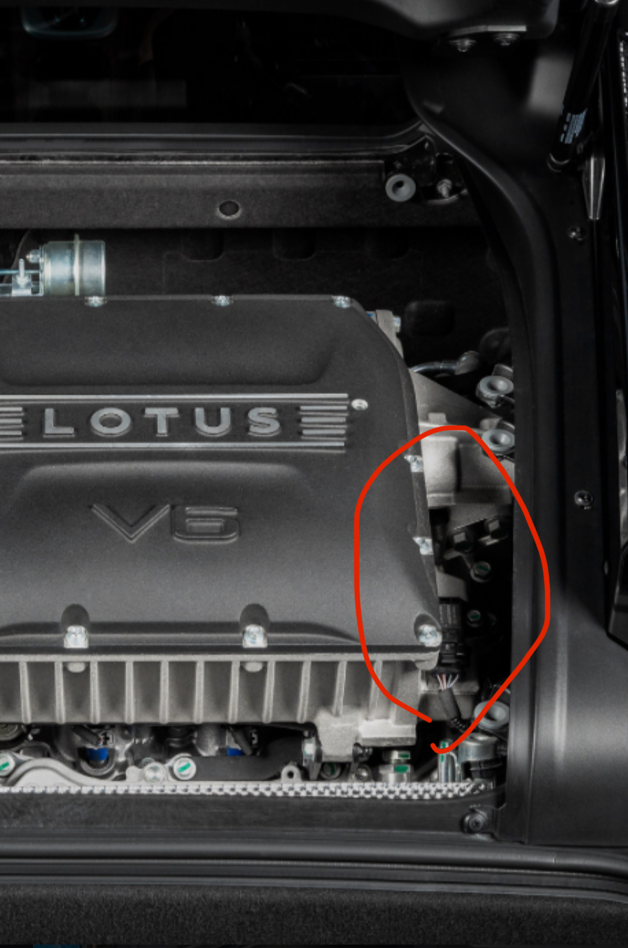

So apparently there was oil on the MAF sensor in/near the supercharger which lead to other codes pop up due to the incorrect input from the MAF sensor because of the oil, they cleaned it and now everything seems normal, apparently it’s a known problem for lotus’s at least for the exige and Elise which was their first assumption and they were right.
Appreciate the help @Kimmax
Are you using an aftermarket oiled "wet" filter? The OEM filter is dry so there shouldn't be any oil up there...
No, everything is stock, but you’re correct, the mechanic told me if it happens anytime soon it needs to be investigated where the excess oil is coming from. If it only happens once every 5 6 thousand km it’s ok.
It’s not in the air intake path, it’s near/in the supercharger, it’s located somewhere over there.View attachment 55217
The car only has one MAF and it’s located to the left of the supercharger in this orientation.
It’s in the intake box’s outlet which leads to the intake tube. There must be a miscommunication between you and mechanic…
