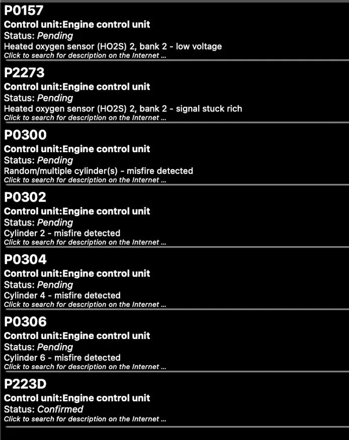

The next day, when I started the car, the CEL reappeared. Frustrated I decided to purchase an OBD reader to gather more information. Here are the codes I obtained:

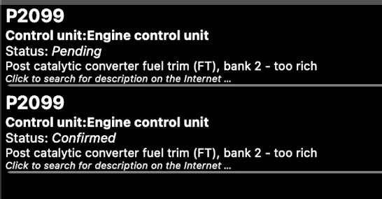

Drove another 40-50km and after a pull in 4th gear from 60km/h to around 110km/h, the CEL came back. New codes:
Anyone wanna guess while I’m waiting for an appointment to get this properly checked out? Seems to be somewhat related to bank 2(?)..
The car idles kinda rough, but it always did that to some extent as far as I can remember. I know it can idle super smooth since I wondered if it was actually running a time or two because it didn’t generate any vibration whatsoever

I’d be running diagnostics on the heated oxygen sensor on bank 2 to see if it’s responding correctly — wiring to and from it as well all the way to the ECM. Every single error you’ve shown is showing some issues keeping air fuel mixture correct and everything is reading rich.

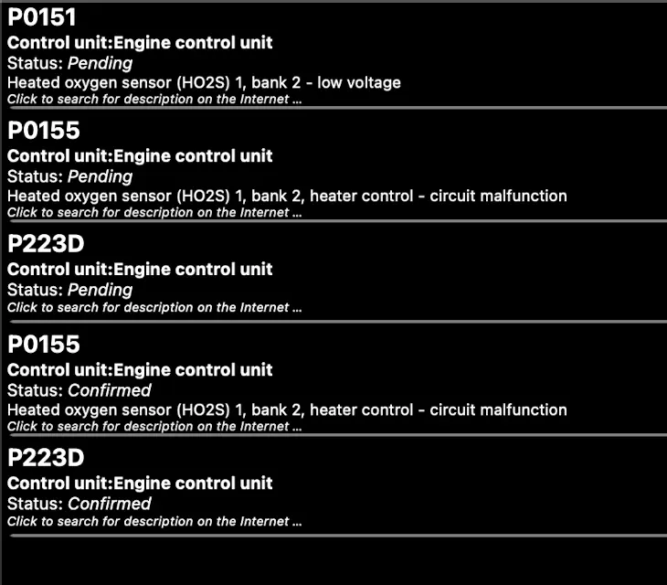

New set of codes, thrown immediately after starting:
I'm awaiting an appointment (Public holiday today) to get this thoroughly checked, but it might take a long time. Dealer is packed with new Emiras and said something about 30. June or July - I sure hope it was the former :ROFLMAO:
Anyone can assess how bad it is to drive in this state? It runs fine, especially if it warmed up a bit - but I don't want to cause any damage in the long run. Would suck to miss the beginning of summer tho :(

You can drive with O2 issues without a problem. My understanding is that a car is drivable with the CEL on. If the CEL starts to flash, then you must not drive it or you'll risk damage.

If there's actually an issue with the pre-cat HO2S sensor I would not be driving it.
I controls the stoichiometric mixture, which means you could be running rich or lean. Based on your post-cat O2 sensor it sounds like you're running rich.
By driving you could be:
- Damaging your cat
- Adding carbon deposits

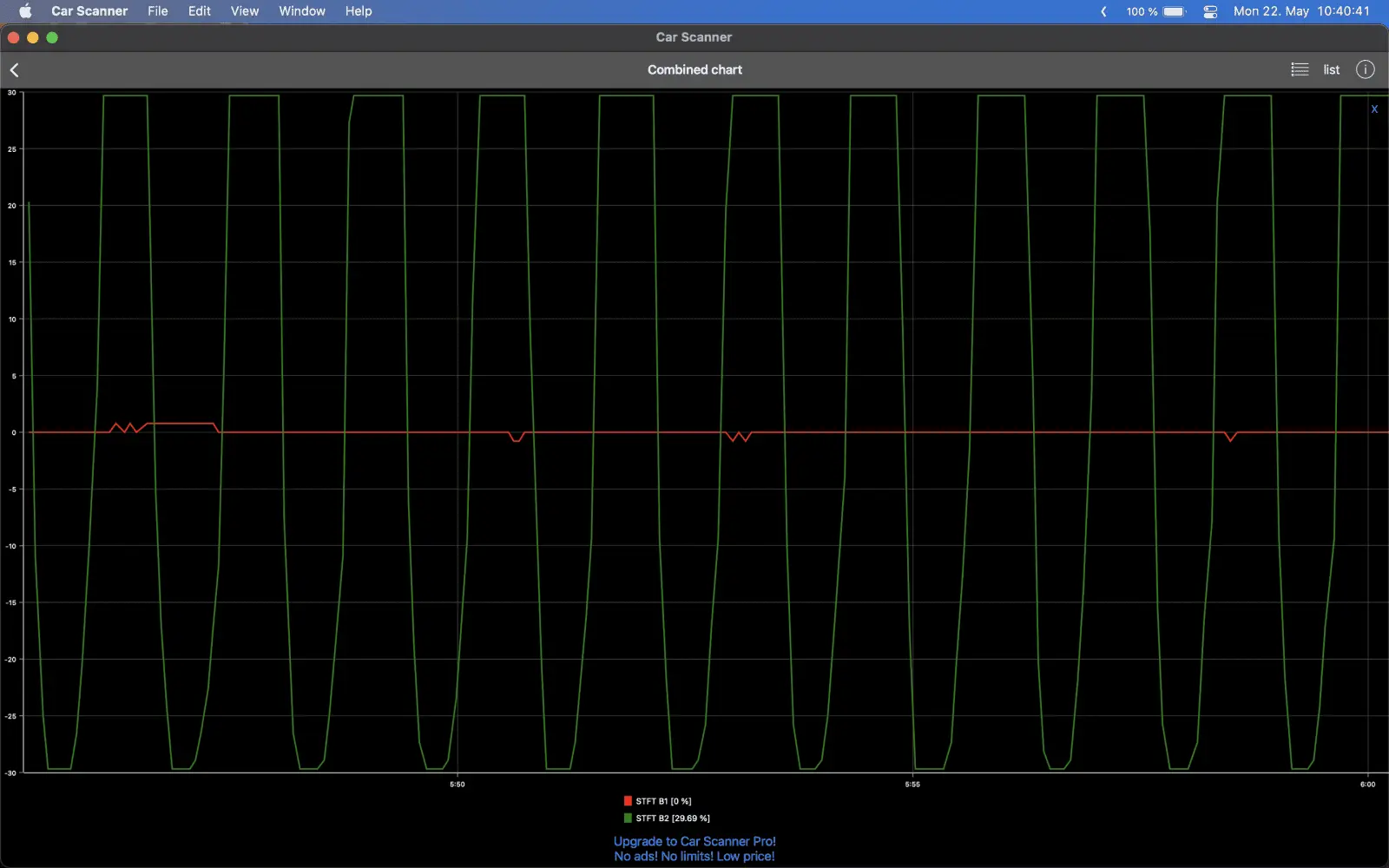

I did a few kilometers, part good and running as calm as never before (I suspect that's the fail-safe) and some feelable rough.
Wanted to drive it to the dealer this morning and well..
(Fuel trim)
Needless to say, I did not drive like that. Switched off, let the ECU settle for an hour, and tried again - "ran" again.
Car is now parked at the dealer who tries to do something between jobs, otherwise, I'm looking at the last week of June 🥲
(Fuel trim)
Wow those wild short term fuel trims. If you wanted to figure out exactly if it’s the HO2S or the wiring, you could probably swap the sensors.
If it swaps banks you know it’s the sensor itself.

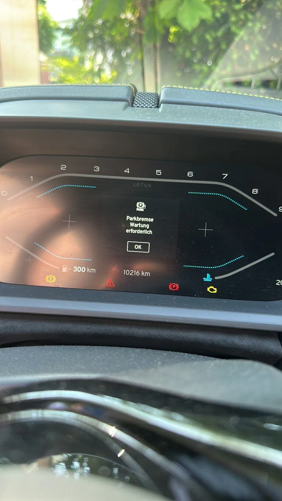

Well it was fun while it lasted. Throwing new codes, limp mode, parking brake service, didn’t want to start, etc.
Guess it’s time for an ECU replacement and harness check -_-
Dropping it tomorrow for the 5th or 6th time at the dealers..
