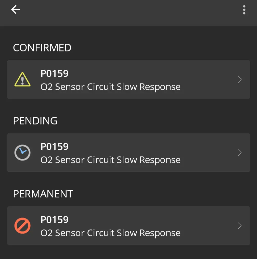

2300 miles on the odometer. Front right corner is making squeaks over bumps in the road and just got this.
99.9% sure it’s an o2 sensor. I got this code repeatedly when I first got the car and the dealer replaced o2 sensor (and the cats to be safe) and the error went away
Agreed. I'd buy a few and replace them myself rather than deal with the time down at the dealership, but not at $500 each.
