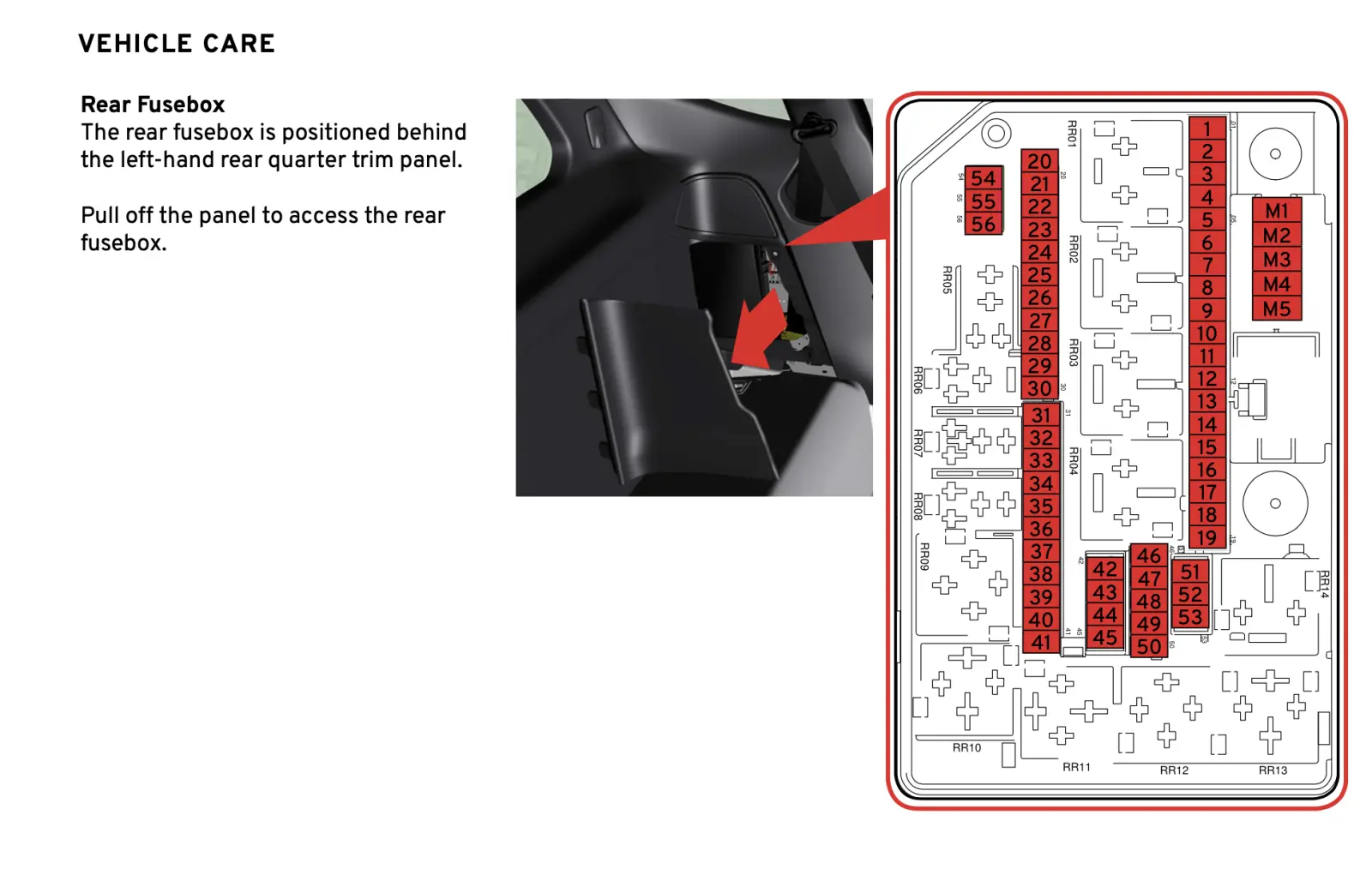

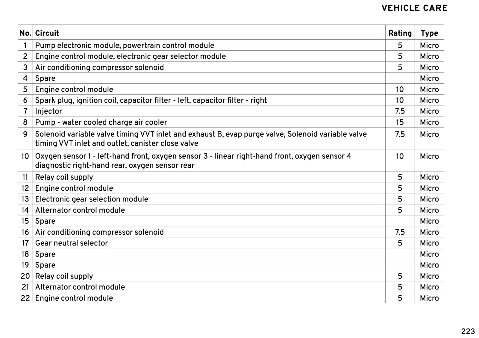

There is a fuse for the spark plugs and coils. It's number 6 on the diagram, and it's in the fuse box behind the driver's seat.

No word back but I'm going to go check the fuses tomorrow since they haven't looked at it yet
Dealer called today. Two coils failed causing the fuse to blow cutting power to the other four. Emergency parts order should have it running tomorrow.
