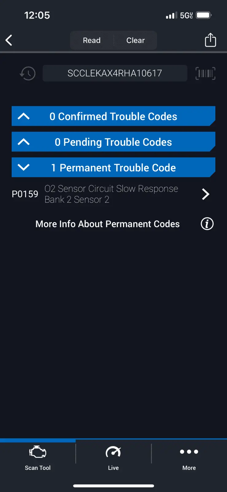

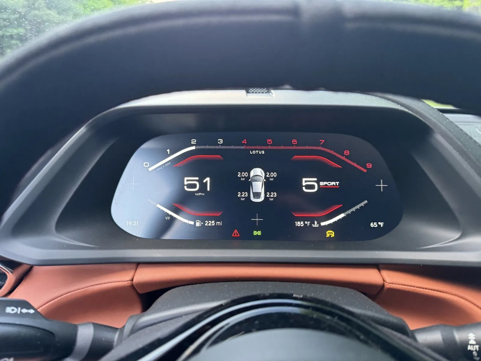

My Issue:
Got my first limp mode this evening after about just 10 minutes of spirited driving after warming up the car (maybe 75% throttle, around 6K max RPM or so) so I wasn't going balls to the walls on it. See the pic below for what this looks like. Traction control was disabled and I got messages stating the car needed servicing.
I "limped" to a nearby gas station, let it sit for 5 minutes while I purchased some snacks, then started it back up and all was fine. I've had about 3-4 CELs after doing revs at car meetups that also went away within 24 hours.
So far it seems like most of these are transient, non-issues that just cause some temporary angst. Thought I'd mention it here in case other people get this with their Emiras. Overall, the Emira has been rock solid despite these "false positives".
2. Build date - Nov '23
3. Delivery date - March 8, 2024
4. Miles on odometer - ~ 1600 miles
5. Warranty resolution (if any) - N/A - Problem went away after sitting for 5 minutes parked.
6. Wait time for problem resolution - N/A

Was there anything in particular that you recall doing that triggered the CEL the few times you had them? Or were they just at random?
K_Squared
Mar 2, 2023
396
817
Raleigh, NC, USA
Just some fun stationary revving at close to redline, nothing crazy. That is what has triggered the CEL every time in the past that I can remember. It's been reported in some YouTube vids and it was just a fuel pump communication thing that seemed benign.
This limp mode thing was the first issue that actually temporarily inhibited the driving behavior.

Were you revving with the clutch pressed?

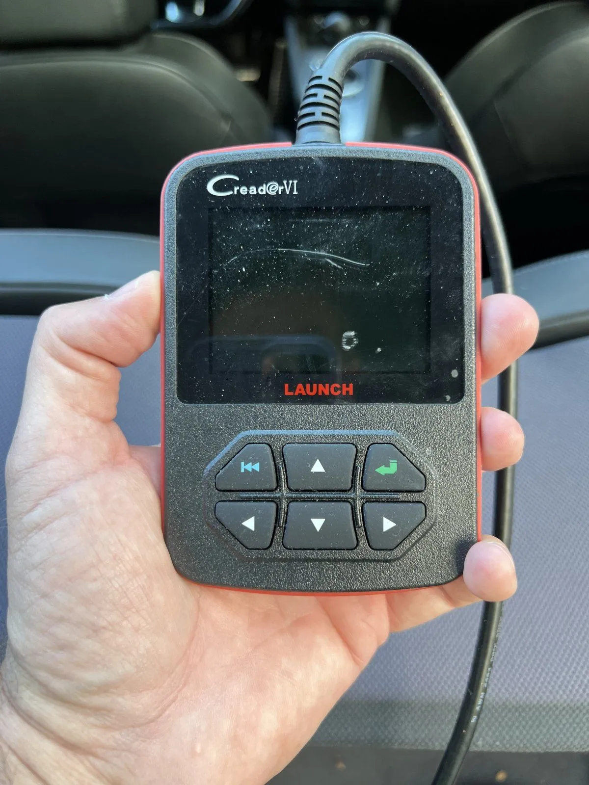

I’d recommend keeping one of these with you…
