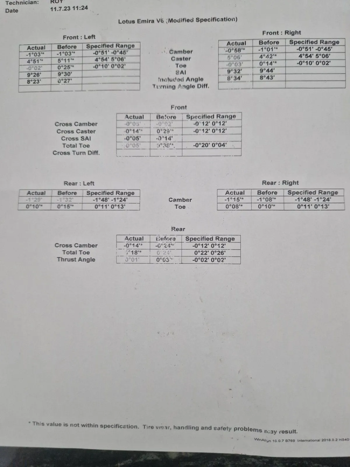

It went for a wheel alignment and all 4 wheels were out apparently in pretty much every direction (quote from technician). They haven't charged me for it but have warned that lotus are likely to reject it under warranty. My argument is that if it had come from a pot hole or such like (my local roads are horrific but I'm pretty skilled in pothole slalom) the surely it wouldn't be all wheels in all directions? ? It's only £90 so not the end of the world but just really curious what may have caused it. I can't pinpoint the exact moment I noticed the steering wheel off centre in a straight line and I've had no wince inducing moments with pot holes or road debris. You'd thin anything harsh enough to do this from impact would have damaged a wheel as well ?
I don't see how you could do that to the car. It looks like either they weren't set up properly at the factory to begin with, or they weren't tightened down properly and over time, the adjustments slowly moved out of spec. Weird.
One of the last stations in the factory is a full geo check and adjust, which every car gets, so don't see how this could have been out of spec... Unless, as suggested by Eagle7, the tie rod ends were not securely tightened (seems unlikely).
Also, general question, is there any camber adjustment on the factory setup, as looks like they didn't adjust the camber? (your fronts are slightly out of spec, though not necessarily a bad thing as slightly more neg camber than spec, but rears are 14' difference, so 1/4 of a degree different, which whilst not a huge concern for road driving, does make me wonder whether there is any camber adjustment available)

It definitely didn't leave the factory like that, curious one for sure.
Not sure re camber adjustment
Camber is adjustable via cambolts on the lower wishbone chassis mounts.
Lotus honoured the warranty on the wheel alignment no problem

Honestly this was not an awful alignment spec before their changes. Front toe was all that really needed adjustment. In fact the front camber was better before they touched it, I suspect that the factory is setting these to neg 1.0deg camber in the front as a matter of course now, and the target spec in the dealer's machine is not aggressive enough.
Toe fix probably fixed the pull in the front but made it a touch more darty or lively? Or did it do the opposite? Very slight neg setting would typically be toe out (rather than toe in) on most machines, and a slight toe in spec from the factory makes some sense. Would need to know their machine type to verify though.
Tbh other than the obvious pull I can particularly tell a difference, if anything the front is more darty
