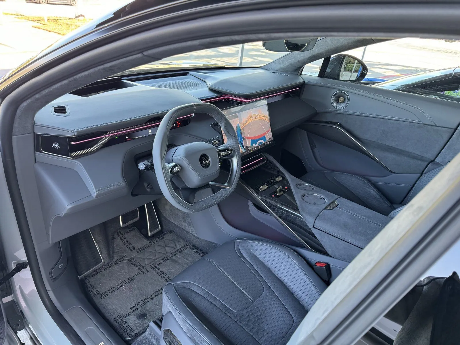

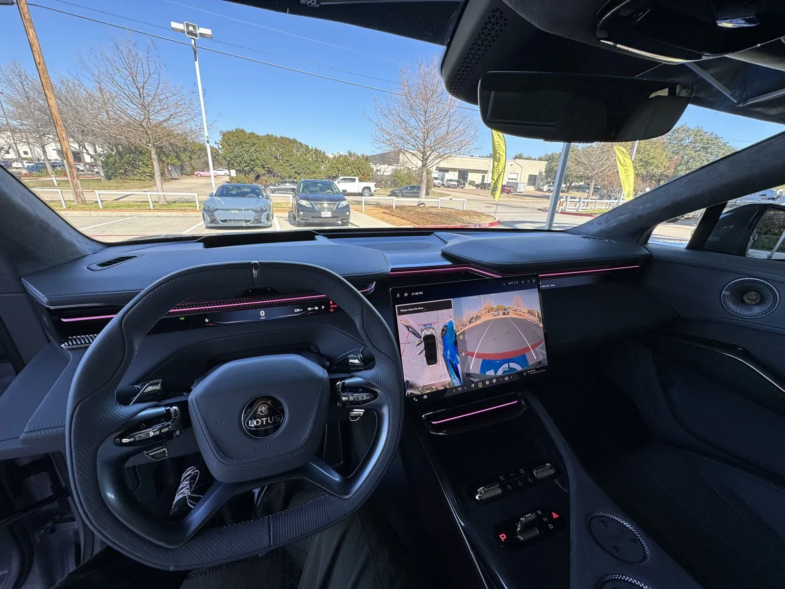

I drove the Electre today. i also listened to the Kef system, so much better. Sounds unbelievable very nice system similar to my B&W in my BMW.

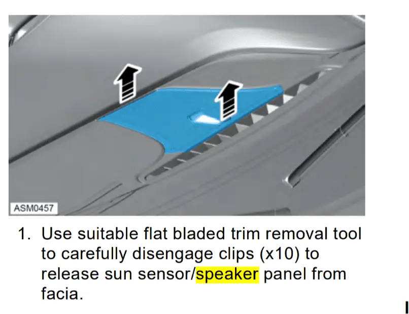

One of the complaints I've read in reviews and seen in videos is the glare off the center channel. I was just watching the latest batch of videos and it's not wrong; there's a big glare from the reflection of the center channel on the inside of the windshield.
Has anyone flocked this or coated it in some way to cut the glare?
@Aerie what are the odds of a matte carbon grille to replace the stock silver one? Looks like removal would be a breeze.

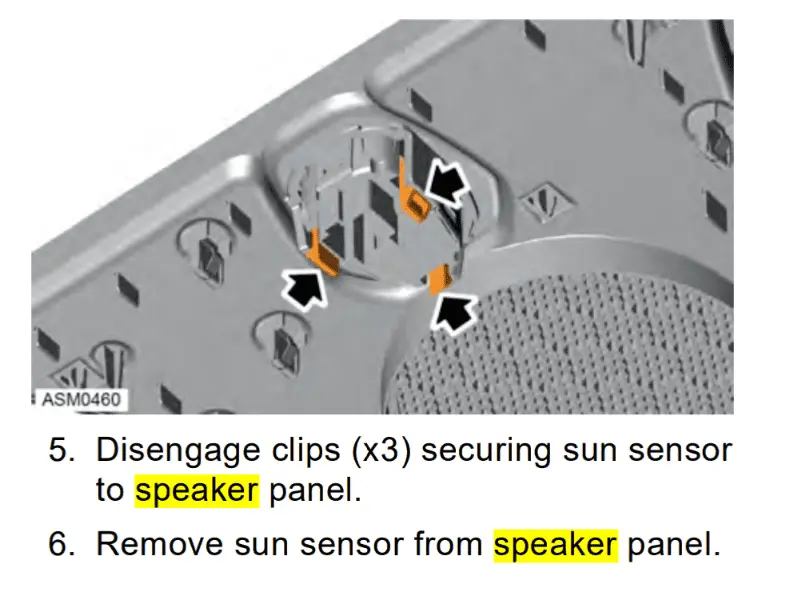

I’ve got to imagine any sort of coating there is going to mess with the sensor.
The sensor looks to be just a standard light sensor, and that part can be detached and reattached to the new grille.
