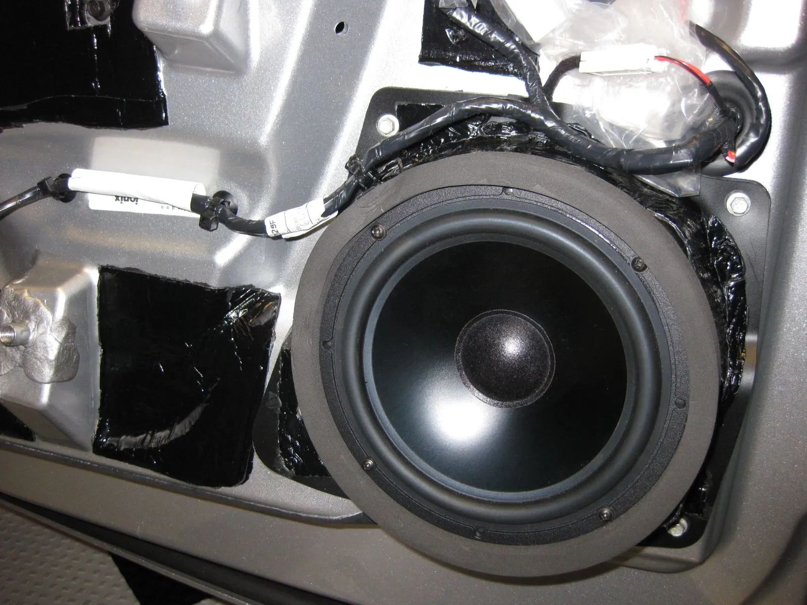

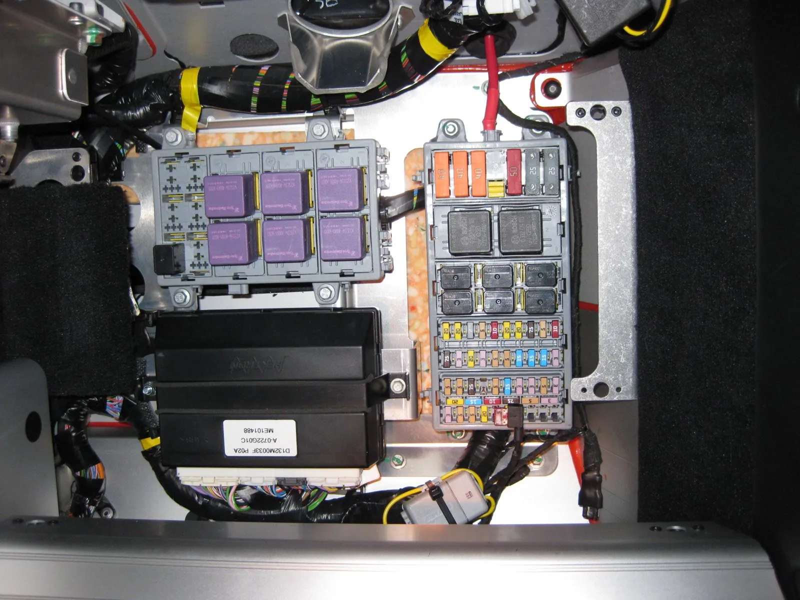

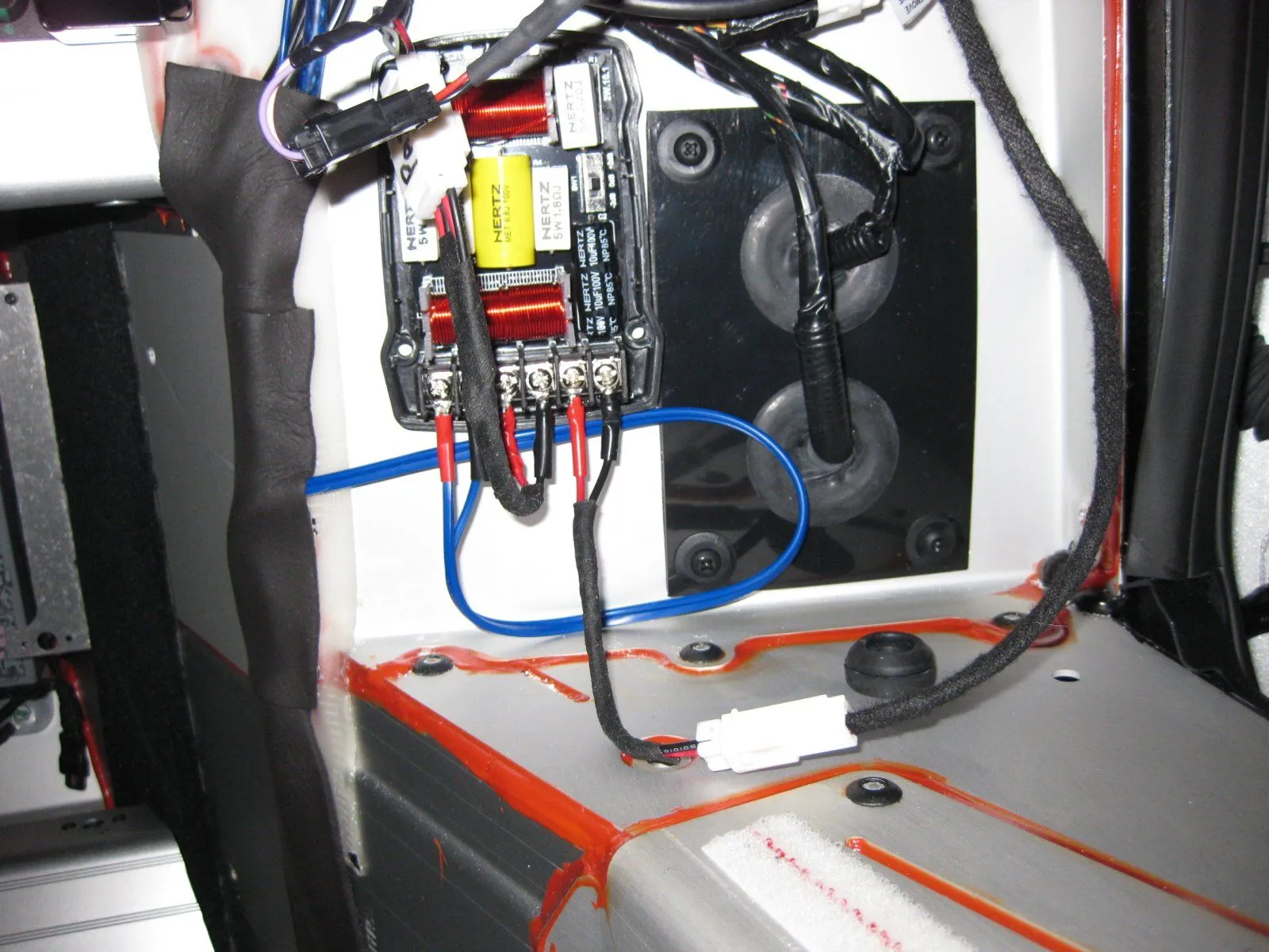

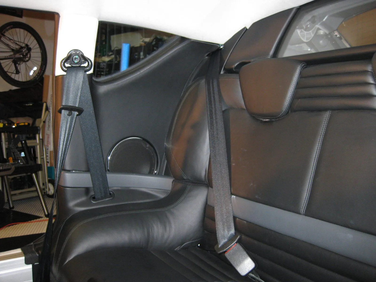

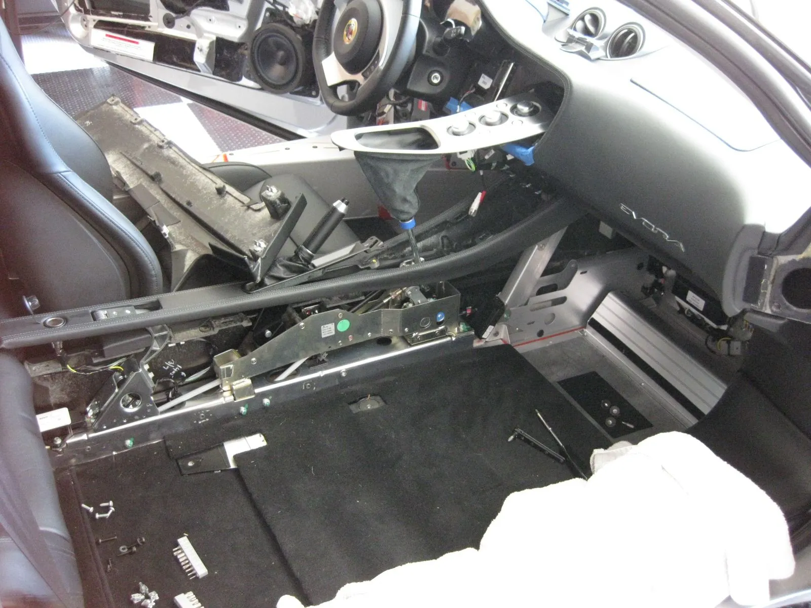

Quick pictures of my work on my 2011 Evora in 2012. This was a big upgrade as that system was horrible and the KEF in the Emira is much better than the Evora top original system but fell short based on today's Audio standards. For those that will be changing it out stay with the base systems SAVE the money for your upgrade. Anyway ready for the negative comments so blast away.
View attachment 36408View attachment 36409View attachment 36410View attachment 36411View attachment 36412View attachment 36413View attachment 36414View attachment 36416
