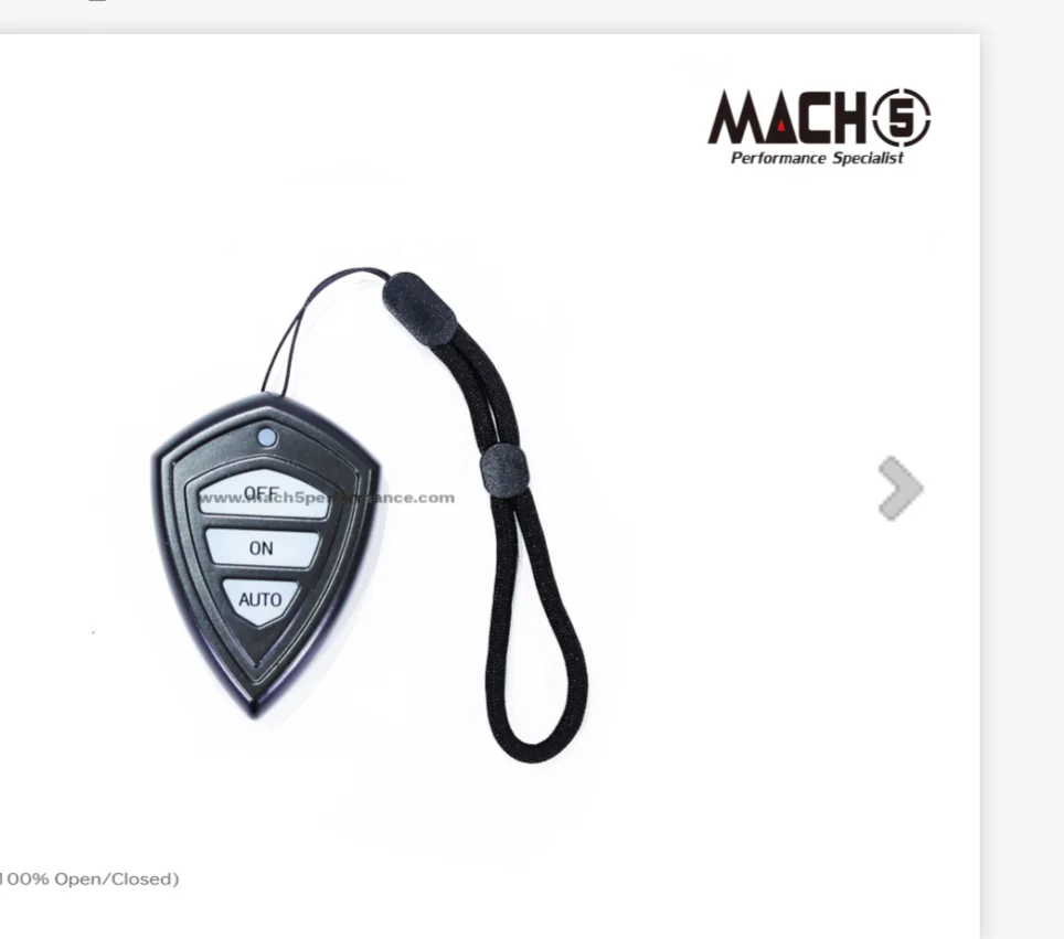

I do wonder how they can determine the OEM valve position (for Auto function) when the M5 controller only appears to have access to the 12V supply for the OEM valve motor:unsure:
I’m pretty sure it can be patched up and if not I’ll get a replacement cable.
Hm good question, I just assumed auto worked as it’s pretty quiet in tour mode.

I’m sure Auto mode does work, just not sure how they know the position Of the OEM valve. I want that function, as TBH the car is kind of anti social with the exhaust valve open.

Just asked mach5, they don’t have auto mode
