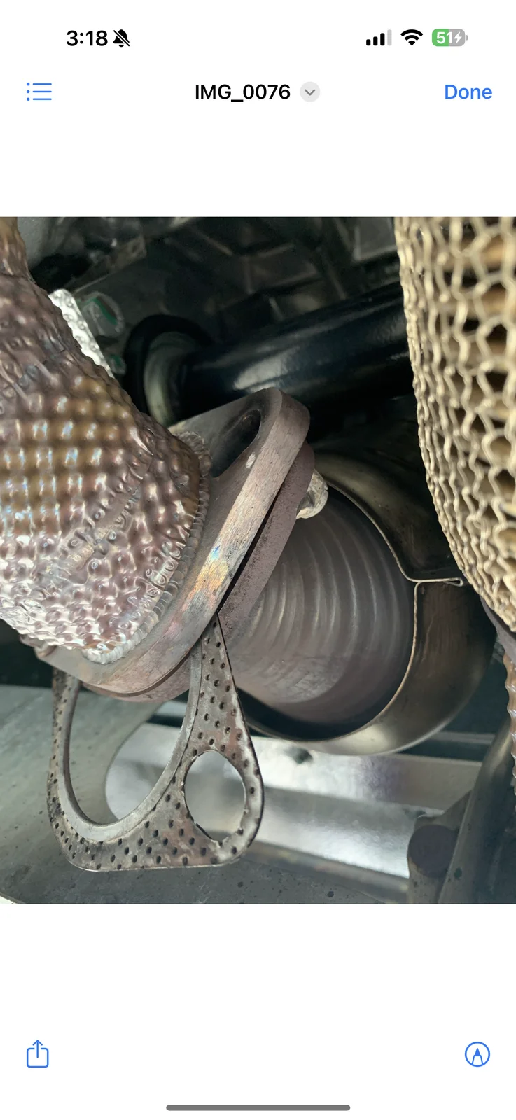

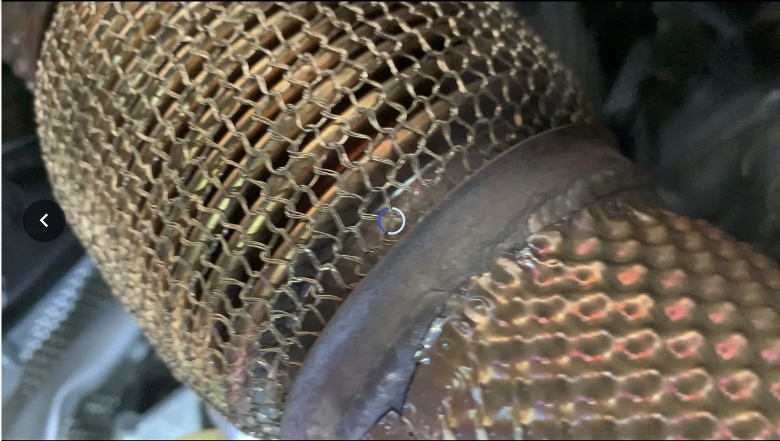

My Aerie SS shielded y-pipe seems to have an issue. The bolt at the joint with the headers came off. The dealer replaced this but due to the Aerie y-pipe not having a flange the gasket doesn't sit properly and there is still a leak (smoke tested). The smoke test also revealed the flex joint is leaking so this is a manufacturing defect. Photos/videos here. I have contacted @Aerie about this so will see what their solution is. The dealer also mentioned that they have seen numerous Ti exhausts crack after a few years - hoping that doesn't happen to me
So Aerie's response is that the flex joint on any y-pipe will leak. I highly doubt this and doubt there was a leak on the OEM y-pipe at the flex joint. Can anyone confirm?
No, they're not supposed to leak. It wouldn't pass emissions test if it did. They can eventually wear to the point where they'll leak, but that's only after many tens of thousands of miles.

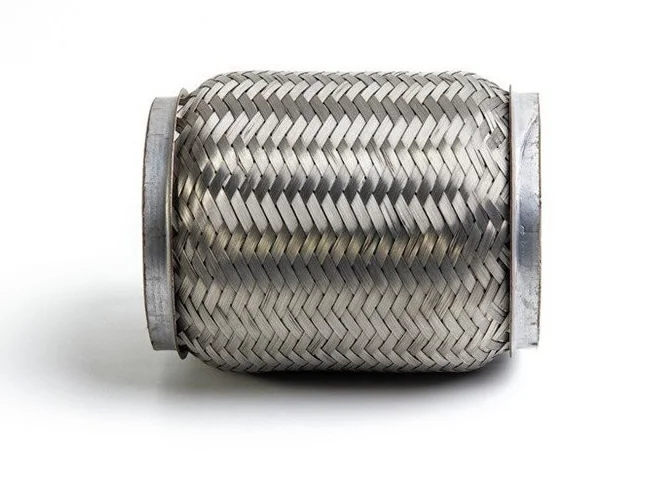

That flex pipe you're showing doesn't look like any flex pipe I've seen. Here's a typical one with a braided stainless steel sheathing:

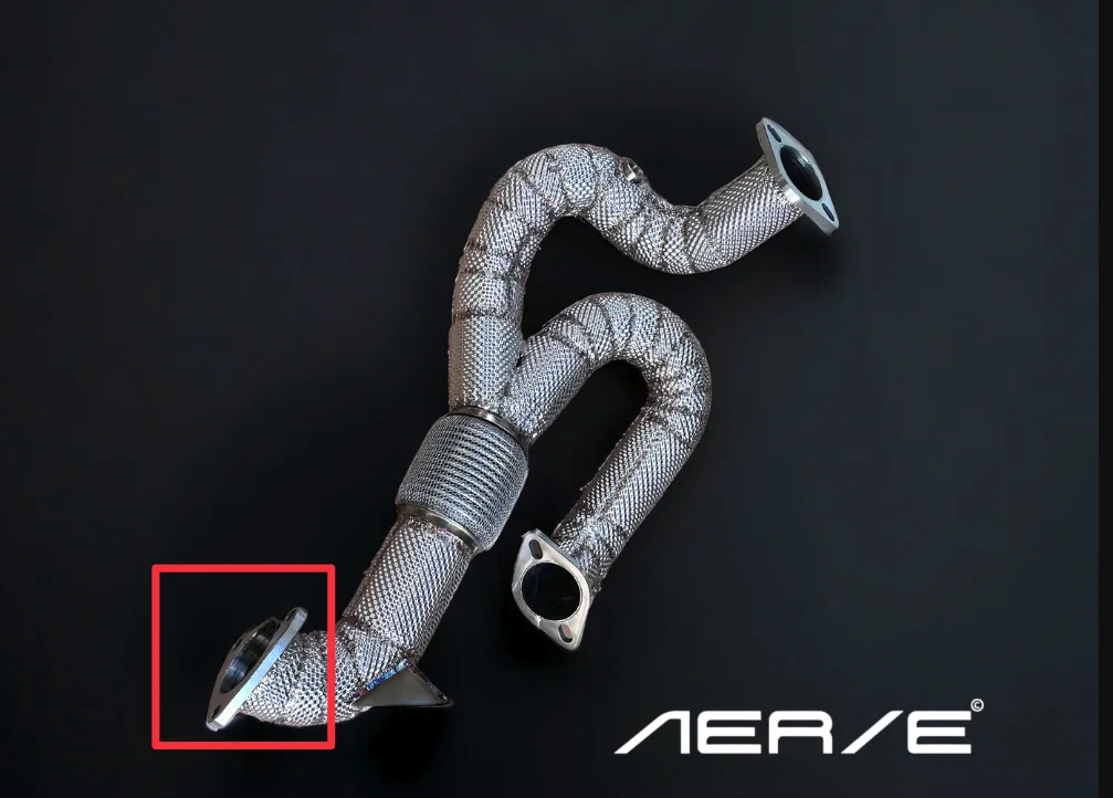

Compare that to what Aerie used:

The stock factory flex joint is the standard braided one. I don't know what Aerie's using, but it's not good. They can be replaced. A proper one isn't going to be that expensive, just takes time to remove the old one and weld in a new one.
Most everyone uses a "bellows" style joint like those now. The braided ones are becoming a thing of the past.

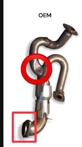

Partially agree the gasket falling out may be to due to installation but also the OEM y-pip has a lip to prevent something like this happening.
The Aerie heat shielded y-pipe doesn't have this lip
Additionally, the "poor" installation has nothing to do with the flex joint developing a leak. Not sure if the same issue will arise with the replacement part as well...
We have sold a significant number of Y-pips without any issues. The gasket problem seems to originate from the mechanic’s installation. However, we need to check the flex joint leak. Regardless, we have no issues with providing replacement parts.
