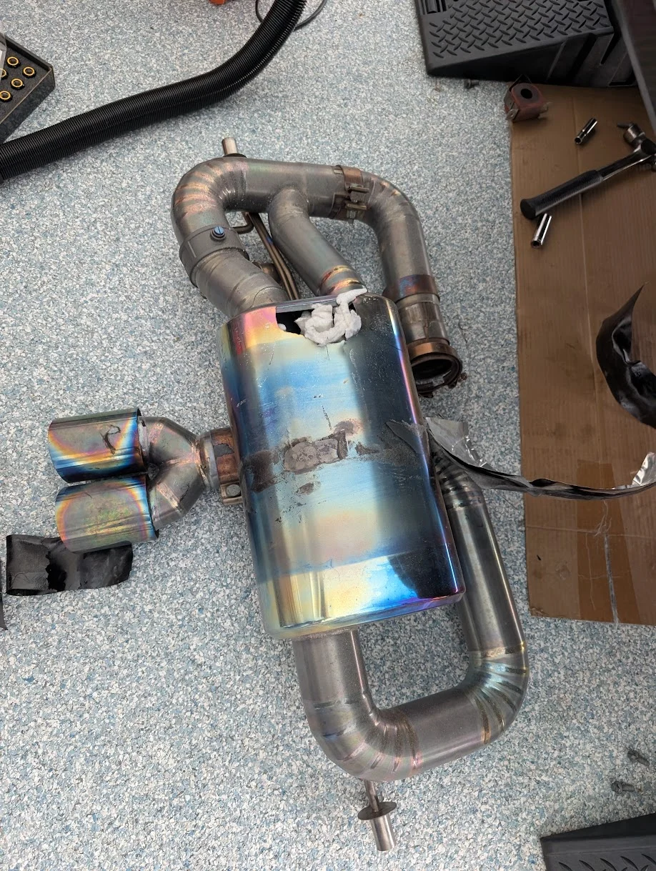

Sorry, I cannot recommend their exhausts. Three known cases of them blowing up in the same exact spot on an Evora GT. I highly doubt their QC or factory of production has changed.
I think it's important to note that they are totally different designs. In fact, there's an argument that your and the other failures referenced may have sparked the Emira v2 design change. If you look at the v2 design, it abandons what is clearly a muffler box weak point (per your and other failure's pics) and replaces it with two 1-piece glass pack style muffler tubes. To date, these have been battered on track at least in the states with no failures to date. Time will tell...
Also worth noting even if the design is different for the Emira (which.. sure it also doesn't use a center exit exhaust). These kinds of weaknesses in materials and manufacturing are not frequently one-off. Additionally, I doubt he would be telling people "don't do it" if he found Aerie to be a company that was making him whole and being supportive.
Likely they are making it his problem and not offering anything.

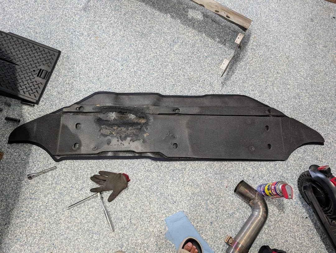

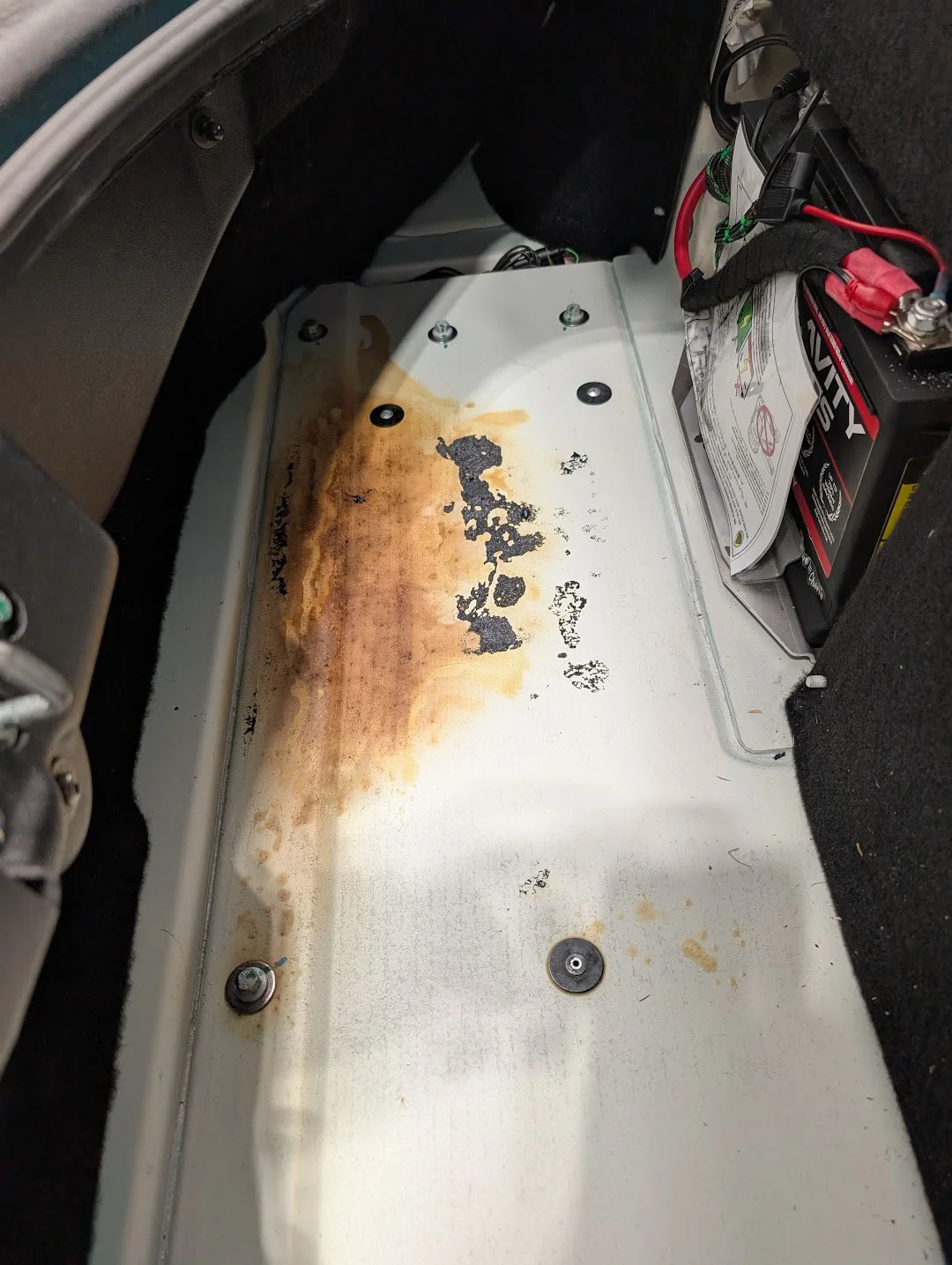

Correct. My seller originally had a defective exhaust and Aerie sent him a new one to "keep quiet". The owner sold his GT before it had eventually arrived so he then sold his brand new replacement to me. I want to emphasize that I did not buy a "used" exhaust. It has also come to light that the other three cases (I have just learned of another) were also asked to "keep quiet" and delete their posts about the catastrophic failure contingent on receiving a new exhaust.
When I had originally purchased this exhaust it came with a decat that was a slip on style. Rather than providing "support" the suggestion was to spend hundreds to thousands by on welding a vband (if you know anything about welding titanium from a skilled welder, it's expensive), purchasing a decat with a vband through them, or purchasing their header and Y pipe through them.

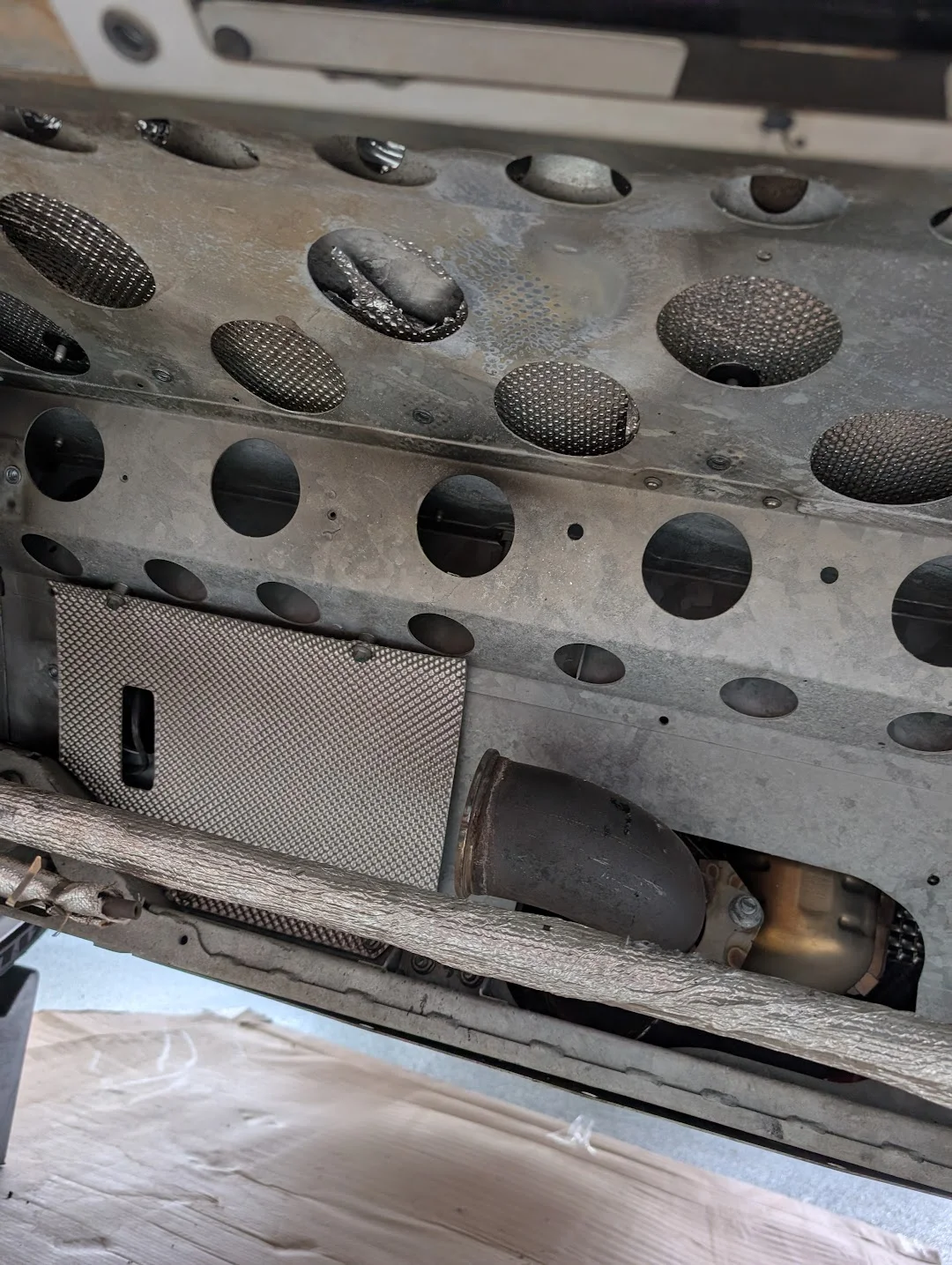

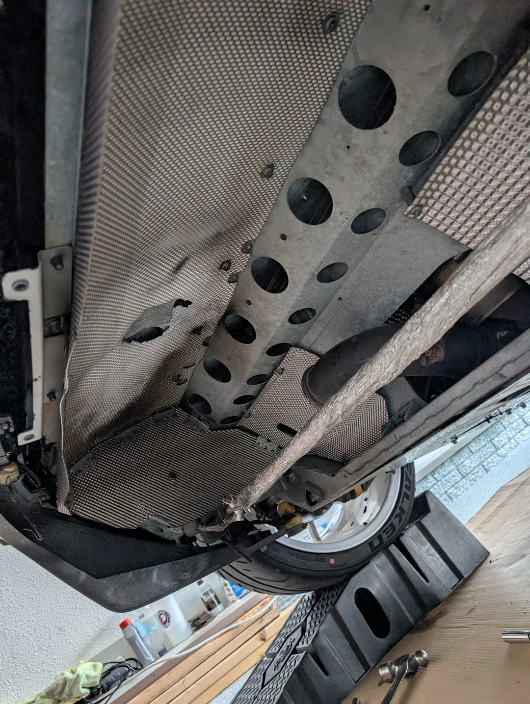

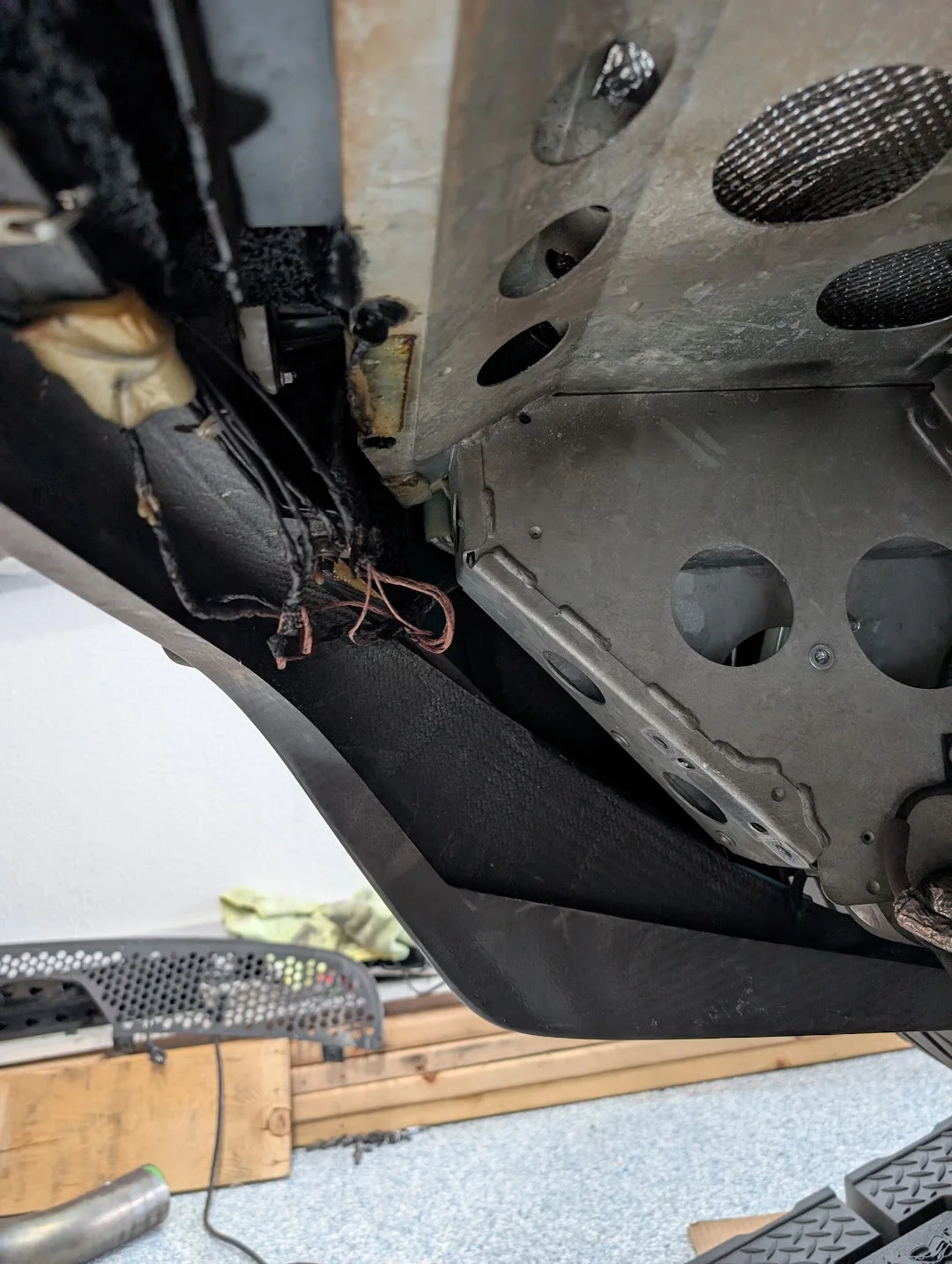

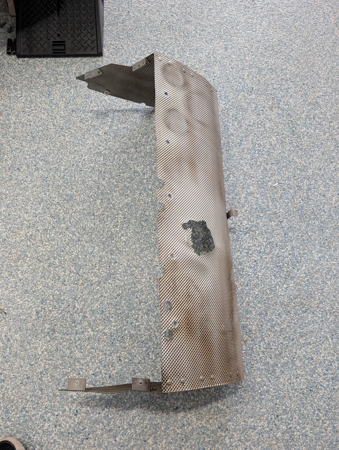

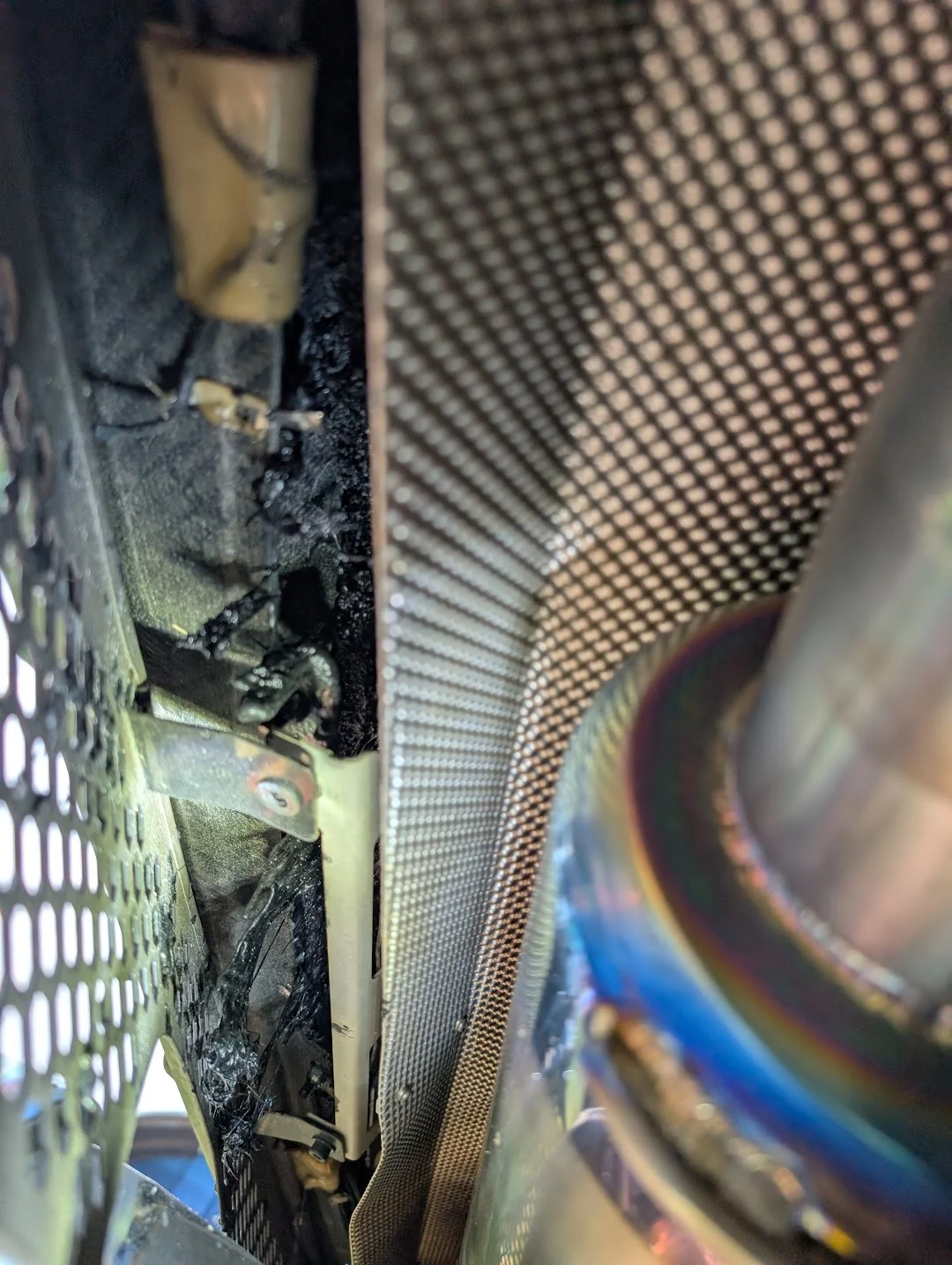

I have sent them a reply noting the cost of the extensive damage. They have not replied. My kids ride in this car with me everyday. This is the damage it caused to the clam, the foam padding, the carpet padding, etc. (and yes, that's a lithium battery, imagine if that caught fire):
To be fair it looks like it probably got lighter
