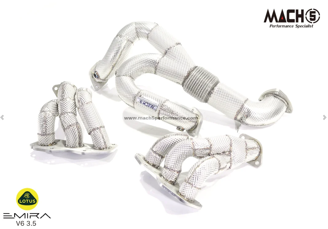

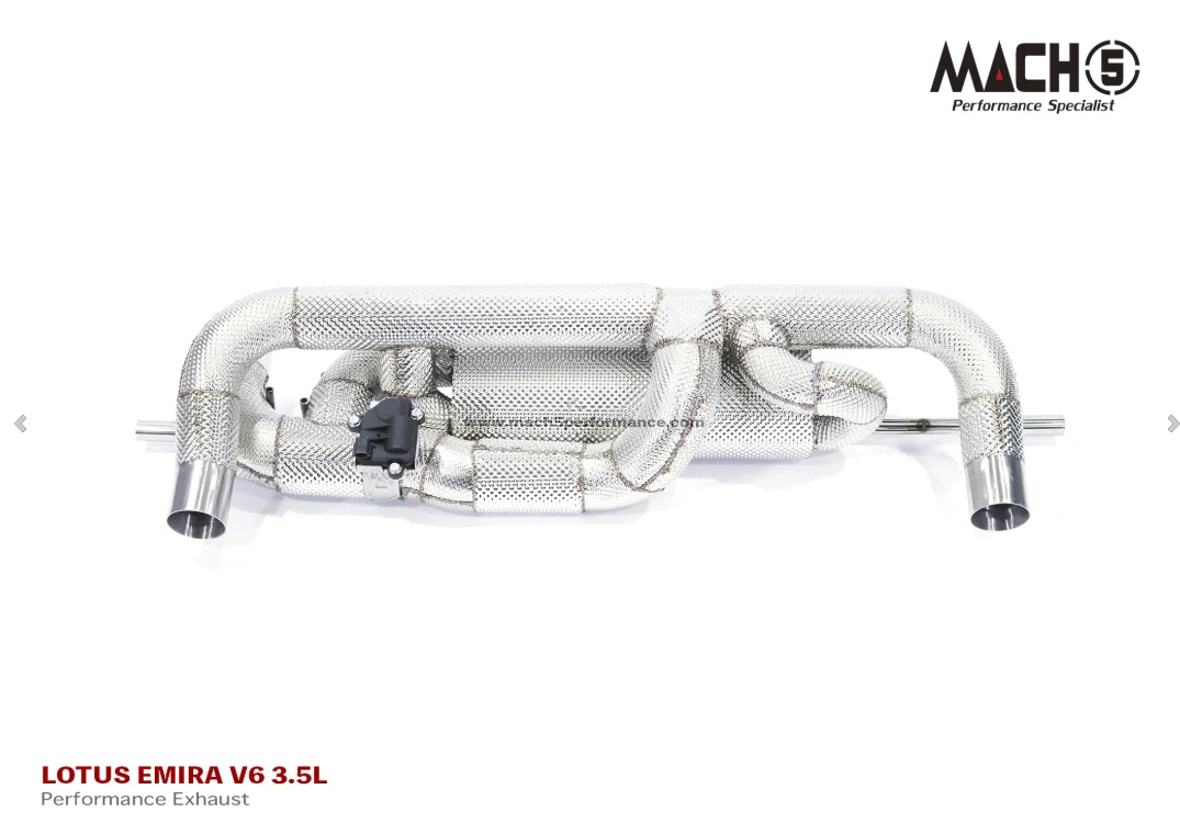

Aerie doesn't make a heat wrapped full exhaust after checking their website. Do they make it custom?

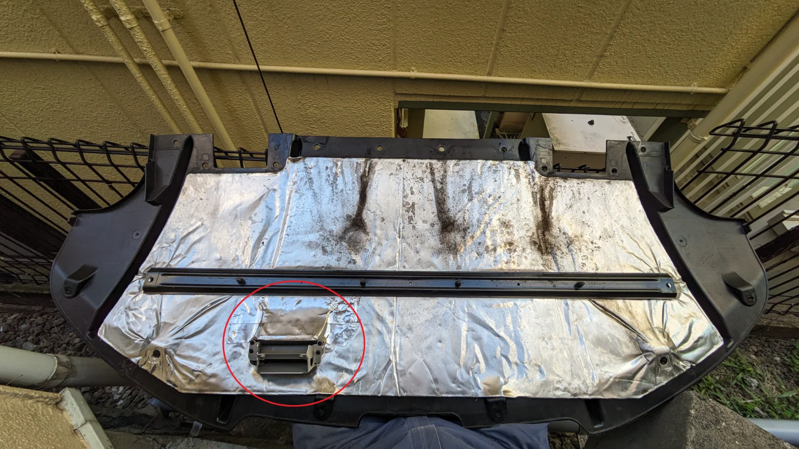

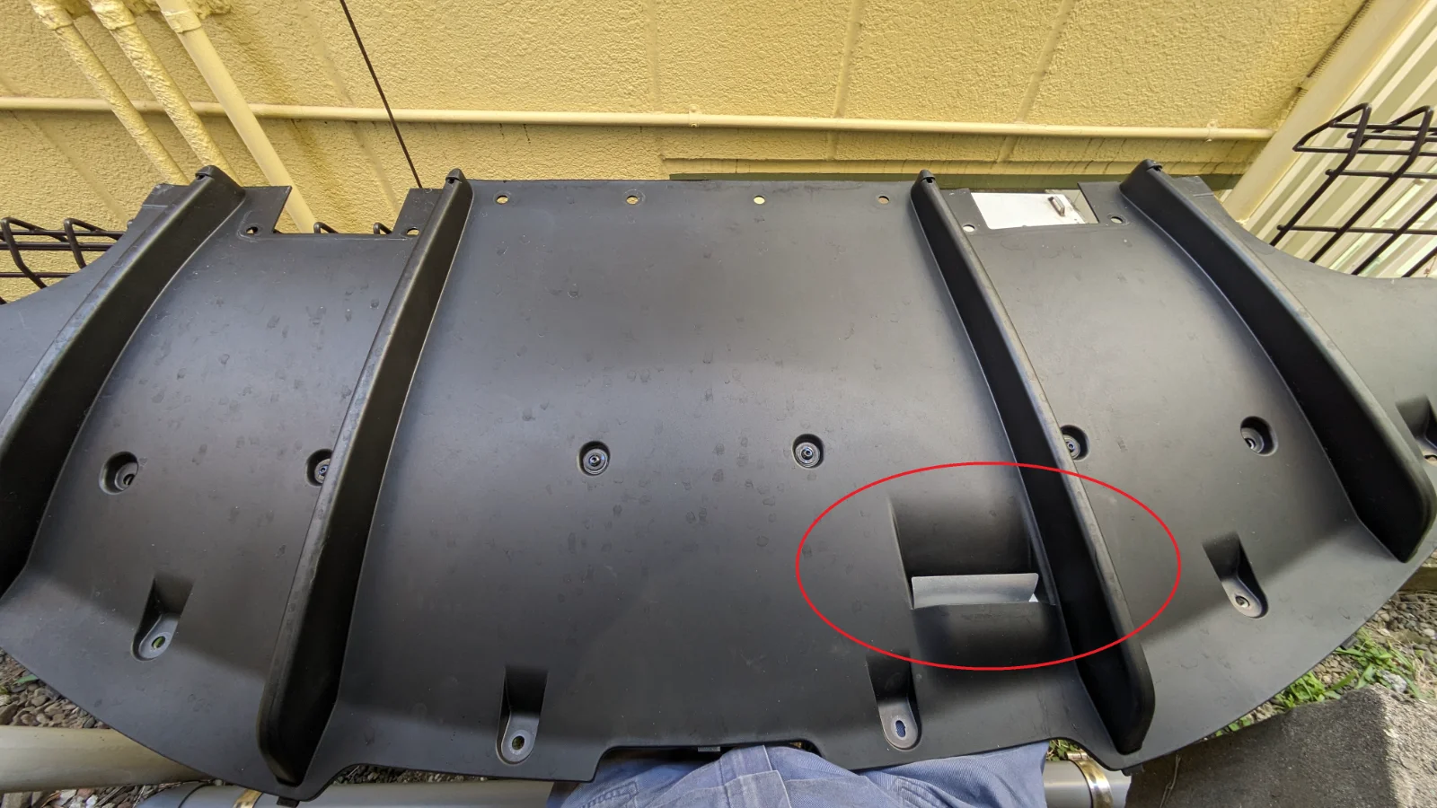

Had to go thru some old pictures to make sure I wasn't remembering things I hadn't seen :LOL:
These are pictures of my (V6 Manual) diffuser. The area circled in red is a hole in the black plastic, with a metal reinforcement in the inside. IIRC this is in the general area of the valve assembly.

He has a valve controller the last time I saw his car. He’s basically running this style
Although his is not mach5 but his tuner branded exhaust (Boomgear), I’m pretty sure Mach5 has some sort of relationship with them since Mach5’s factory is in the same region.
