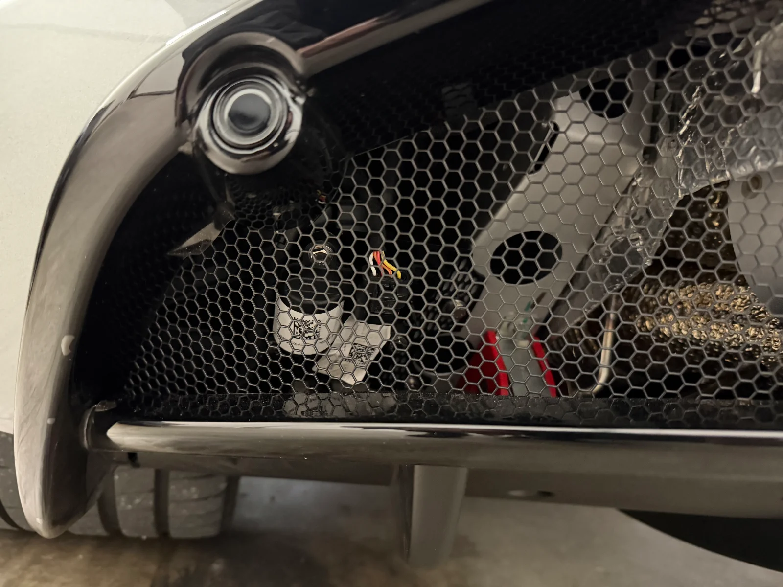

Charge cooler upgrade is done, the red coolers look nice from the front of the car. Also got the suspension done, so now have -3deg or a little more, it is very obvious from the stance, really pushed in the top of the wheels. Not sure if I’ll run more offset to push the wheels out further, or if that will mess up the geometry.
Got a pick of the charge cooler upgrade???
