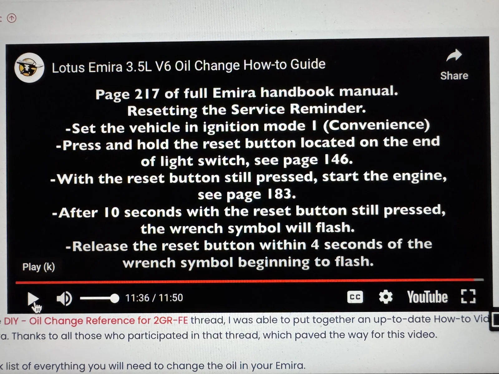

does anyone know how to reset the oil service for the 1k oil change , I tried the steps provided with the reset and the ignition switch on a v6 2024 and I don't get the wrench symbol
Hey Juan,
You probably already figured it out by now, but recently I tried to reset the oil service warning message myself and encountered the same difficulty you and a few other members have. I finally found out how it actually resets. The manual's instructions posted previously are not accurate, but I found the most useful guide at the end of great Dragoon's oil change video with the instructions pictured below, with the single exception that what actually flashes is not a "wrench symbol", rather it's a yellow warning triangle at the bottom of the dashboard screen. You need to turn off the ignition 4 seconds or less from the point it starts flashing (while it's flashing). Coincidentally, that yellow triangle flashes just about for those 4 seconds before it goes blank.
This was how I got it to reset on my Emira. Again, maybe this news is too late for you, but hopefully it could help others going forward.
