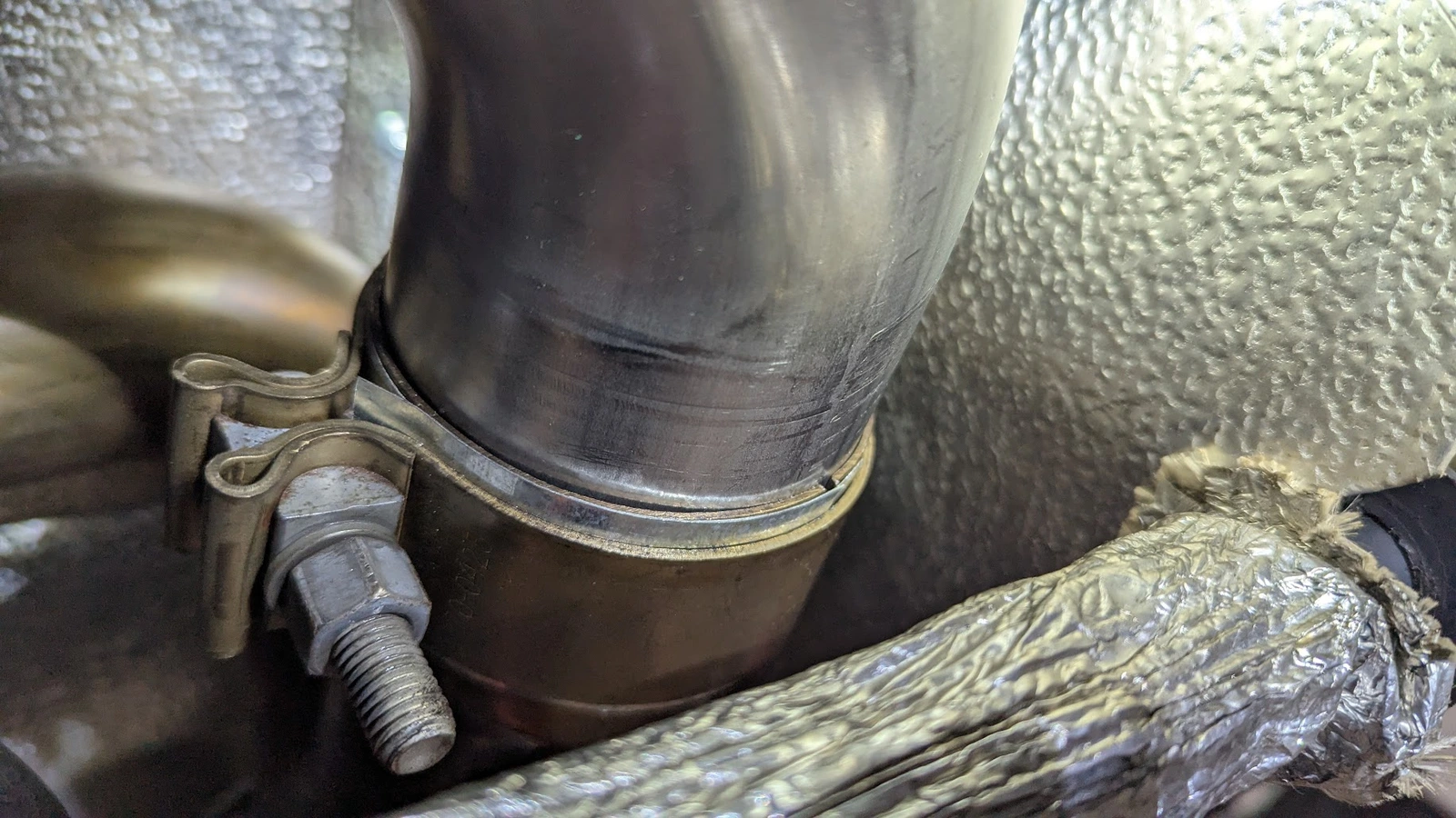

Good to know that's an option! I expanded my decat pipe and then upgraded to the GRP Ti exhaust without any issues. The only issue with the factory muffler is that the clamp is welded on and is limited in its clamping diameter. The GRP Ti exhaust comes with a really nice clamp that isn't fixed to the pipe and has no issues with sealing the muffler to a wider range of diameters.
Thank you for your feedback. That's great to know.
Correct! The stock clamp is welded and has a spacer between the bolt and the nut, limiting how much it can clamp. The best thing to do is to have a muffler shop expand the decat pipe to 3" and then use a hand expander to gently open up the inlet pipe on the muffler. That allows the newly expanded decat pipe to slide in and then be securely clamped.
I made several 1.5" x 2" shims out of HVAC duct material and slid them between the band of the clamp and the pipe to get around the problem. Gives the clamp bolt enough travel to snug things up nicely.

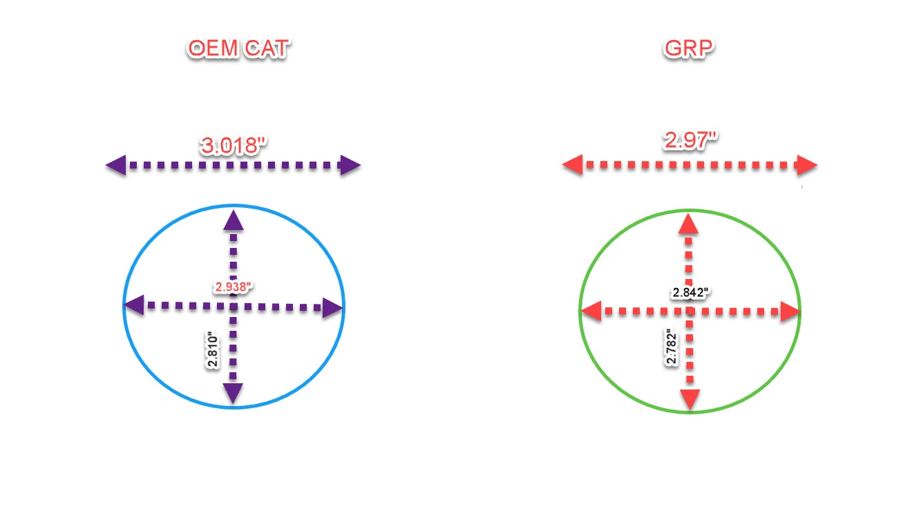

I tried installing the 3rd cat delete tonight but failed. The OEM Y pipe flange where the 3rd cat delete flange would not sit flush properly. Upon further inspection, the inside of the 3rd cat delete (flange side isn't perfectly round so it wasn't sitting flush no matter how much I tried shimmy it into place. I do not have a die grinder or a dremel to fix the problem. I messaged Greg to see if he can send another one out. Also, the pipe was noticeable smaller and fit really loose on the exhaust side. IMO, there should be more QA done before shipping these 3rd cat delete. This install caused me a lot of frustration and wasted time.
Below is a picture of the measurement I did before using the exhaust pipe expander.
The material you used, was it from one of those flexible accordion-style connecting tubes or straight galvanized steel/aluminum pieces? I'm guessing it was the later.
For those that have done this, what replacement bolts are needed if OEMs corroded and not being reused please - its says 3 x 16mm and 1 x 15mm in video... Thanks
Just standard heating duct sheet metal - available at Home Depot, etc.
