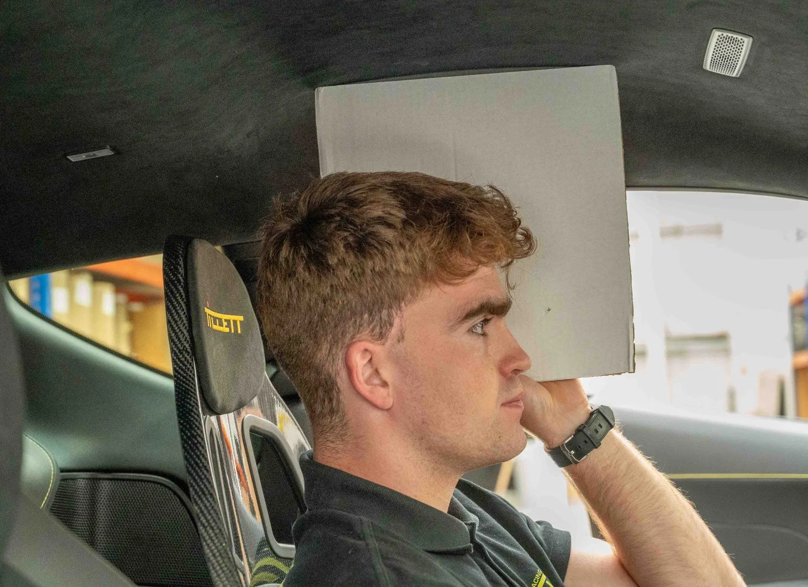

Can you say if the seats sit you noticeably lower in the car?
The picture below showing us testing the B5 has another inch under the Tillett seat that could be still used. The Emira seat is maxed out in this picture. The B6 and B10 shapes will go lower than the B5.

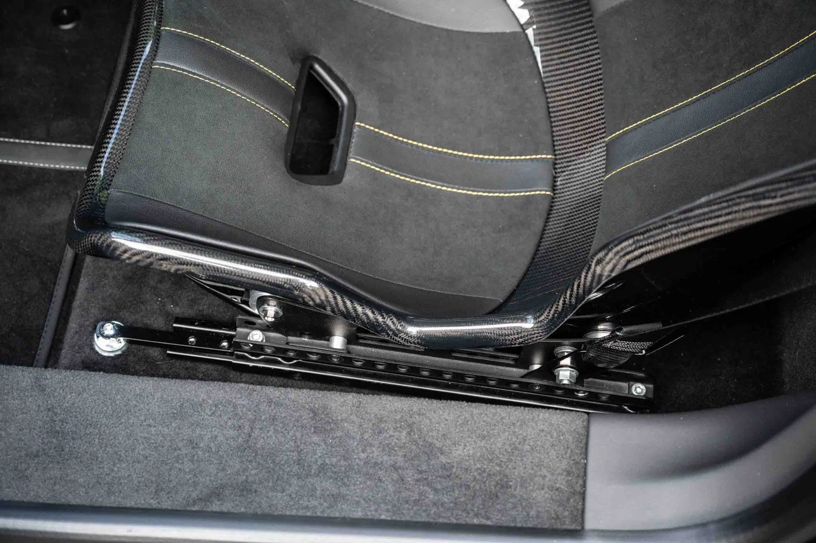

Many thanks! That's great info. Do you plan on making a bracket specific to the Emira that is a bolt-in item?
Yes, the test ones are coming next week.
I already fitted them successfully using a modified Elise/Exige bracket and our PTRO runners.

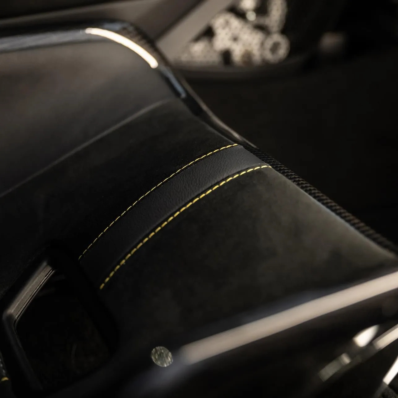

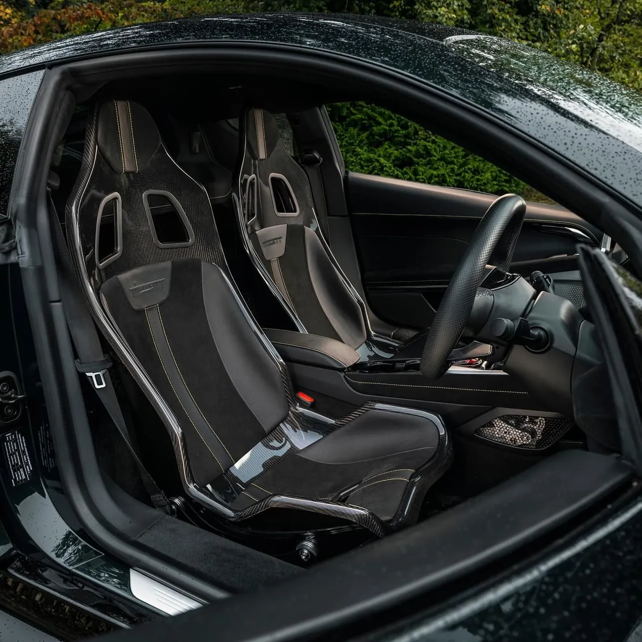

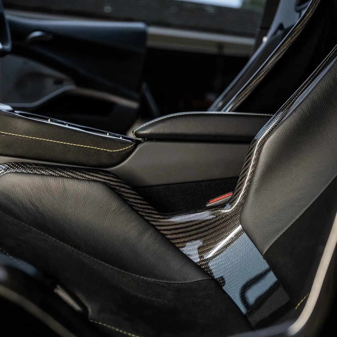

If I hadnt already got my Emira I'd be all over this. Looks like they've done a real good job with trimming the seats too:
