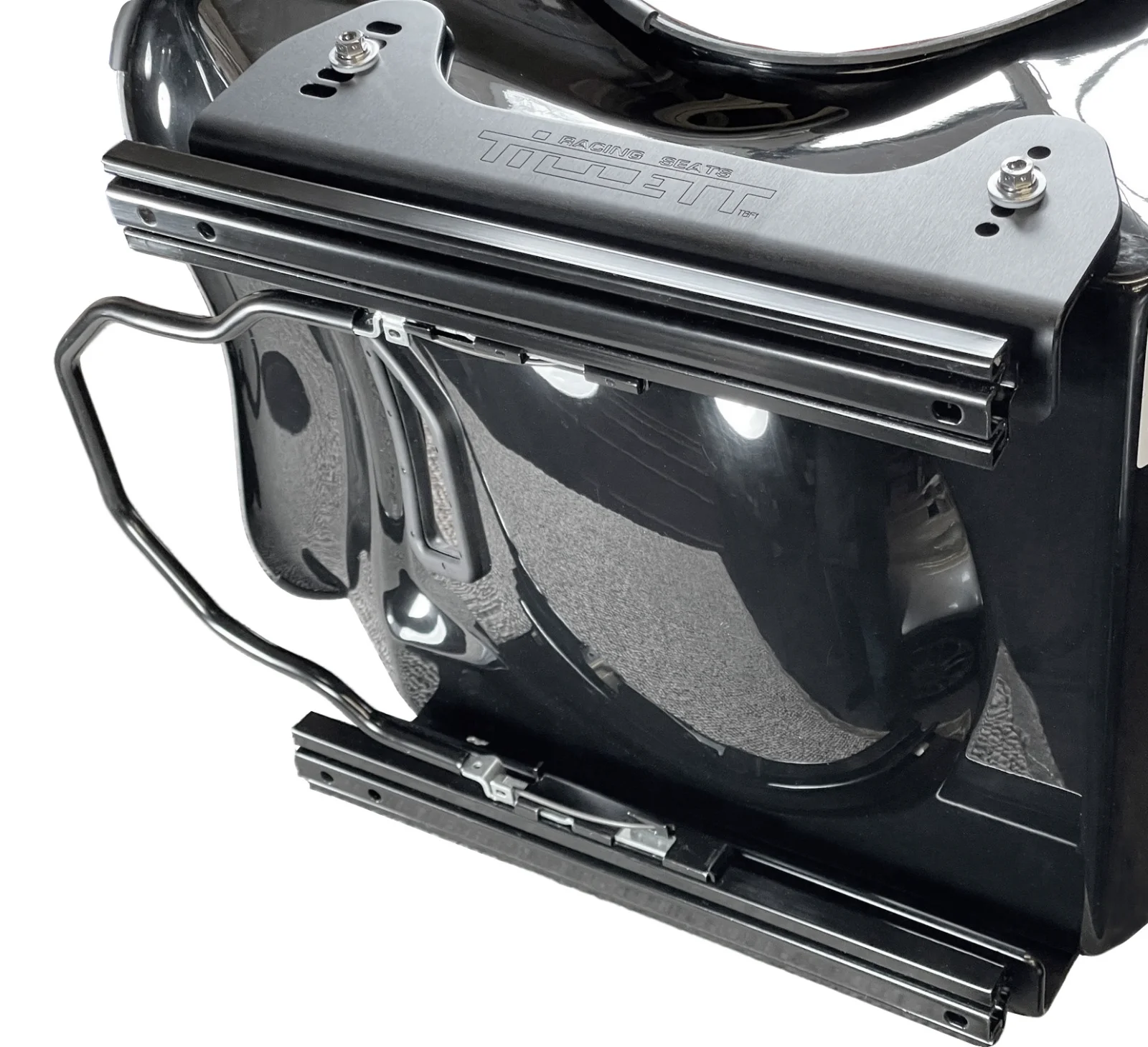

@Steve Tillett What is the deal with the slider handle? I may attempt to drill a hole in it and put a cotter pin through. It pops off almost every time I pull it. Am I missing something?
You have not pushed them right in. I can see from the video that they are only half way. Tap them with a rubber hammer until they fully push that spring in.
Yeah I had one side of my handles jam because I didn’t insert them evenly, and eventually I was stuck with a handle that would come out when I pulled on it.
I’d recommend removing them, then seating them with a rubber mallet evenly alternating each side until the spring fully seats.
It’s perfect now!
See here how far they are pushed in.

This is helpful, so I've been seating them down to the horizontal "wire." This image makes it appear as though it should go over or "bend" that wire within the handle to add pressure to the lever? Does that add up?
Yes, the wire is what locks the handle on.
