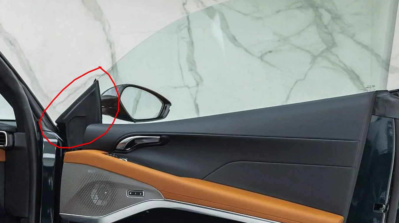

For anyone with OP's issue, request your dealership to replicate by using a pressure washer near the mirrors. The weatherstrip is not the issue, the problem is caused by a bad seal on the mirror assembly. The seal is attached to the mirror assembly, so they have to replace the whole thing.
Did you do this and it fixed the pressure washer issue? How big is the job?
