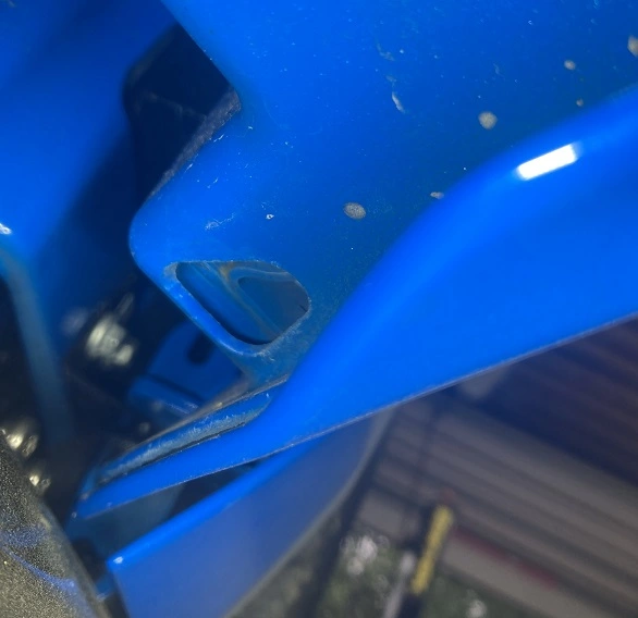

I looked at my doors to confirm where the drain holes are. Mine are there in the drain spot shown in the first video at the very front of the door. The appears to be slightly curved to this low point. On mine it looked like they would drain whether the door is open or not but opening it may make the water slosh forward and drain more.
My car is a late dec23 build if those were added at some point.
I have exactly the same drain hole cut out. Mine was built June 23. When I wash the car water does drip out of the front with the door closed. I wonder if earlier doors have this cut out & whether this identifies the modified doors ?
