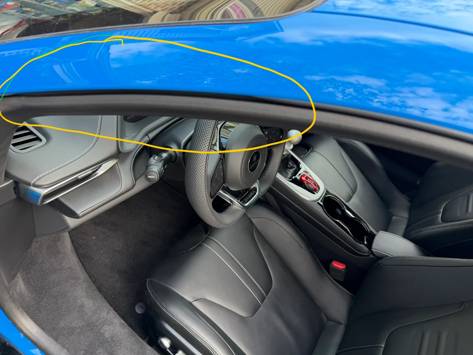

I’ve noticed this when it rains or when I wash my car on the drivers side only. Inspected the seal and note it is tucked in allowing water inside, no issues on passenger side. Is this something that can be fixed by the dealer?

I doubt it's damaged given how new the car is. The rubber seal probably got twisted/misaligned in that small section squeezed in when the window was closed. I believe, but not sure, that those rubber seal channels are merely wedged into the frame with pressure (not glued), so you should be able to pull out the seal only in the section where it's misaligned and the place your index finger inside the channel starting from one of the two edges where the strip is in place correctly and trace around placing upward pressure so that it wedges back in to the groove correctly. Once you've done this, try opening and closing the window with the door closed to ensure that the seal stays in place. If not, then have the dealer fix it. Hope this helps.

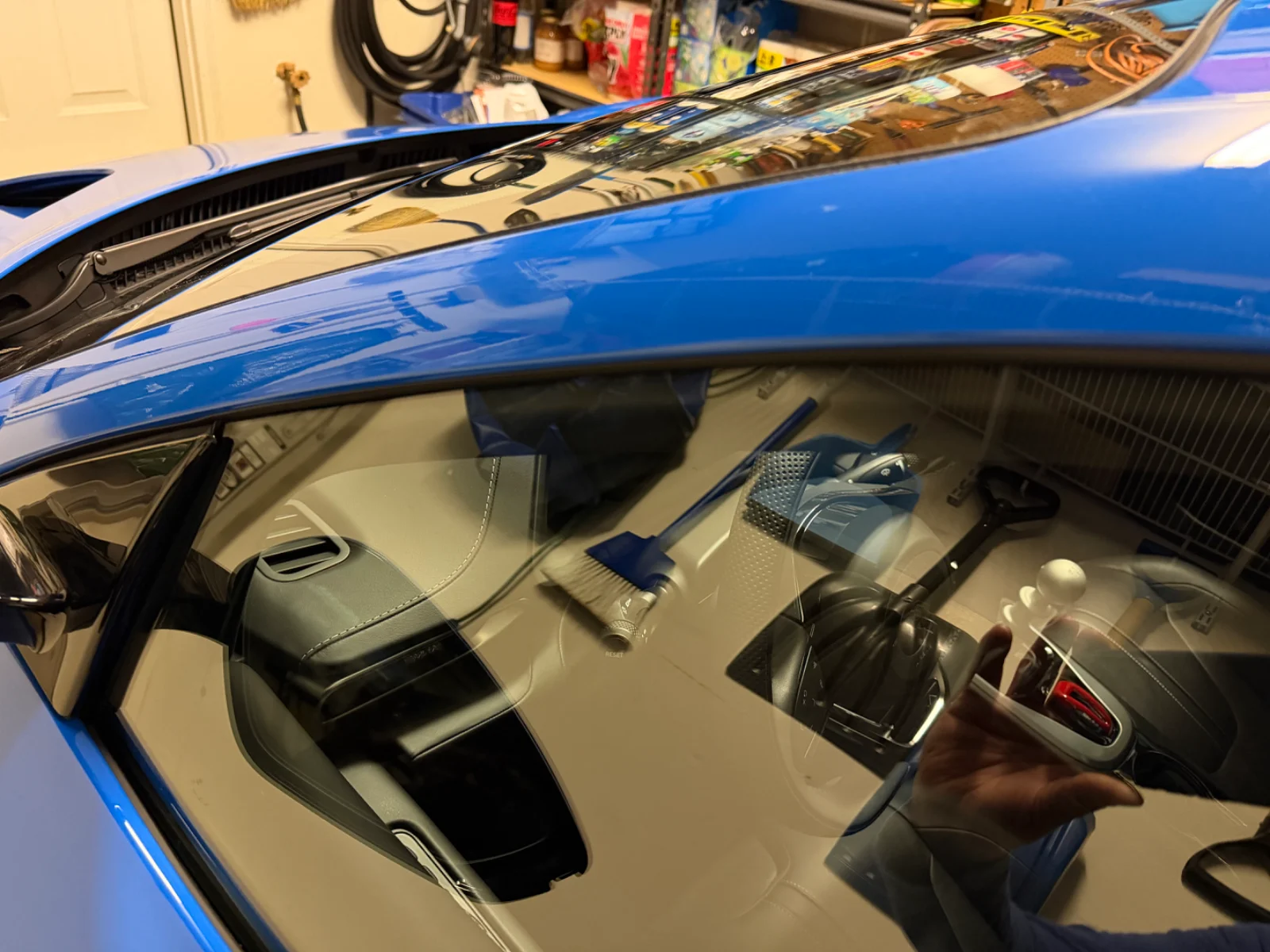

I had a similar tucked seal on my driver’s side window. I was able to, very carefully, use my fingers and a thin plastic tool to gently pull it out and stretch it over the roof channel. I worked at it from each end of the tucked part, not from the center. Took a while but it worked.
