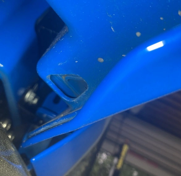

I looked at my doors to confirm where the drain holes are. Mine are there in the drain spot shown in the first video at the very front of the door. The appears to be slightly curved to this low point. On mine it looked like they would drain whether the door is open or not but opening it may make the water slosh forward and drain more.
My car is a late dec23 build if those were added at some point.

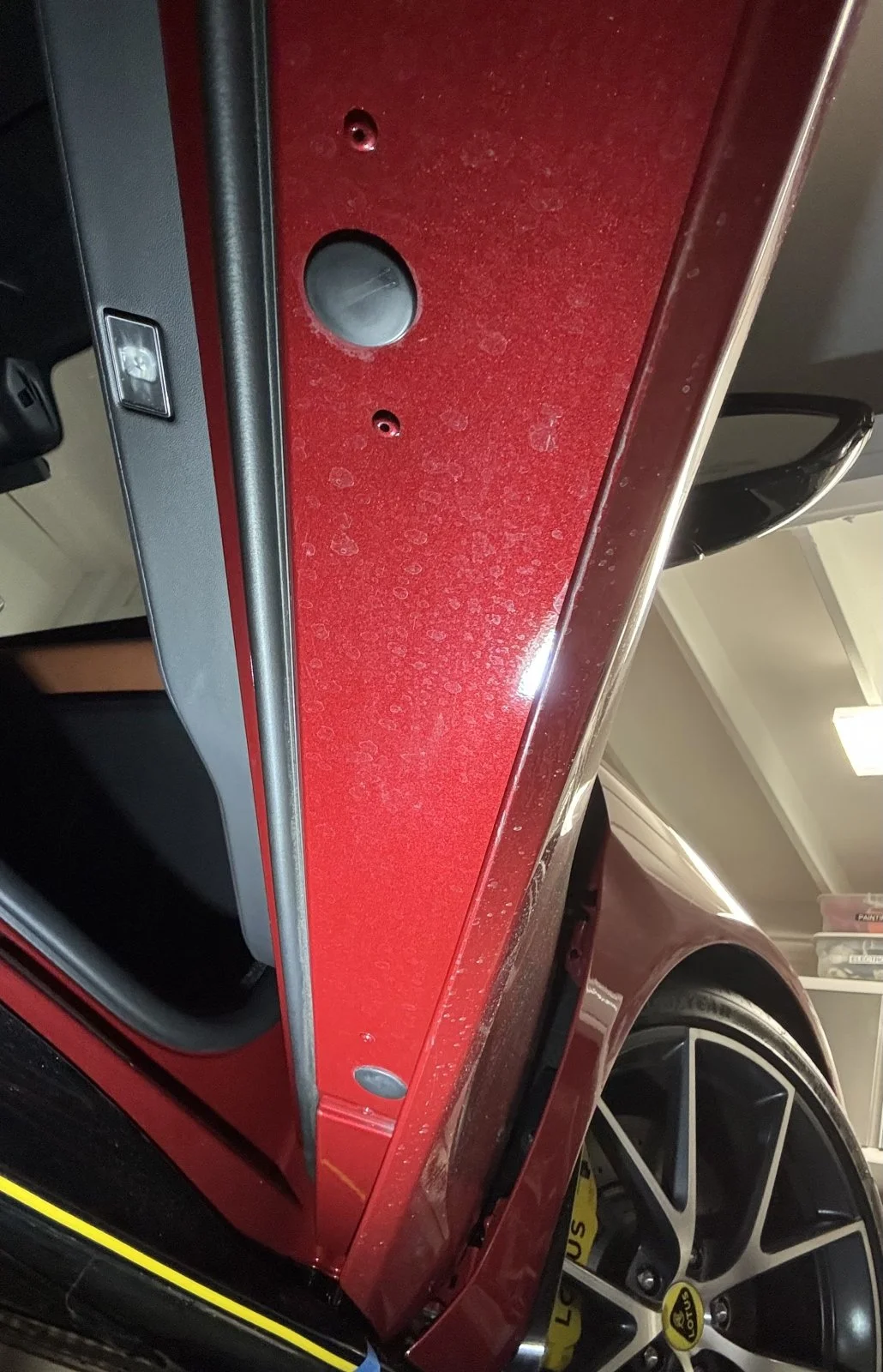

Wow, I checked the bottom of my doors and they don't have that drain cavity. Instead, my doors have a couple of grommet plugs as shown in the picture. I never had the issue of water accumulation in my doors nor have I ever had water draining out when opening the doors which is something I would definitely notice on my garage floor, if they did. I don't have a paint blistering problem either. I pulled out one of the grommets to double check and it was bone dry inside and it did rain here in the last two days. Admittedly, I live in the most flat state, so I can't recall having ever parked in any significant incline during a rainy day. Nevertheless, our tropical rains here in South Florida are like bucket downpours, and my Emira has been exposed to at least a couple of big ones, so I imagine if my doors had a sealing issue, as is the unfortunate case with others here, I would have noticed it by now. Since your doors' bottom section are different, maybe they were indeed re-designed to address the problem, potentially along with other hidden sealing modifications, but I remain confused because my built date was just prior to yours (November 2023). Go figure...
Wow, I checked the bottom of my doors and they don't have that drain cavity. Instead, my doors have a couple of grommet plugs as shown in the picture. I never had the issue of water accumulation in my doors nor have I ever had water draining out when opening the doors which is something I would definitely notice on my garage floor, if they did. I don't have a paint blistering problem either. I pulled out one of the grommets to double check and it was bone dry inside and it did rain here in the last two days. Admittedly, I live in the most flat state, so I can't recall having ever parked in any significant incline during a rainy day. Nevertheless, our tropical rains here in South Florida are like bucket downpours, and my Emira has been exposed to at least a couple of big ones, so I imagine if my doors had a sealing issue, as is the unfortunate case with others here, I would have noticed it by now. Since your doors' bottom section are different, maybe they were indeed re-designed to address the problem, potentially along with other hidden sealing modifications, but I remain confused because my built date was just prior to yours (November 2023). Go figure...View attachment 52582
I also have the 2 grommets and the drain hole (build June 23). So surprised you do not have the cut out near the hinge section.
I have noticed when it rains or I wash the car on the level water drips from the hinge area of the door with the door closed. No way do I get a flood of water when opening the door.
I looked under my car and had this same cut out as this pic (plus 2 grommets near the other end of the door). Does anyone have a different drain hole or no drain hole at all?
