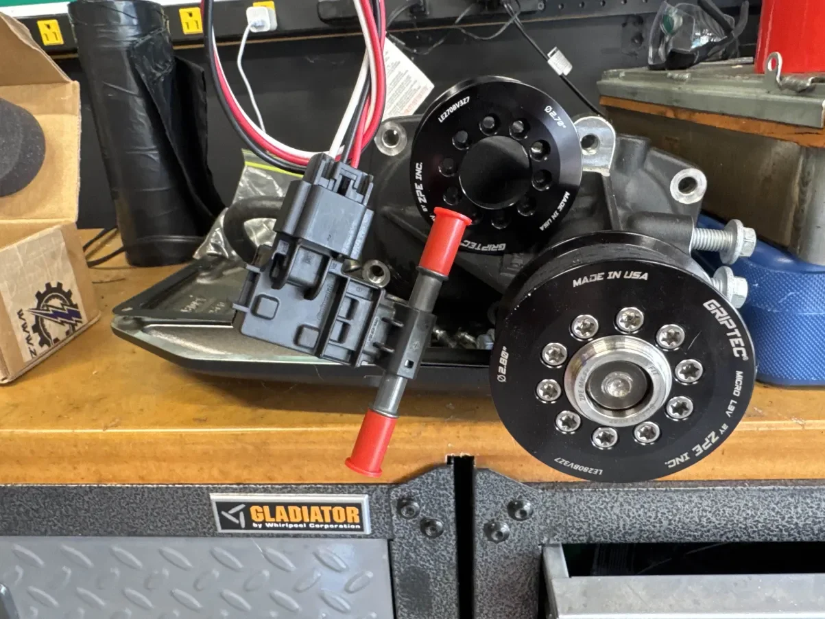

~3psi more boost at 2.8"
Personally I'd get the 10 bolt version that requires a hub as well as you're significantly increasing the spin rate. Lower size than 2.8" requires going through Jokerz (they have a deal with ZPE). This is useful at higher altitudes or if you want to do a bigger build.
Here's my 2.8 and 2.7 currently disassembled.
Thank you again.
Would this require any ecu tuning to make work?
Would we expect JB4 to work with smaller pulley?

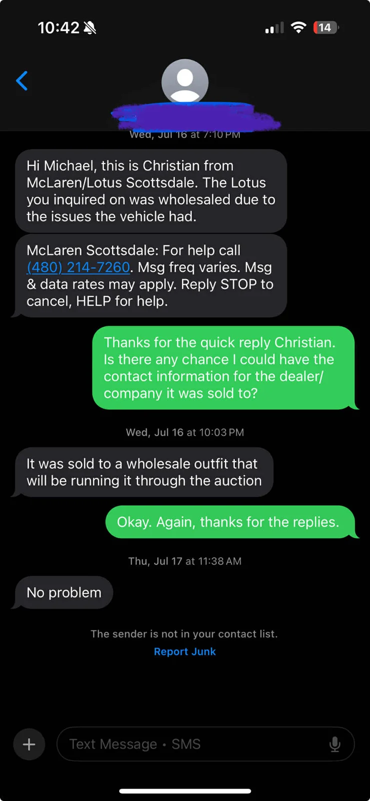

  • Spero's Emira with a completely fucked JUBU engine they built improperly is chronicled on facebook and discord, first hand emails, actual data logs from the syvecs ecu they claimed would fix things, etc. SCCLEKAX2RHB13390
    Here's me reaching out to the dealer he originally bought it from and eventually traded back into saying they wouldn't/couldn't even fix it, (I was hoping to buy it and fix myself).

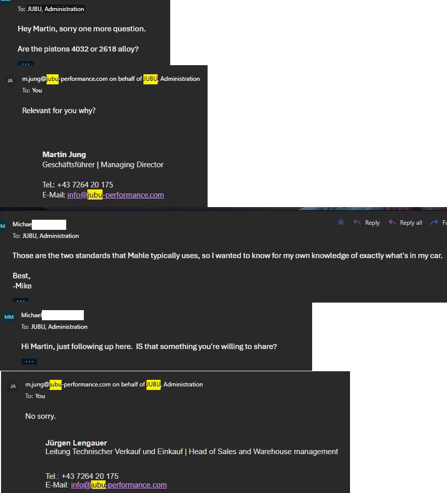

  • Here's my most recent interaction with Martin though. I went to Mahle directly and got my answer. I have many more dating back years with Martin avoiding questions, support, etc.

11) As far as Martin Jung's response to you or the person with the bad engine, wasn't the most professional response. Not something I like to see... However, that could have been advised by an attorney.. and it doesn't necessarily mean an admission of guilt. On top of that, I'm not seeing that projecting across the organization in terms of how customers are being treated.
Martin’s response there is brutal. He won’t divulge the material of the parts he sold, that he doesn’t even make. There’s no way he had an NDA w the manufacturer.
It’s one thing to mark up a product and sell it w flowery words for whatever price the market will bear. Fine. Capitalism.
But to then refuse to be transparent about the specs of said part, idk man.
Not great
