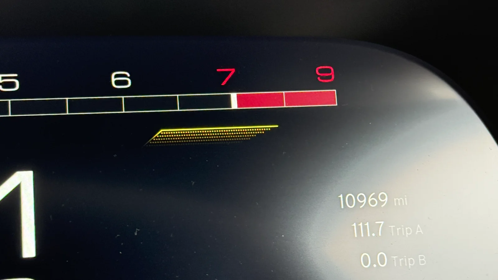

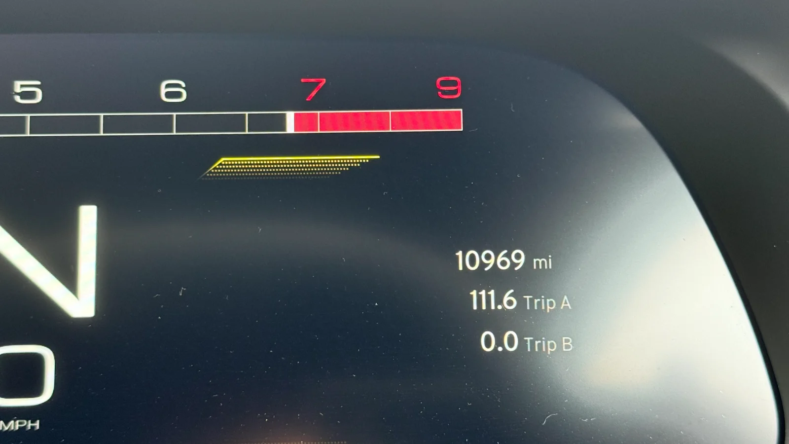

I’m not a scientist, but it seems like one way to prove the jubu car changes redline would be to post a photo….
Here you go, 1 photo with stock ecu, one with Syvecs.
So it does indeed show 7000, and not 7200, so apologies to TFS, but there's definitely a change from 6800.
So it does indeed show 7000, and not 7200, but deff a change from 6800.
Yea and as discussed you can take it past that 7k visual redline to 7200. And choose a soft limiter which I have as well.
Actually, I've only just noticed that the spacing of the numbers changes from the 7k mark onwards (RPM per MM halves), so not linear.
So taking that into account, if you look carefully, the start of the red ribbon, is actually at about the 7200rpm mark.
The width of the leading white bit of the ribbon must be pretty close to 200rpm's worth in that more bunched up part of the rpm range.
Below 7k, 1000rpm is represented by two divisions, after 7k, that same lengthed two divisions represents 2000rpm.
It's a quirk of the instrument layout.... It's not linear at the top end.
Actually, I've only just noticed that the spacing changes from the 7k mark (RPM per MM halves).
So if you look carefully, the start of the red ribbon, is actually at about the 7200 mark.
The width of the leading white bit of the ribbon must be pretty close to 200RPM's worth at that more bunched up range.
below 7k, 1000rpm is represented by two divisions, after 7k, that same two divisions represents 2000rpm.
I think your right…we been lookin for the white line but I think that line is gone and it’s actually at 7200 rpm.
So in that case I take it to 7200 than. You just solved the case lol!
So maybe I'm not a liar.
