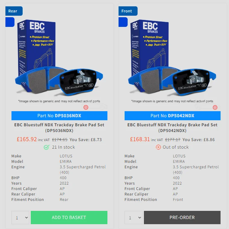

Thanks very much for getting this clarified. The BlueStuff sounds like what I'm looking for (and the price is right!), and just want to get a confirmation that I'm ordering the right number: DP5042NDX (front) and DP5036NDX (rear). Correct?
Sorry, no idea - but you seem to be correct from the web site. Might be easiest to buy them from GRP (here on this website) to be sure you get the right ones - their prices seem to be competitive I think.
